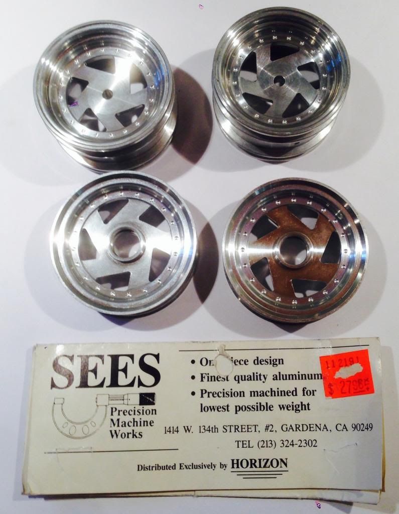

Shodog 1834 Posted November 17, 2014 I have a new set of see's aluminum wheels for Falcon and Striker. I'm asking $125 for them Share this post Link to post Share on other sites
TamiyaVancouver 5 Posted November 18, 2014 Very nice, but kind of like putting lipstick on a pig. Thanks though. 1 Share this post Link to post Share on other sites
