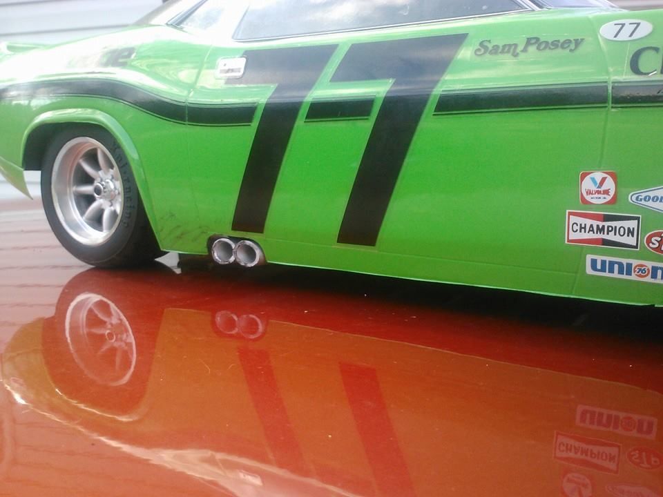

Welcome I have the same kit - though I built mine to be a racer - I like you can't stand a sloppy drive train so I did the same as you!
Here's mine -
Sam Posey No.77 1970 Dodge Challenger Trans AM race replica - built to VTARC 2S brushless rules
3D exhausts just like the real car -
PS if you mess up on the Ferrari body let me know I have mine brand new still I will get rid of CHEAP
