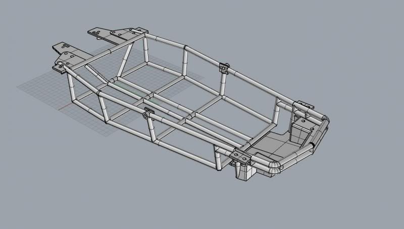

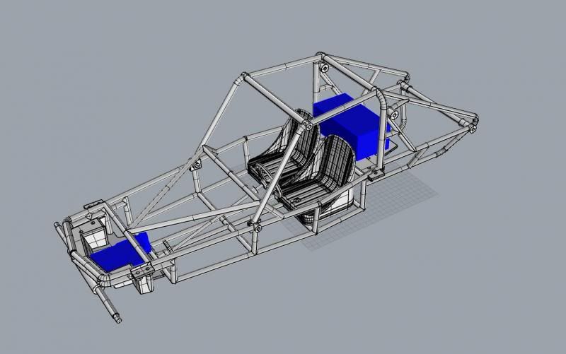

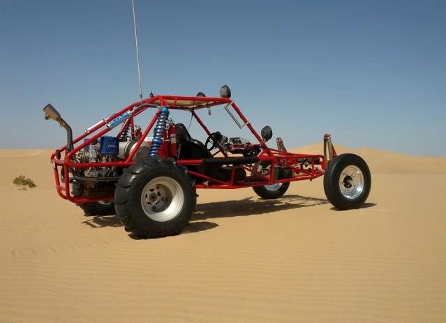

Toykid 595 Posted December 30, 2013 So I wasn't sure where to put this build thread as it could go in the Re-Re or Vintage section. Mods please move if you think it better suited somewhere else. The next project on the cards for me is a Chenowth Sand Rail. The inspiration for this project came from Kevin Jowett and Wrencher (Chris) over on ScaleBuildersGuild.com (SBG). Kevin and Chris teamed up to create what has to be the best scale Sand Rail to date. Based on the SRB chassis it was so awesome I talked Chris into making me one with a few tweaks so I could make a replica too. Kevin challenged me to not just copy Chris' hard work and just make a 3D printed copy for my next project, but to do something original. I took up that challenge and couldn't be happier with the results so far. For this project I really wanted to focus on getting it as scale as possible but also living up to the original design philosophy of sand rails and create something that was fun to drive and cheap to build. The first decision to use the Wild One / Fast Attack Vehicle (FAV) was based on it having both trailing arm suspension at the rear and the donor kit being half the cost of a re-re SRB chassis, Sand Scorcher. However I would have 2 big issues to contend with: 1. Whilst the front arms are of a trailing type, they aren't as scale as the SRB front suspension 2. The standard rear gearbox can be, lets say, a little unreliable. I had an original Wild One back in the day and I still have an original runner today. They are great fun to drive once you have the gearbox sorted. What is really great about the FAV is it is actually based on a real Chenowth sand rail. Looking at real reference you can see Tamiya did a great job replicating the rear cage almost exactly. It would also mean that if I could utilize that cage in my design, then the cost of the 3D printed cage part is quite literally, cut in half. I am also super excited about those trailing rear arms, very close to how the real 1:1 design. Here is what I am going for: So I started first on replacing the lower chassis with one created in tubes of the same Dia of the tamiya rear cage. After a few late nights I got to the point where I can combine the lower cage with Tamiya's part. Now it is really starting to look like something. You can just see that the steering servo is now in a new location and will require a micro servo to hide it away between the front suspension. The seats are actually hollow allowing for a small ESC and receiver to be located and that blue blob above the seats will be where the mini LiPo sits. I understand how some feel about LiPo's so I am also going to try a version with a full size 7.2 battery pack where the seats are. This will end up looking more like the Kyosho Javelin, nowhere near as scale but would tick the "cheap to build" box better. Kyosho Javelin where you can see the battery sticking out - Still awesome though Image of design in CAD showing placement of main parts If you want to subscribe to this Thread or like my Facebook page to get regular updates, please do so https://www.facebook.com/knight.customs.RC?ref=hl 3 Share this post Link to post Share on other sites
