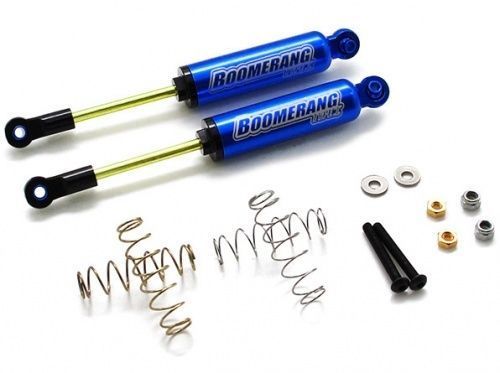

I have boomerang on my WT-02 and found them to need work to work correctly. You can oil fill them but they have no top cap or diaphragm so are not as good as CVA types. The pistons were poorly made and needed work to finish.
They do look cool though and in double shock configuration should just about hold up Clod weight.
Thanks Nobbi, you have just made the decision a lot easier for me. If I'm buying a brand new product I expect it to work correctly straight out of the box <_<
