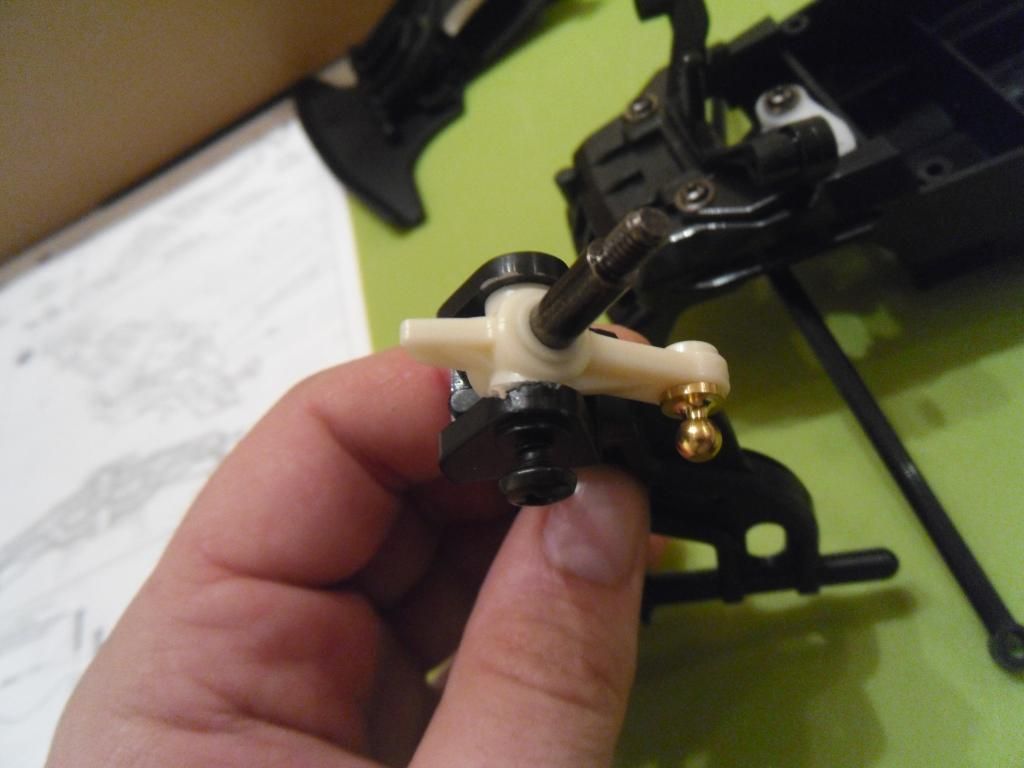

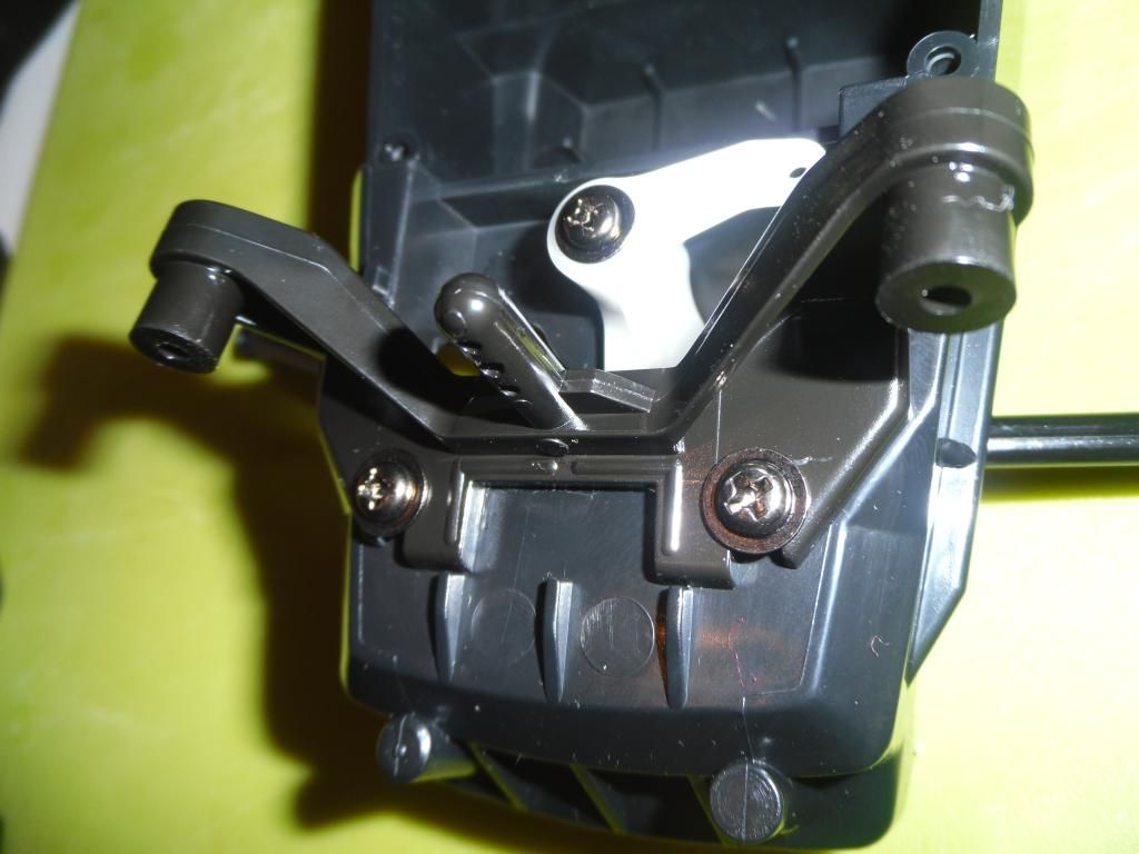

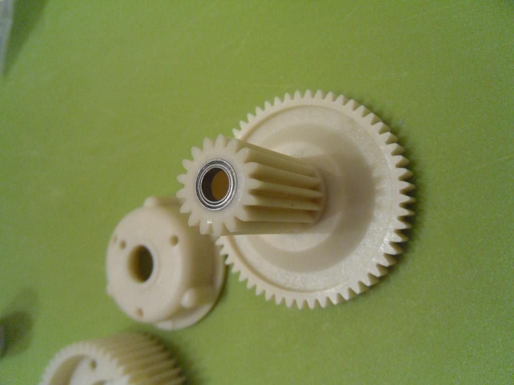

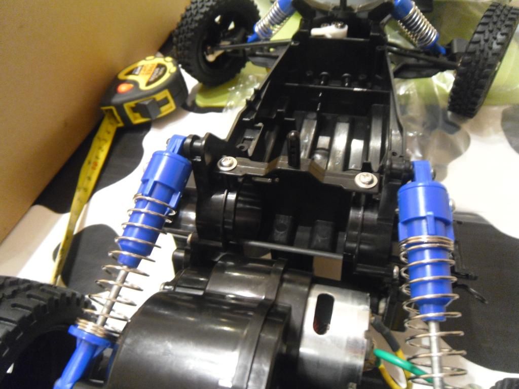

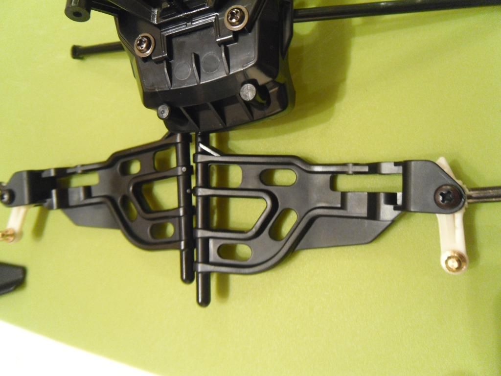

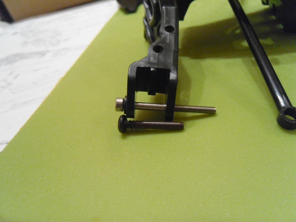

Nobbi1977 1793 Posted November 21, 2014 This is my first scratch build. I have a Hornet that I have been playing with and thought it would be good to build a chassis to get a better feel for the hobby. I have built race bikes and restored classic bikes so my hands on experience so far is all 1:1 Why Bull Fighter? I ordered a Mad Fighter chassis (well two, the postage made it like getting the second half price) and a Mad Bull body. Hence Bull Fighter. I will be running Carson wheels. They are cheap and a good compromise between buggy and truck wheels. INSERT BOX PIC HERE I forgot to get my garage camera in so missed the first couple of shots Steering arms in place Shock tower fitted. Not happy with the dodgy way steering arms are held on so I think I will replace with cut down M3 bolts and lock nuts Fitted for now. Want to do it buy the book at least once Lower arms ready to go Fitted, lots of play though. Guess that is why there are more expensive kits out there. All connected up. A lot better than the Hornet set up. Shocks built. They are at best poor, these will have to go very fast Ball bearings throughout. no point using the silly plastic things for the sake of a fiver One half of diff / axel Diff Parts. Was surprised to find alloy parts Though about adding a couple of O rings to tighten it up and so limited slip. There was not enough space but I am sure a couple of grub screws could be used to adjust it. Might get a spare to play with. Built ready to attach Motor in. Not sure what I will run in the end but this will do for now Spot the mistake Much better :-) Opps, missed the shock fitting bit. They are so poor i am amazed they can get away with supplying them, do they just do it to sell Hop-ups? Body and wheels trial fitted Rear body pin supplied is not correct so I need one to fit the body. No idea on colours or electrics yet. Need advice on best and cheapest Hopups now Share this post Link to post Share on other sites
kaylon 235 Posted November 21, 2014 Excellent build Thanks for sharing, want more! I totally agree about the friction shocks... I don't even build them anymore. I usually add an order of Absima Alloy Shocks from Fusion hobbies whenever I order a kit, at 9.99 a pair it's not much to add to an order and with the 10% discount from TamiyaClub it's not that painful on top of bearings... I've always loved the looks of the Madbull body and have considered getting one but the massive bump steer you get with them tractor tyres has always put me off... I'd be interested to know how you find this chassis once you run it. I've always also though that the rear geometry is way to laid back to be really any use...the lever point compared to shock angle is just to shallow and seems very inefficient... Perhaps some home made carbon fiber or alloy shock mount extensions would improve performance. K 1 Share this post Link to post Share on other sites
Nobbi1977 1793 Posted November 21, 2014 The shocks are not hideously expensive but are about the same as 1:1 car shocks and when you pay £28 for a chassis almost double the cost but I guess that is the fun with the hobby Bump steer will be an issue but not as much as the Hornet I think. I thought the same about the rear shocks, the friction ones lock up with side load under movement so I might look at a solution. I have a spare pair of Hornet rear oil shocks that look like the might slot on the front. Going to build my Dt-02 tomorrow then I will look at mods. Share this post Link to post Share on other sites

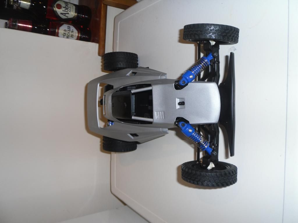

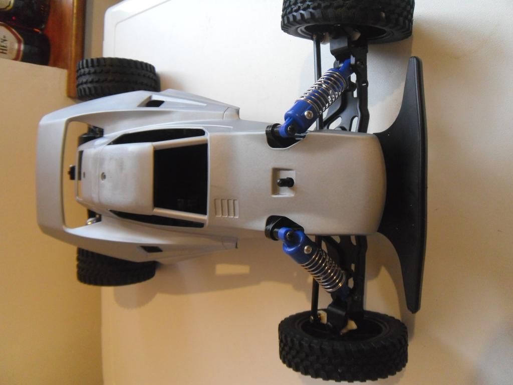

XV Pilot 1936 Posted November 22, 2014 If you'd like a Mad Bull sticker kit, I have a mostly unused one somewhere in my bits box that you can have if you like. As for hop-ups, the ones considered pretty much essential are bearings and a steel pinion, closely followed by oil shocks with proper ball-type fittings so that the suspension can articulate properly. On mine I also added a rebuildable ballraced 27t motor for a bit more power, and a pair of adjustable steering tie rods in order to set the toe-in. Some people also replace the wire steering link with a pair of ball links and a short turnbuckle to reduce slop. The DT01 is perhaps best enjoyed in relatively stock form. For one thing, it performs pretty well like this, and for another, the basic nature of the design is unlikely to have its performance changed much with additional hop-ups. Rather do the basics to the DT01, and save your hop-up budget for the DT02 and WT01. They both have many more interesting and worthwhile hop-ups available. 1 Share this post Link to post Share on other sites

i_am_scarecrow 912 Posted November 22, 2014 You can't beat a madbull! I run Absima shocks on mine front and rear and they work really well, I'd suggest grabbing a set. Will have a brushless set up in this by this time tomorrow, should be fun! Share this post Link to post Share on other sites

Nobbi1977 1793 Posted November 22, 2014 Also, do you have a link to those Carson wheels? I quite fancy a set myself! Love the two tone. Just masked up for much the same but in black on silver. Wheels are here http://tamico.de/Carson-Reifen-Felgen-Set-All-Terrain-schwarz-DT-01-DT-02-900027 You got a link for the shocks you used? Share this post Link to post Share on other sites
i_am_scarecrow 912 Posted November 22, 2014 I can't find the exact same shocks now but these Absima ones will work, not going to break the bank either. Front Rear Those wheels are cheap!!! Wish I spoke German, would be ordering a few sets just in case! 1 Share this post Link to post Share on other sites
Nobbi1977 1793 Posted November 22, 2014 I can't find the exact same shocks now but these Absima ones will work, not going to break the bank either. Front Rear Those wheels are cheap!!! Wish I spoke German, would be ordering a few sets just in case! Use Google translate in chrome. Works well. I speak no German and ordered quite a bit. Postage is a flat £11 ish so it pays to order a bit in one go. They post via dhl so it is tracked to your door Share this post Link to post Share on other sites
kontemax 1723 Posted November 22, 2014 Are them in aluminum? I read "plastic barrel" on ebay. Max I run Absima shocks on mine front and rear and they work really well, I'd suggest grabbing a set. Share this post Link to post Share on other sites
i_am_scarecrow 912 Posted November 22, 2014 You are right, they are plastic. I didn't spot that! The ones on mine are aluminium, I thought they were absima but now I'm thinking maybe Ansmann then. I paid the same price as the ones I linked too, there are lots on Ebay in those sizes. Share this post Link to post Share on other sites
XV Pilot 1936 Posted November 22, 2014 I think that reference to plastic is a typo on the EBay advert. The same shocks with the same part number are shown as alloy on Modelsport's website: http://www.modelsport.co.uk/absima-alu-dampers-75mm-1-10-2-/rc-car-products/369642 1 Share this post Link to post Share on other sites

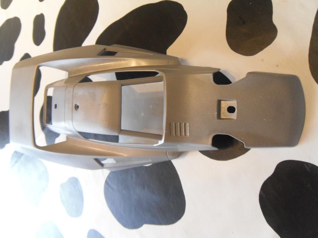

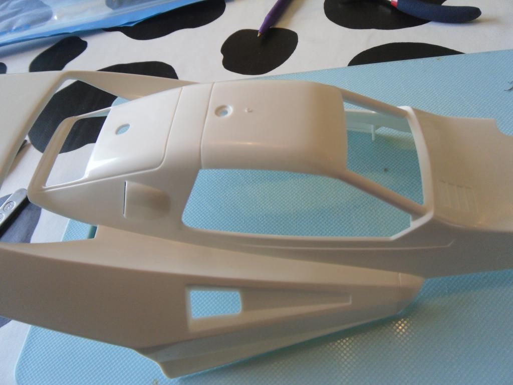

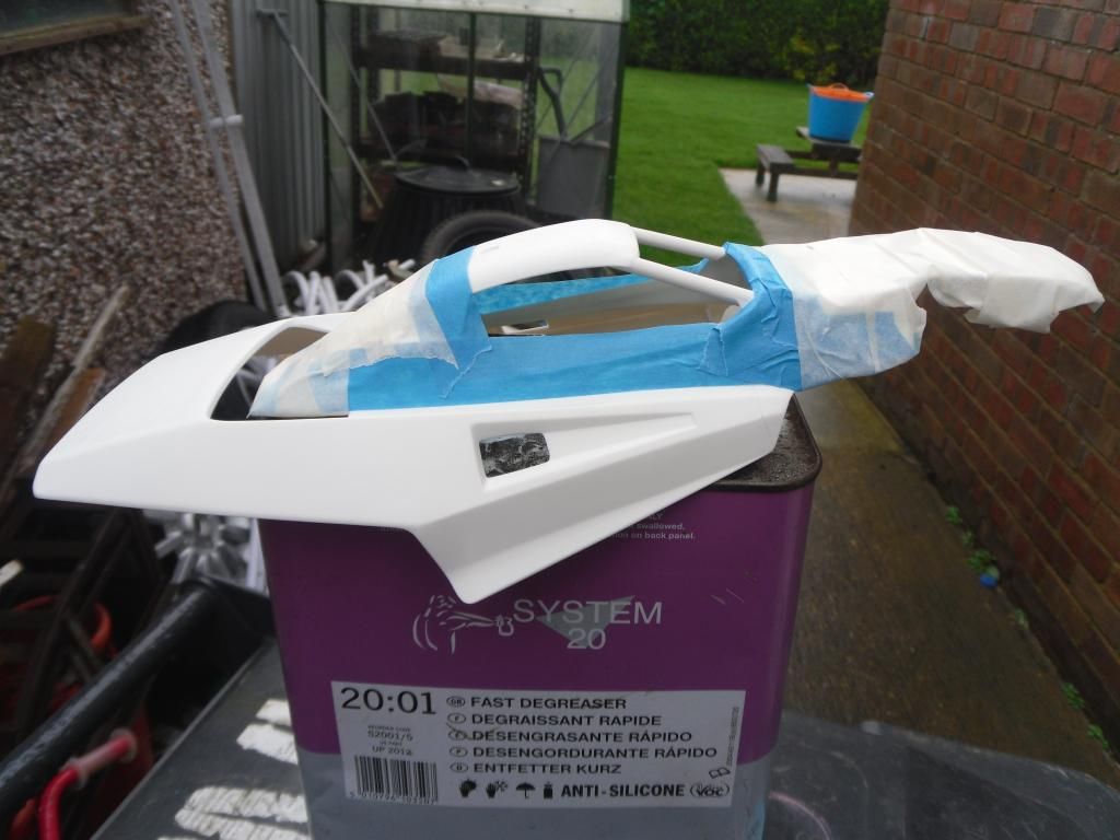

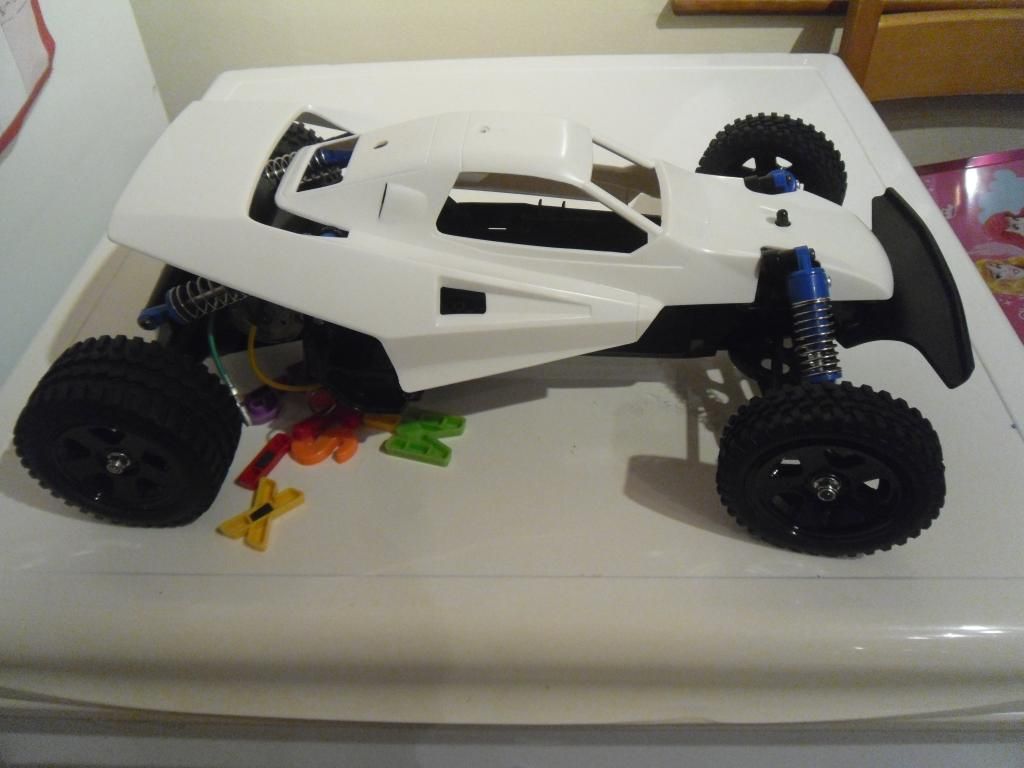

Nobbi1977 1793 Posted November 23, 2014 Time for a touch of paint while i wait for the body mount. Plain shell is not too bad but casting marks and sharp edges needed sanding First mask up before I changed my mind. Single tone. Alloy wheel silver (£1 a tin from poundland) Roof looks a bit shoddy where I had to sand it. Needs a bit of high build primer but instead I thought I would try something else Gloss black roof still showing marks but it will do for now, will need redoing the first time I flip it Share this post Link to post Share on other sites
waterbok 1282 Posted November 23, 2014 Interesting beer collection those Carson tires are quite Ok, the rims however are a bit brittle. I prefer putting just the tires on Tamiya rims, usually last longer. For dampers you could go for a Vintage look The Hicaps get mentioned in the rabbits manual. :D Like you idea with the M3 bolt as hinge pin replacement. 1 Share this post Link to post Share on other sites
