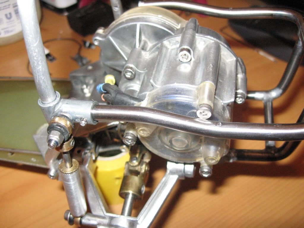

Percymon 2184 Posted August 30, 2014 I've no experience of these but the motor can looks to be the same one used by Hobbywing/EZrun.. http://www.ebay.co.uk/itm/HobbyFans-4-poles-10T-3930KV-Brushless-Motor-For-1-10-On-road-Drift-Racing-Car-/291183432043?pt=UK_ToysGames_RadioControlled_JN&hash=item43cbe2916b Another option is the Speed Passion 3500kv system from RCMart at $50 delivered - I have three of these (a pair in a mod Clod Buster and another in a Durango DEX210) - they go well, especially for the money. The good point about these is that the motor wires are on bullet type connectors pushed into the end bell of the motor so it'd be easy to use one or two of the exisitng wire hole in the plastic cover and just drill the third.. http://www.rcmart.com/speed-passion-reventon-s30s-brushless-wcompet-p-37495.html?cPath=1560_1301 a shot of one in my mod Clod so you can see the motor connections.. 1 Share this post Link to post Share on other sites
