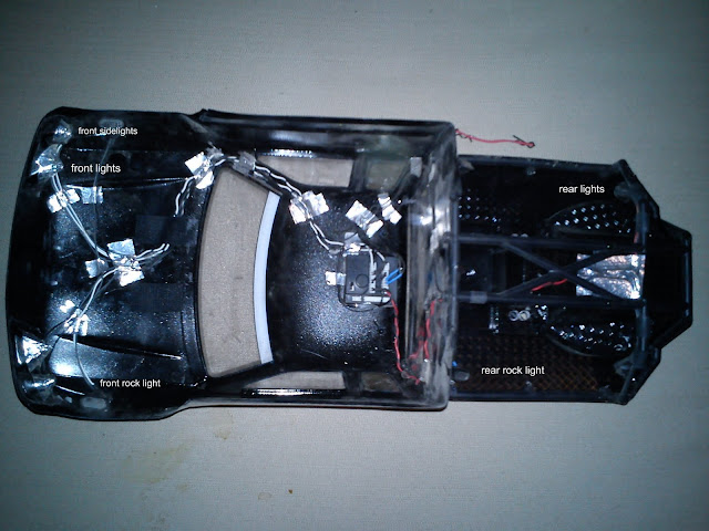

I use a glue gun to holds leds into place (with leds on, to make sure they all point where they should so that the headlights look realistic at night), and tape (either kapton tape or double sided tape _but_ used as single sided) to fix wires on the interior of the shell
