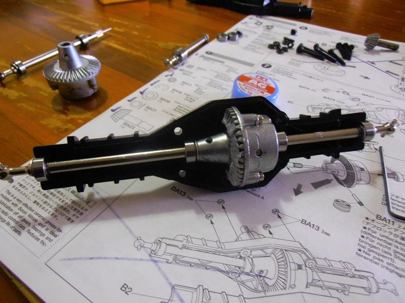

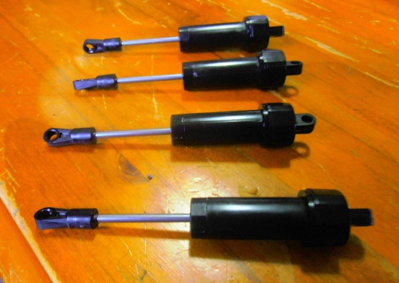

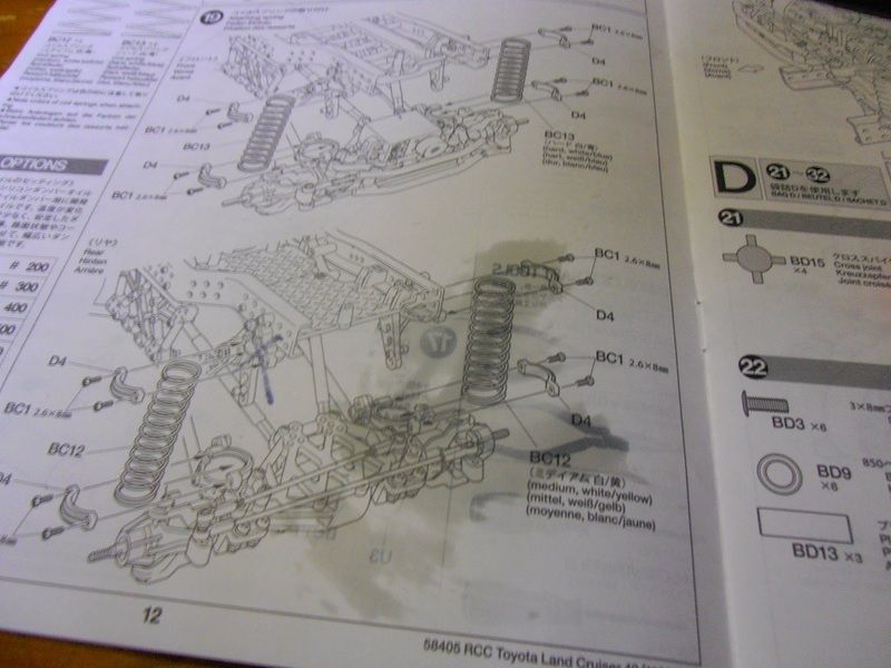

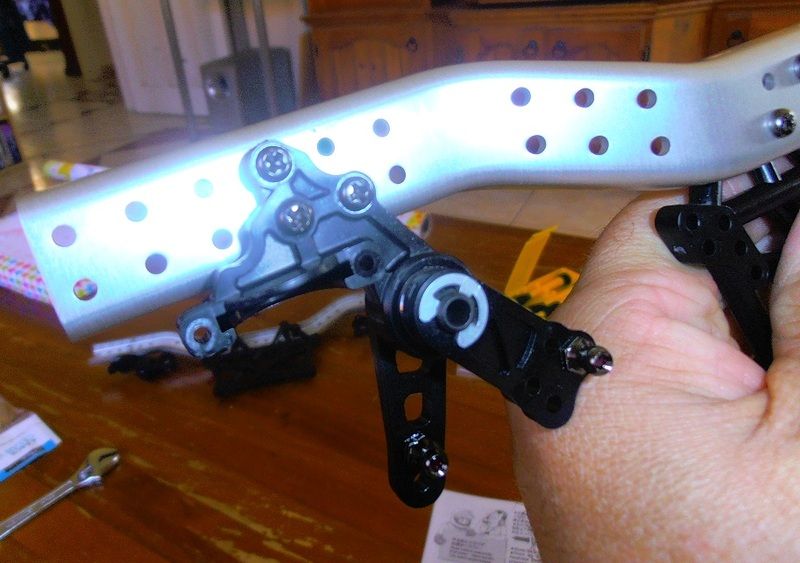

Green Meanie 59 Posted August 5, 2015 My first proper RC car other than the old Jet Hopper if anybody remembers them and an RTR 1/14th scale Avante 2001 Built Basically stock out of the Box I wont go through another entire build thread as there are already some fantastic ones on here but here is a few pics of my process. Apparently this is one of the most commonly mis-built parts and I myself too got it wrong and had to dismantle them again to correct it 1 Share this post Link to post Share on other sites

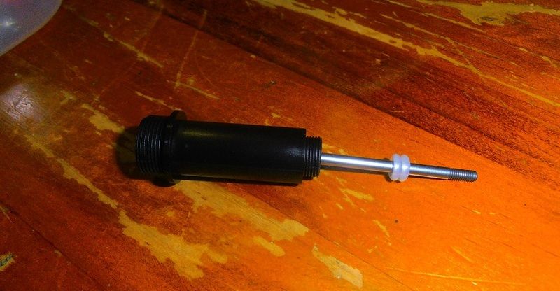

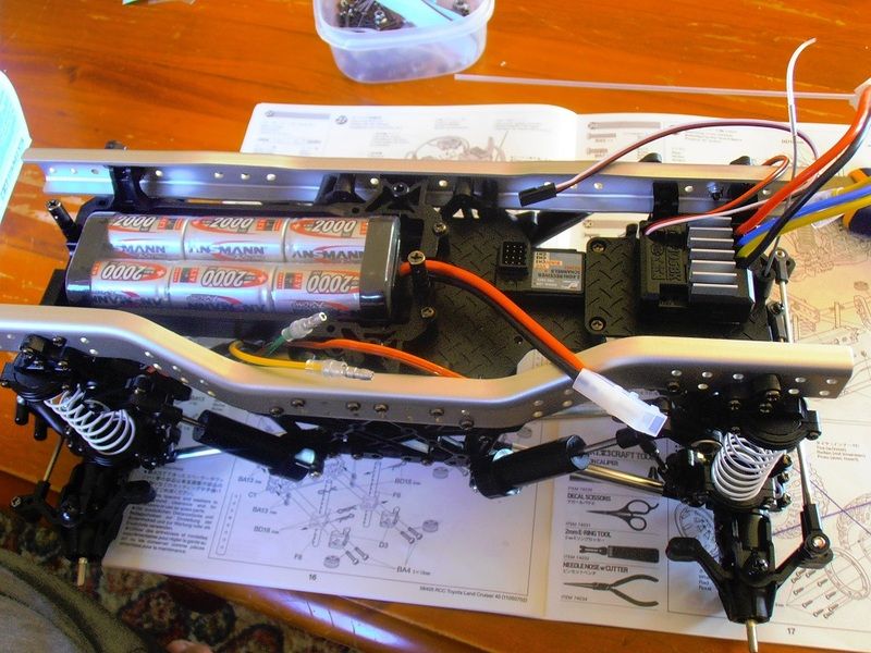

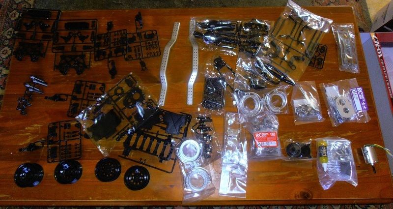

Green Meanie 59 Posted August 5, 2015 This is the important part!! I discovered this by reading a few forums before I began to build. Several people complained of the Dampers leaking and one common problem was the little O-Rings. A solution I read was to not install them first then push the piston rod through as it can tear them. Instead I installed the Piston rod into the main chamber first then carefully put the 2 O-Rings over the end before capping them in Oh yeah and when you are moving the piston up and down to remove the air bubbles do it SLOWLY otherwise it jets everywhere and this is the end result. Tamiya TEU-105BK ESC, Efly Reciever I think it is, came in box with my Controller The Fun Part............. My Chassis before any upgrades 1 Share this post Link to post Share on other sites

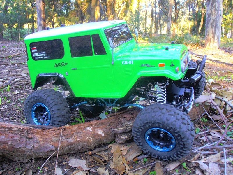

Green Meanie 59 Posted August 5, 2015 So here is a few pics of it on my First day out with it. 3 Share this post Link to post Share on other sites
Terz1 745 Posted August 5, 2015 Love it. Good job with the body work too. I love these scaler, go anywhere rc's. Just got one myself, great fun. 1 Share this post Link to post Share on other sites

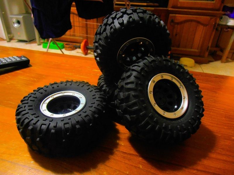

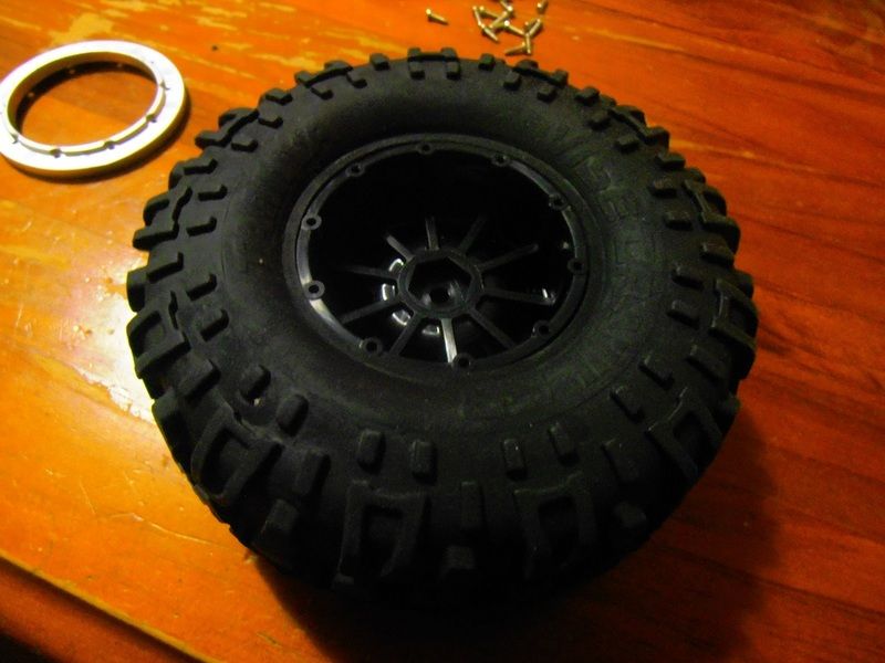

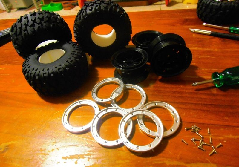

waterbok 1282 Posted August 5, 2015 Nice green, a Ninja CR01. Did you put some weight into the wheels? this will greatly inprove stability and climbing performance. Front (Rear has 310) Share this post Link to post Share on other sites
Green Meanie 59 Posted August 6, 2015 I've heard of people doing that via proper stick on weights or wrapping wire. One guy I know of uses Ball Bearings so that they rotate within the tyre and that way the weight is constantly at the bottom of the wheel and not trying to rotate and putting stress on the drivetrain Share this post Link to post Share on other sites
Green Meanie 59 Posted August 6, 2015 Front (Rear has 310) What is the size, Width of the Flat Irons compared to the standard wheels, I've heard the Flatiron are good but they look narrow and I like the width and stance of the standard tyres... Share this post Link to post Share on other sites

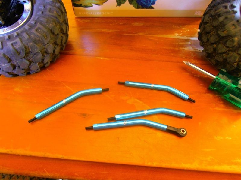

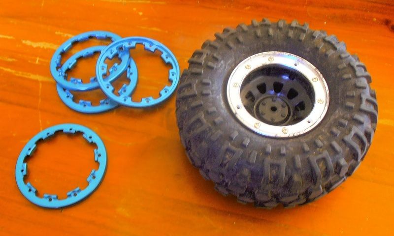

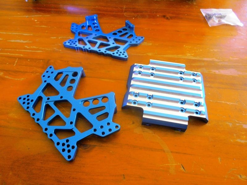

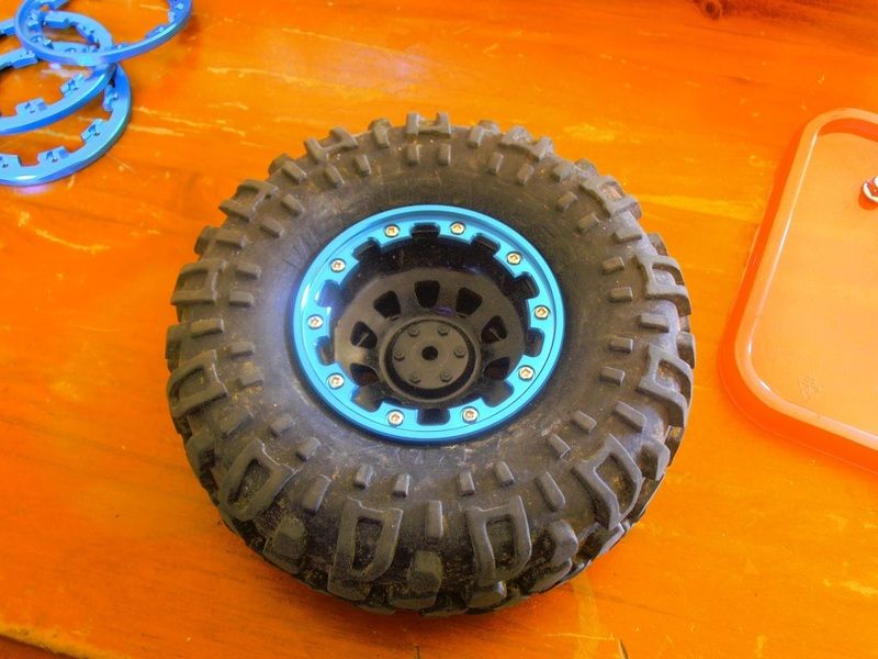

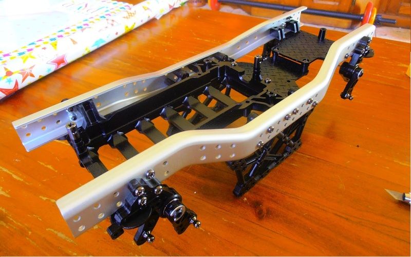

Green Meanie 59 Posted August 7, 2015 I recently decided to go on the hunt for some upgrades and Hop ups, either Tamiya or any other aftermarket brand mainly 3R I went to several RC Hobby stores and was met with nothing but Bewildered stares and replies such as "Huh?" "Man Nobody bothers upgrading Tamiya stuff especially a CR-01" "Why don't you just buy an Axial" "Say What Now......" The 5th shop I went to didn't have anything either and I was almost ready to leave when one Old Timer behind the counter said "Hang on man, Not many People upgrade them things so I think we may just have a bunch of old parts still in a box out back" He came back and popped a box up on the counter and told me to have a rummage through. He didn't have everything I wanted and I didn't want everything he had, But what I did grab he gave me at Half Price. This is my Chassis before any Upgrades were added The Parts I acquired My Chassis after the Upgrades Installed 2 Share this post Link to post Share on other sites

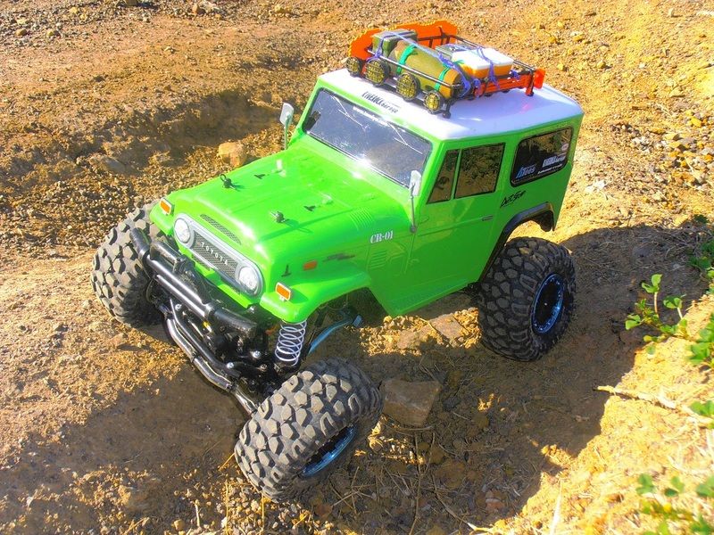

Green Meanie 59 Posted August 7, 2015 Then I went and took it out for a Spin at my Local Park Also made some changes to the Decals layout. Thanks to the Local Council dredging one of the ponds and putting in anti erosion rock barriers I now have my very own Rock Crawler course. 1 Share this post Link to post Share on other sites

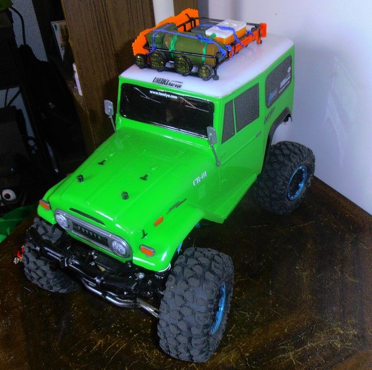

Green Meanie 59 Posted August 8, 2015 Wanted to add a Touch of realism and "Scale" styling to my rig so decided to make my own Imitation CB antenna for the Bullbar. I used a spare Antenna Pipe that was in the kit and wrapped it in PVC Insulation tape for colour then mounted it via a cable clip I had that near perfectly fitted the Bullbar, just a little glue to hold it secure and away we go. Looks a lot taller than it really is with some of the photo angles. In terms of "Scale" it would be about 1.5m which is 5ft and not unusual for a 4x4 CB Antenna to measure Share this post Link to post Share on other sites

Green Meanie 59 Posted August 13, 2015 Had some Boom Racing Scale accessories arrive from Asiatees, Roof Basket with lightbar and some tools etc. Still had more yet to come but couldn't resist getting out for a spin 1 Share this post Link to post Share on other sites

Green Meanie 59 Posted August 20, 2015 Finally got the last of my roofrack gear from Asiatees. And yep I hand tied those knots and Truckies Hitches using tweezers 1 Share this post Link to post Share on other sites
Terz1 745 Posted August 20, 2015 Looks great! I've just got some scale accessories. They really do finish them off nicely. 1 Share this post Link to post Share on other sites

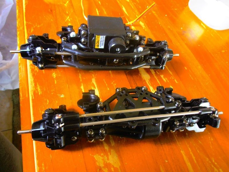

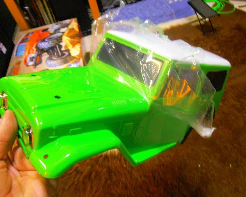

Green Meanie 59 Posted August 26, 2015 Next phase on the Green Meanie was converting to 4 wheel steering The Standard Locked out setup Dismantled The 4 wheel steer setup, I had to run the servo horn upside down because I couldn't get hold of a signal reverser for the rear servo Did the job though, albeit one or 2 times the servos have cut out on me While I was at it too I took to the body with a Sharpie and filled in the body Shut Lines. Makes it stand out a bit more realistically 2 Share this post Link to post Share on other sites
Nitomor 2122 Posted August 26, 2015 Nice to see it evolving, the sharpie lines make a difference and break up the sea of green nicely, definately looks more plausible. How much of a difference has the 4ws made? I'm looking to go the same route with switcheable 4ws (would use the Futaba FF7 remote I have for the Bruiser so lots of options there) Does the rear axle look like it it could take an axle guard as per the front one? Cheers Nito Share this post Link to post Share on other sites
Green Meanie 59 Posted August 29, 2015 Nice to see it evolving, the sharpie lines make a difference and break up the sea of green nicely, definately looks more plausible. How much of a difference has the 4ws made? I'm looking to go the same route with switcheable 4ws (would use the Futaba FF7 remote I have for the Bruiser so lots of options there) Does the rear axle look like it it could take an axle guard as per the front one? Cheers Nito It has massively increased its turning circle. BEST Mod I have done so far, Hands Down!!!! I will say this though, at higher speeds you have to watch your modulation on the steering as its now far more sensitive and easier to flip. Oh and yes you can quite easily add the Servo/Axle guard on, Your simply building a replica of the front axle, I just didn't have the extra parts to put one on but I can quite easily source that particular sprue I have a friend on the inside Share this post Link to post Share on other sites
