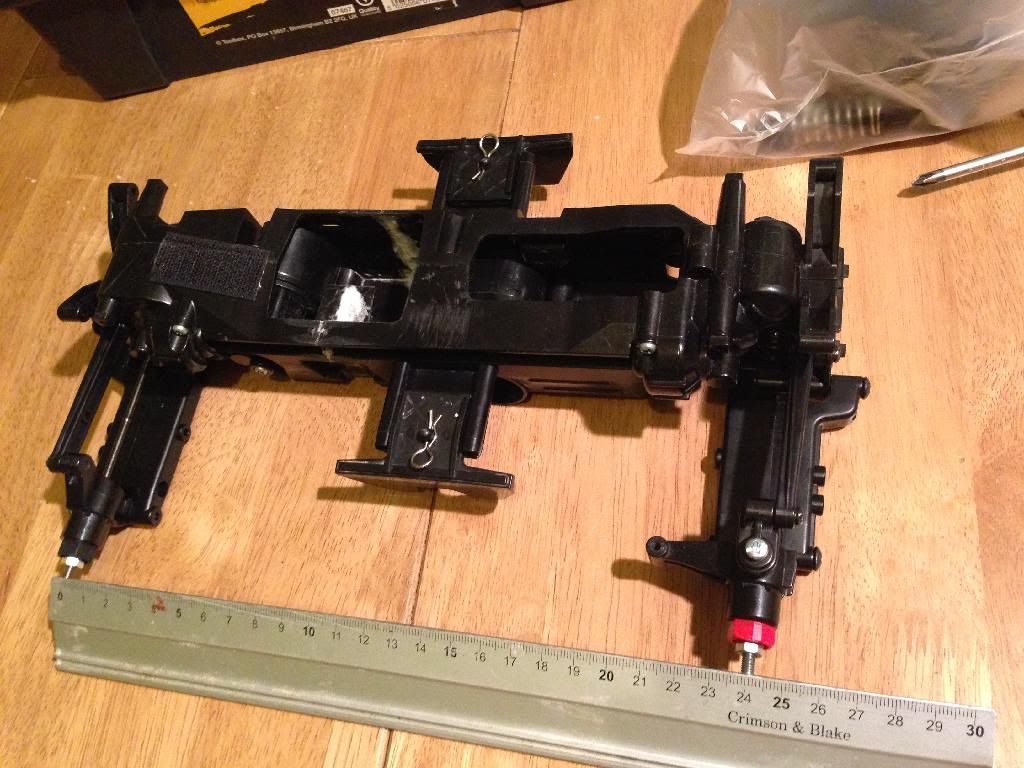

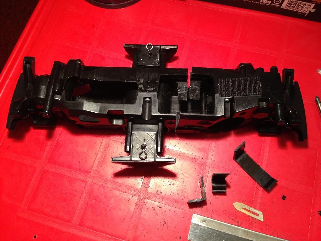

Chassis was prepped and the cut lines marked
42A5313B-36A7-4453-B308-F9DEC908A342_zps
This time a staggered the join to help retain as much strength as I could. All the bits removed with a fine hand saw and the join cleaned up with a file.
8E7D58FD-BEC3-4A22-906B-518F83E0119B_zps
I rejoined the chassis parts with Plastech motorcycle panel repair kit, it's very tough and Ive yet to break one. Did one side and let it dry over night, once cured I fixed it to the other side with a little cellotape between the halfs and did the 2nd side too. Fully cured & sanded its "Strong like bull!"
90B0DD3F-649E-476D-BF64-2CF3584C5BF4_zps

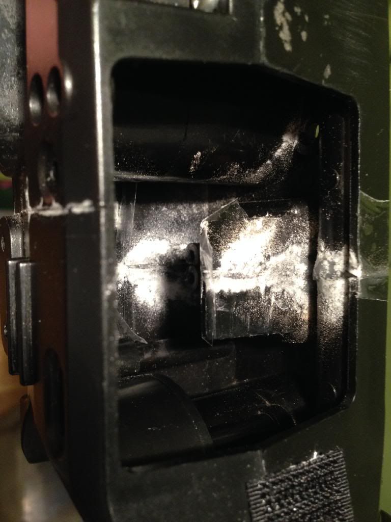

As I only removed 15mm I was able to retain the electrics shelf in the servo bay. Checked against a ruler and the wheelbase is now spot on.
DD8C3873-A2D0-4A71-953D-218901EDA876_zps
AE1FF70E-506E-4B77-BD11-8E8B836B4147_zps
I also like how the battery is now dead centre. A fresh set of TL01 arms arrived and helpfully the frames included the body mounts. Amazingly the front bonnet holes from where I'd mounted the body on a KBF chassis were in the correct place for the standard front TL mounts! The rears just needed 2 holes drilled either side of the split window this bodyshell comes with. After cutting the windows out it was getting there.

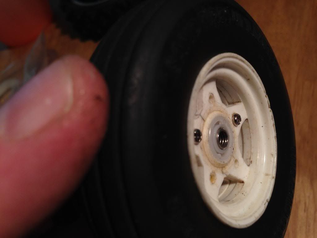

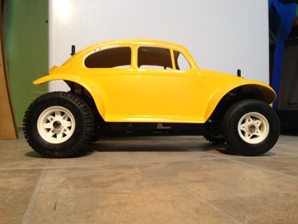

Ordered a cheap set of 1.9 rally wheels & tyres from ripmax which arrived today but they just don't have the look I want.
F5AEE519-67BC-4D4F-A76B-C4E285A20F2E_zps
7E17D9CD-4F7D-4655-A6EA-87B1C5DD9B63_zps

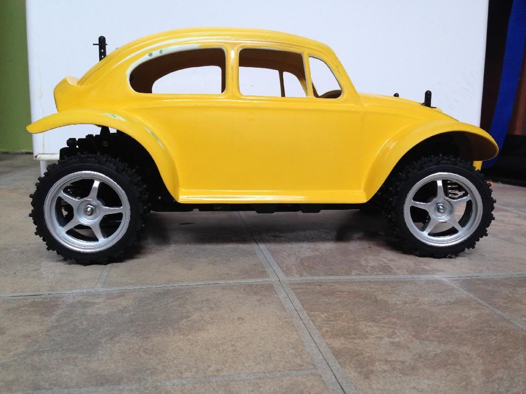

I'm pretty much certain I'll need to go for a set of Grasshopper wheels and tyres or maybe the FAV's. Of course that means fitting the old style wheels to a 12mm hub, but checking out the options and fiddling with my spares box I think I've sorted the rear end.

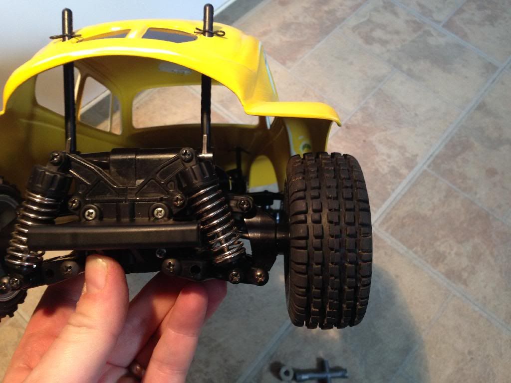

I have a set or Brat tyres on my Grasshopper so using those as a guide I found I had an axle extension kit with extended wheel nuts... don't really know how to describe them so I'll let the pics below do the talking.
Standard TL rear end and axle minus the 12mm hex hub.
8EF6D121-1D72-4538-8113-9952C820986F_zps

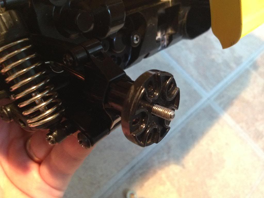

I filed off the slight ridge on the Grasshopper hub as it was binding, next to it is the extended "nut"
920A6233-70EE-44D0-A766-B91B11BC8528_zps

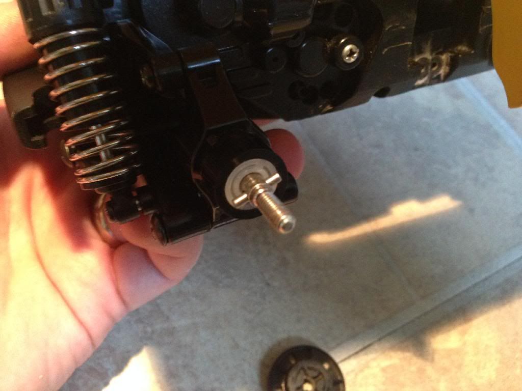

Fit the GH hub on the TL axle and locate it on the pin. You can see that normally the threaded section of axle won't be long enough to pass through the wheel.
2F1E48EE-6409-49F3-900B-D01031CA68EE_zps

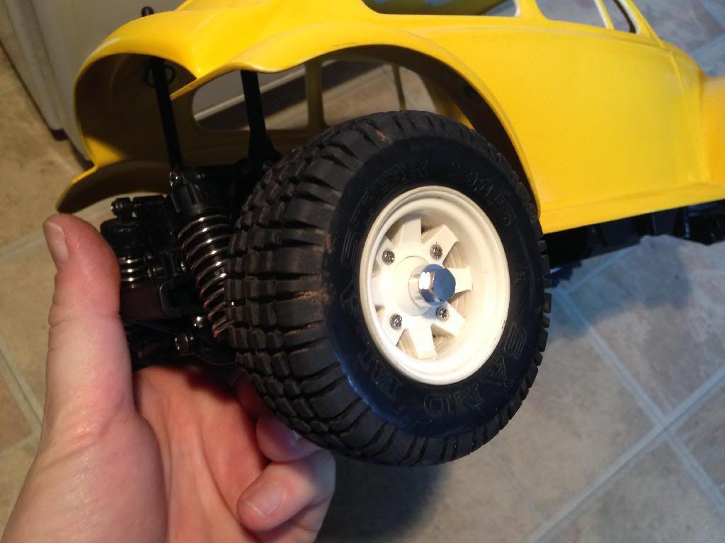

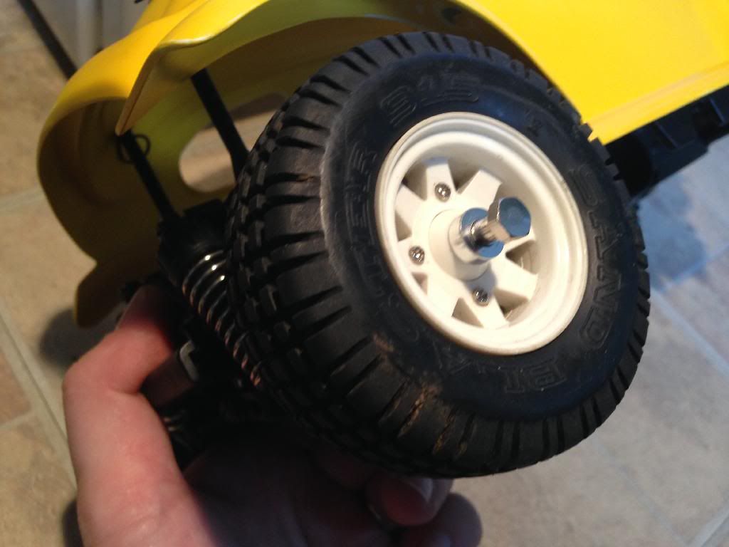

Lucky for me this extended nut has a 5mm diameter so it fits through the Brat wheel nice and snug and screws onto the 4m axle. It is apx 4mm too long but as it happens they came with a washer/spacer which doesn't look too bad.
AC488DA4-7FFF-43B7-B30D-86D719B36424_zps
B926E9D1-7109-48DA-9749-41FD4E85DED3_zps
I might trim it down to lose the spacer but that has worked out surprisingly well I thought, looks clean and has moved the wheel out to just where I wanted it :)

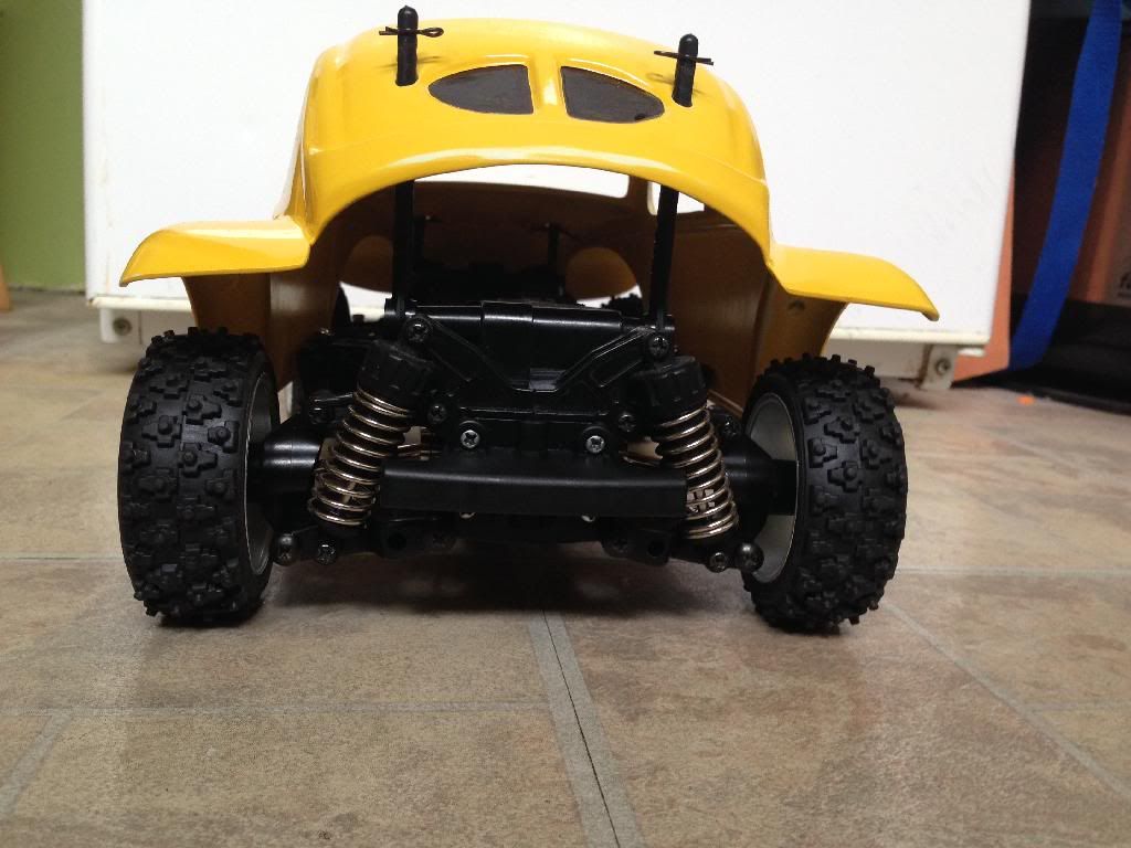

The front end is a where I'm at now. It's already converted to RWD by loosing the propshaft, dogbones and front diff. I replaced the drive cups with free wheeling hubs so I'm now working out how to fit a bearing type front wheel to a 12mm hub... or whether it's best to ditch them and modify a Grasshopper or DT02 knuckle to fit the TL arms. I'm happy with how the side profile looks tho in mockup
4EAF61A9-D638-497D-BDD0-4C0968101A09_zps
And that's how far I've got. It'll probably get a Willy driver figure as I have a few spare and I want to give it some cockpit detail and a roll cage. Also need to make an air cooled engine to fill up the rear end and fit some lights. Paint wise it'll be a weather worn Baja racer so faded panels and copious rust spots.

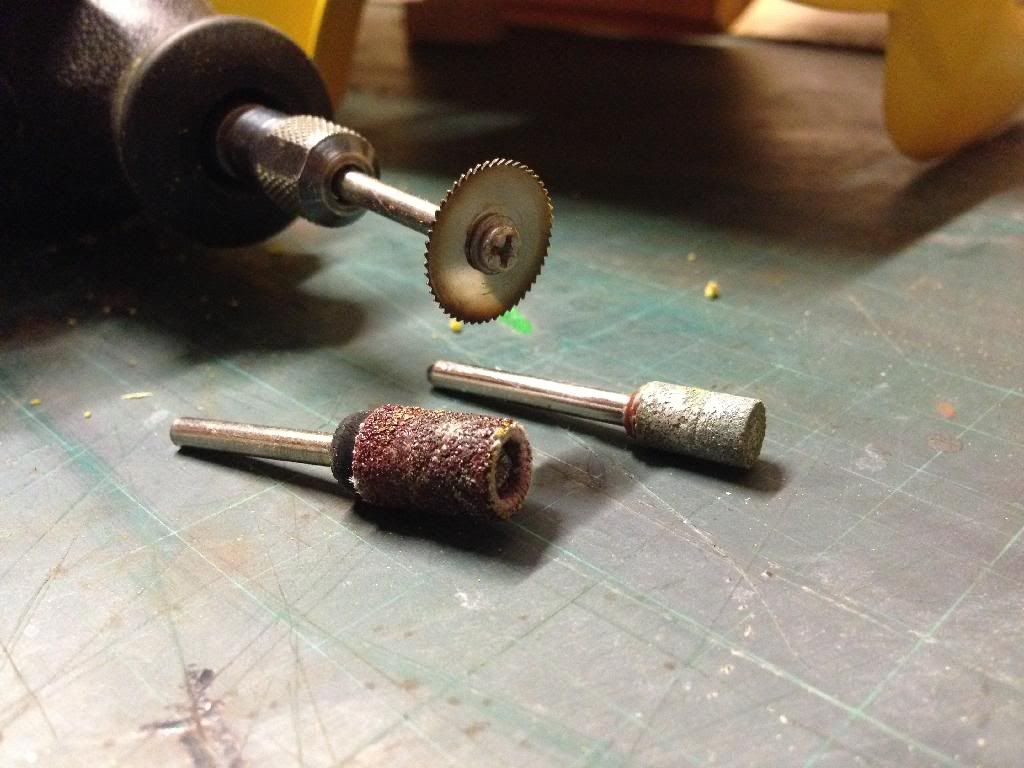

Will, re the window cutting I had previously painted the windows in black for a quick fix to go on a beach run so I used that as a guide. It's worth at least running an outline in permanent marker along the contours as I find it helps when the plastic starts to fly. I used a Dremel with a 3mm drill but, a tiny circular saw blade and a couple of sized sanding drums.
4479DAF9-8580-4ABB-B368-60743139F249_zps
Drill close to where you want the corners to be then cut out the main area with the saw disc a good 2-3mm in from where you want the final line to end. Punch out the unwanted plastic and use the sanding drums to gradually work your way into where you want the edge to be. Finish off with files and sand paper. It makes a load of mess so keep a hoover nearby and don't do it over a deep pile carpet as it'll never come out :)

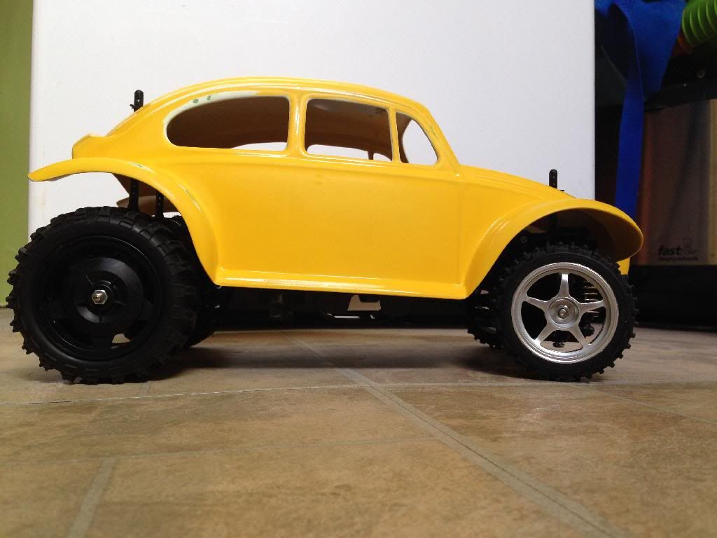

Mongoose, yeah a wasn't sure what colour to go with, yellow was the quick spray job I gave it last year and it's works well. I was thinking to fill in a few white panel similar to a box art scorcher and then distress them. I want this to look like a well worn desert racer and as it picks up scraps I'll fill them in with rusty effects, embrase the damage!
GregM, I agree it needs the scorcher/grasshopper wheels. I tried a 90mm tyre on a DT02 2.2 star dish but it looked way too big to me :(
8E5F583A-131F-46EF-94F3-77826985992C_zps
Not right at all. Old skool wheels for me, I just wish some after market manufacture would make them with a 12mm hex fitting!

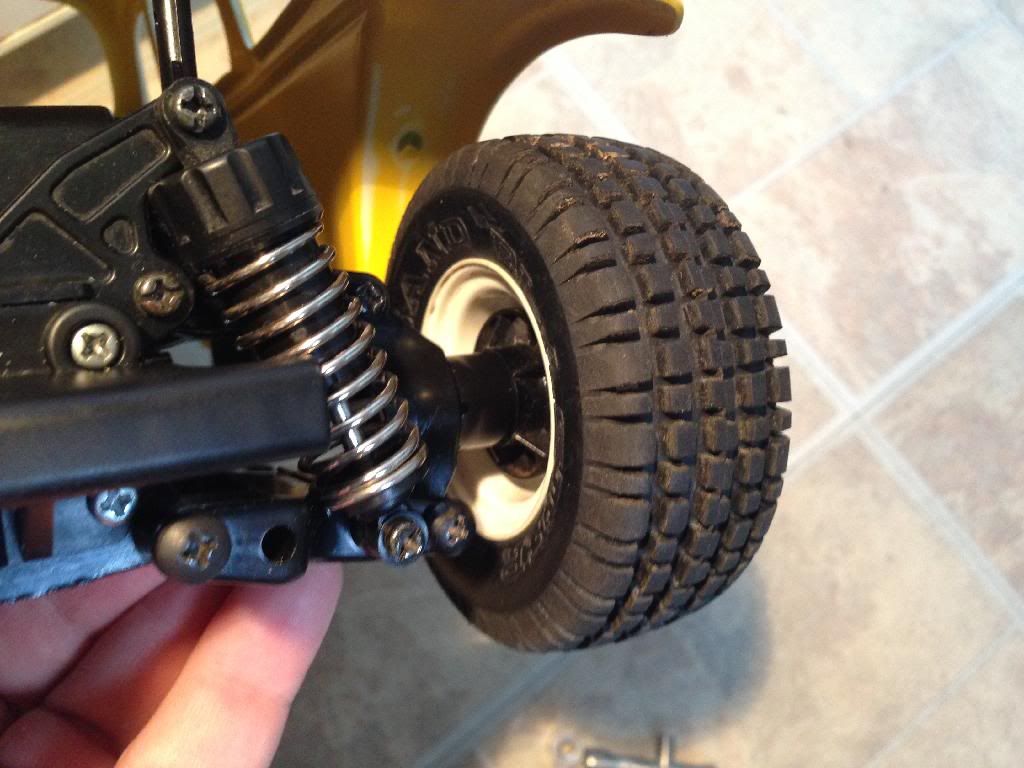

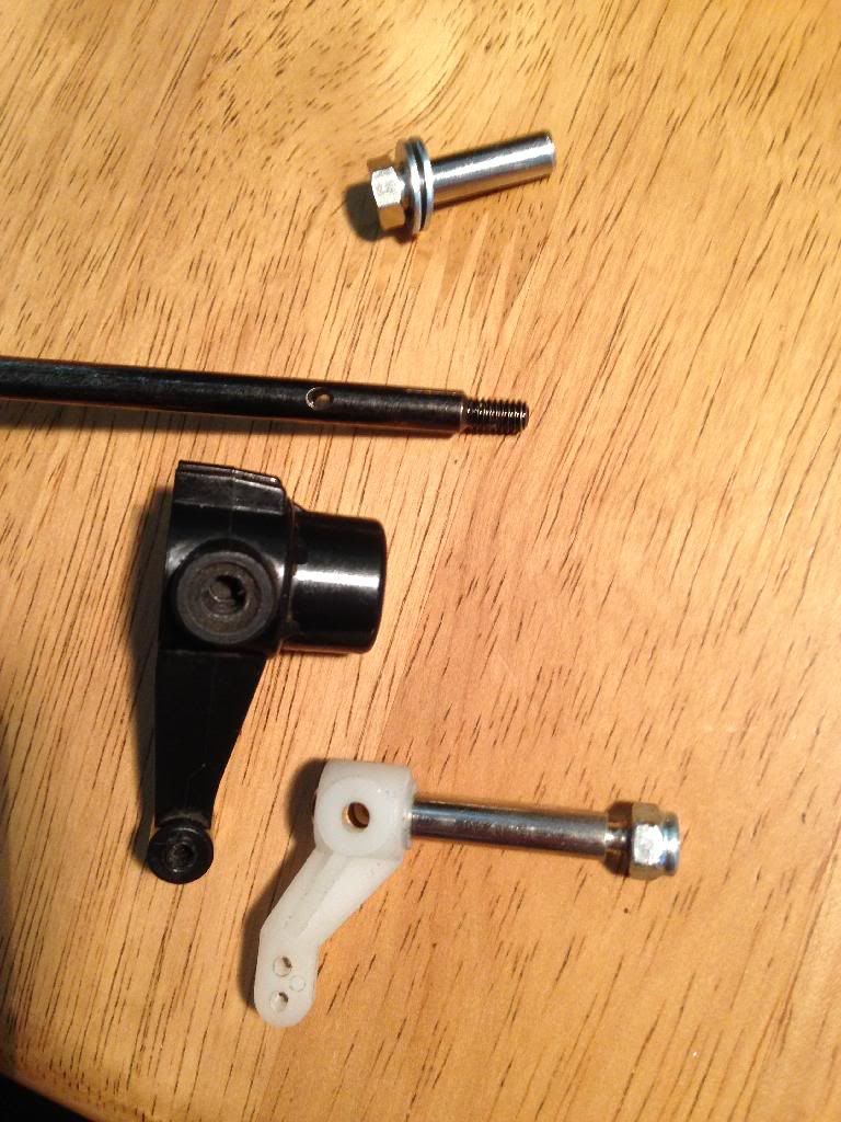

The black steering knuckle/hub in the centre is the TL01 standard part. One option would be to take the Lunchbox steering knuckle at the bottom and cut off all the excess plastic to allow it to be push fitted into the back of the TL knuckle. Fill it with epoxy glue and it should work I think.
A prefered option was to use the spare Lunchbox rear axle and fit it into the bushings in the TL knuckle and measure where the pin hole comes through the shaft. You could then drill a corresponding hole thought the knuckle and use a brass rod pin to capture the shaft in place. Then cut off the excess axle behind the bushings.

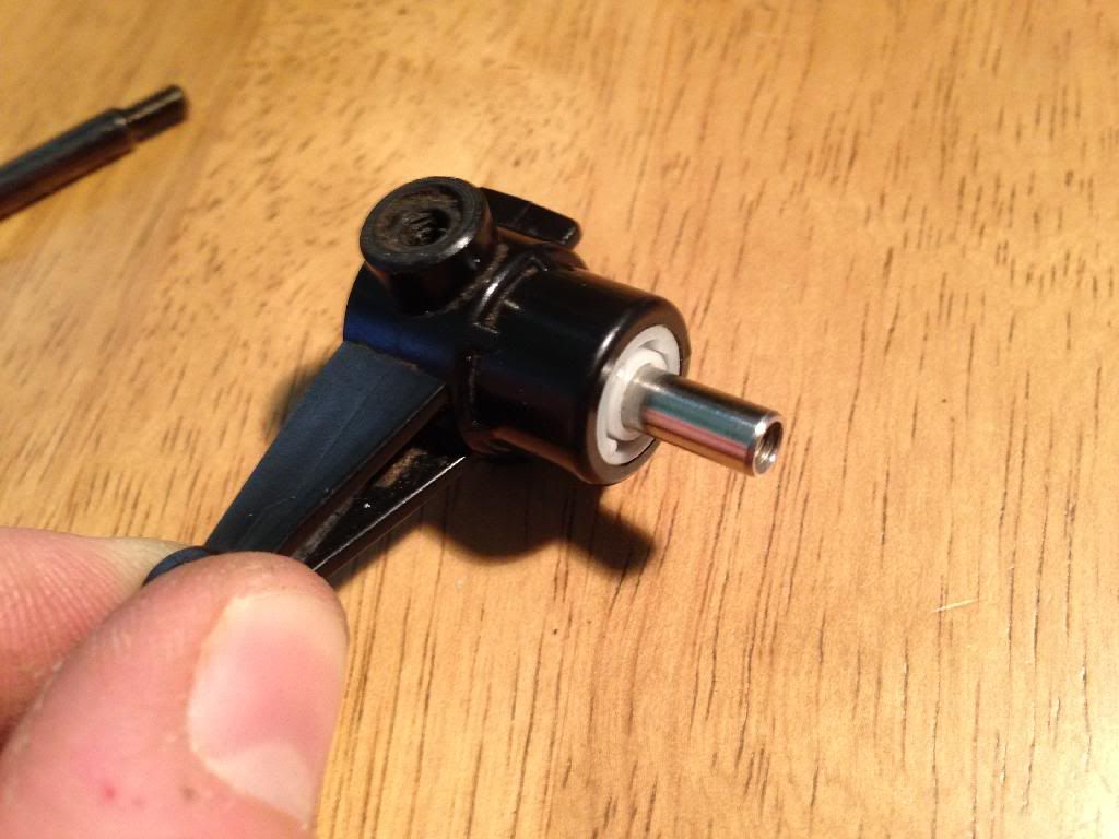

But I've chosen to use the remaining pair of those extension nuts as axles for the GH wheel to ride on, here's how I've done it.
Slipping them into the bushings from the rear I found the extension nuts were a few millimeters too short so I flipped the TL knuckle over and removed the inner bushing.
BBAE1A54-5461-4F72-B26B-218763C52DBC_zps
With the 2 washers it stopped the nut pulling out and gives it just the right depth
7EF3469E-51E2-46FC-8CF2-73B1DBD58D19_zps
With the GH front wheel in place it leaves just under a millimeter of wiggle room so it won't bind on the bolt but also doesn't wobble either.
5570CC54-7193-46EE-8392-414B99772CDF_zps
The only downside I can see to this arrangement is you need to at least partially take off the knuckle to remove the wheel by gripping the head of the extension nut.
A1A78969-FCE0-4D84-B7CF-887214E7FB82_zps
But I can live with that as it's such a clean solution. All fitted and it sits just right.
42B3D9CA-C3D7-459D-9BD6-8978D0E40A1B_zps
7755B26C-9884-49ED-8625-25BB58CD4B51_zps
