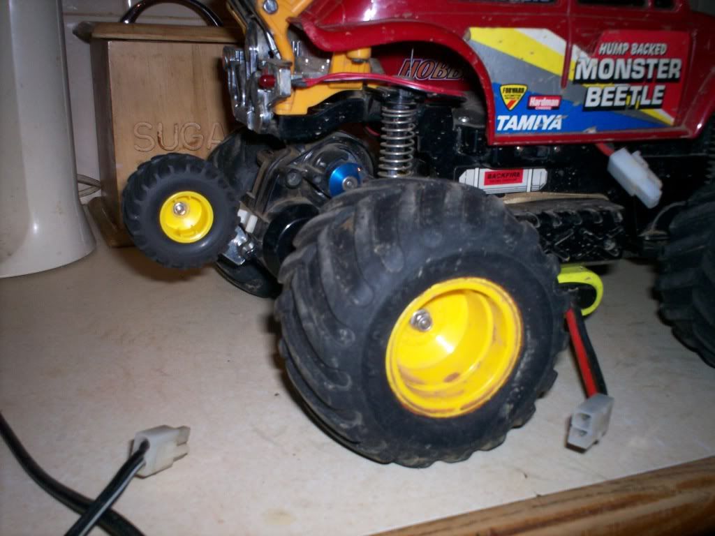

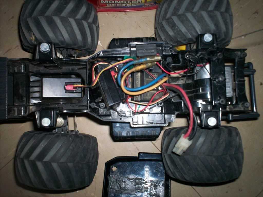

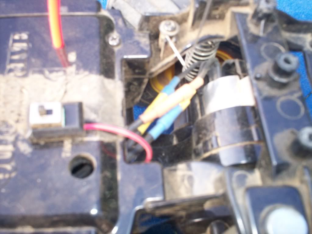

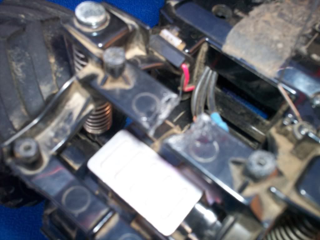

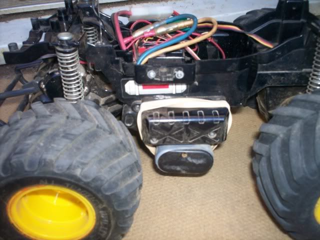

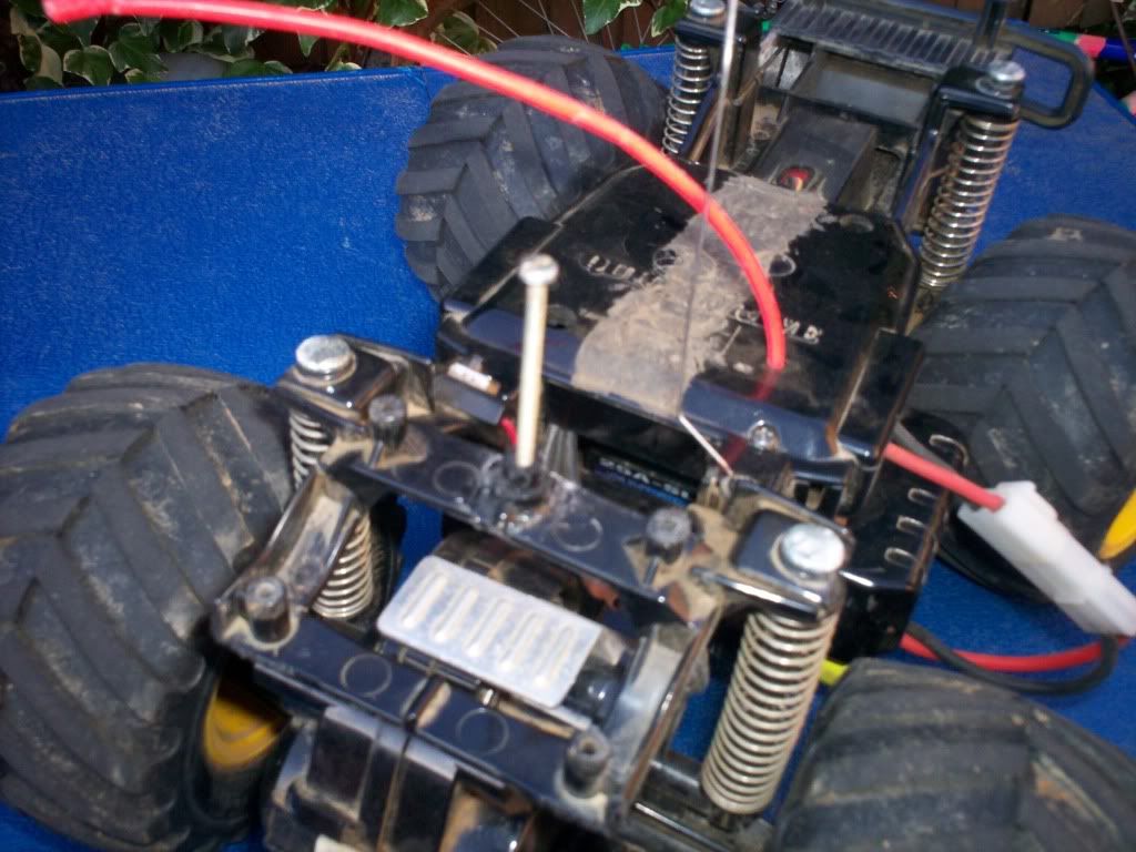

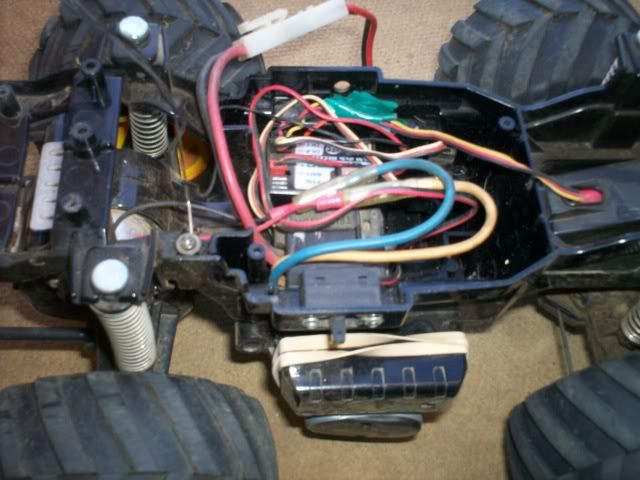

I was a bit bored today, so I ripped all the electrics from my shelf queen and the ESC, and fitted them into my QD beetle!!
I had previously squeezed a steering servo into the box by cutting the fixing tabs from it so I just had to fit the ESC and Rx, (I had all ready removed all electrics from the beetle), it all fitted in easy(where the circuit board used to be!), connected the motor wires to the bullet connections on speed control and stuck the 7.2V battery on top with double sided sticky tape!!
The runtime has increased dramatically, it must have lasted well over an hour!!(much better than the 8AA batteries that were there before!)
I will post some pics but my camera is bust at the moment!!
E2A: I did try before with an MSC and and old Futaba servo with an acoms servo for steering and the QD Transmitter and crystals, but I managed to break two acoms receivers in the process!! :D

Hi Dazaa, I also have a QD Monster beetle in the box!, I bought this one as spare to make one good one out of two!, I have no idea of the worth!, whatever someone wants to pay I suppose!...
I wasn't concerned about cutting the tabs off the acoms servo as I had a spare!, and knew that it would work!..

#13 wolfdogstinkus
wolfdogstinkus
    Member
  • Members
  • PipPipPip
  • 1680 posts
  • Gender:Male
  • Location:Northamptonshire, U.K
Posted 24 December 2008 - 06:29 PM
There ya go!............
Posted Image
Posted Image
Posted Image
You can see the sticky mess where I stuck the 7.2V battery on, but it fits under the shell without any problems!!

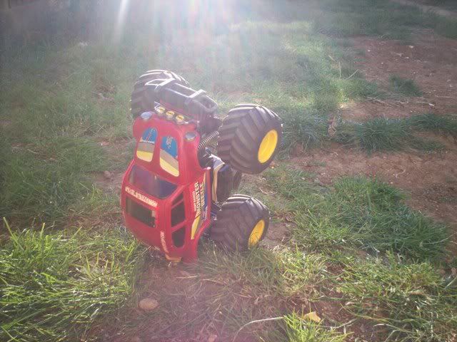

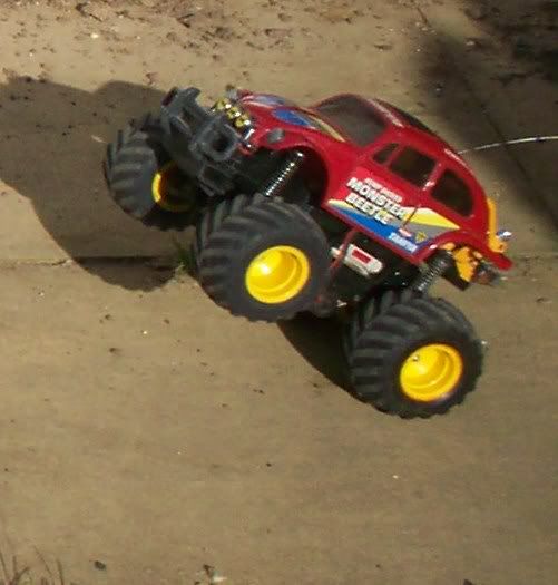

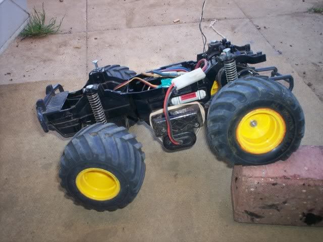

I put my radio gear back in the Qd! :blink:
Posted Image
Posted Image
Posted Image
Now it does this!
Posted Image
Posted Image
Posted Image
Posted Image
Posted Image
And one more to finish the evening off!, got stuck
Posted Image

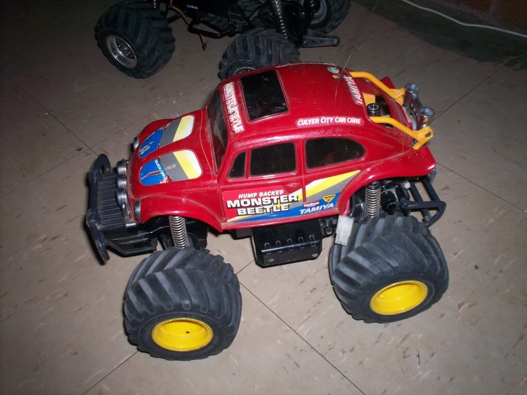

I received my EZRUN set-up today!, 18T motor, 25 amp ESC,
Posted Image
Posted Image
Bearings fitted,
Hmmmm, there's 3 wires coming from my motor :lol: ;)
Posted Image
Plenty room,
Posted Image

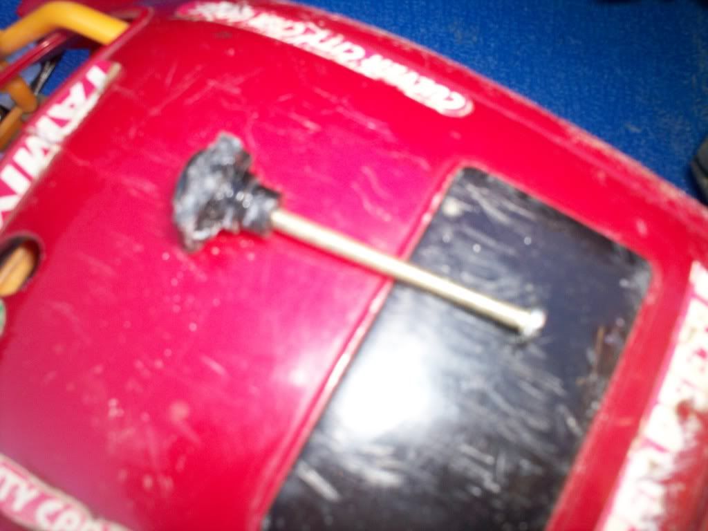

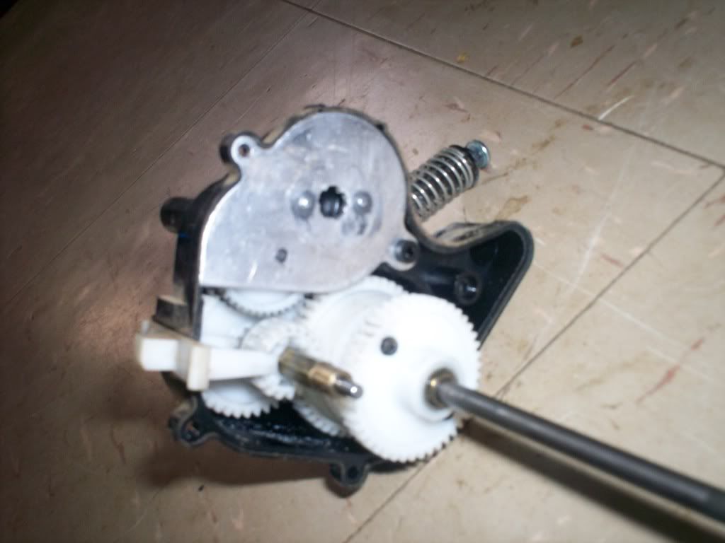

Ok so I broke it!!, not too bad though, just the body mount.
Posted Image
Posted Image
Posted Image
Have to reinforce it somehow :D

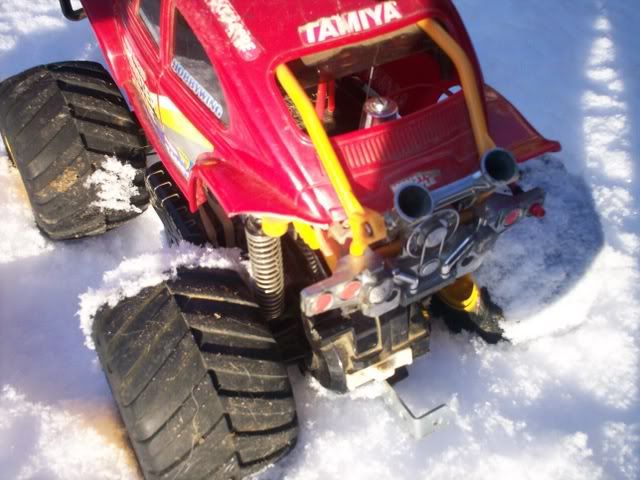

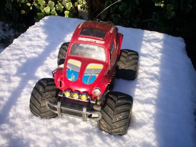

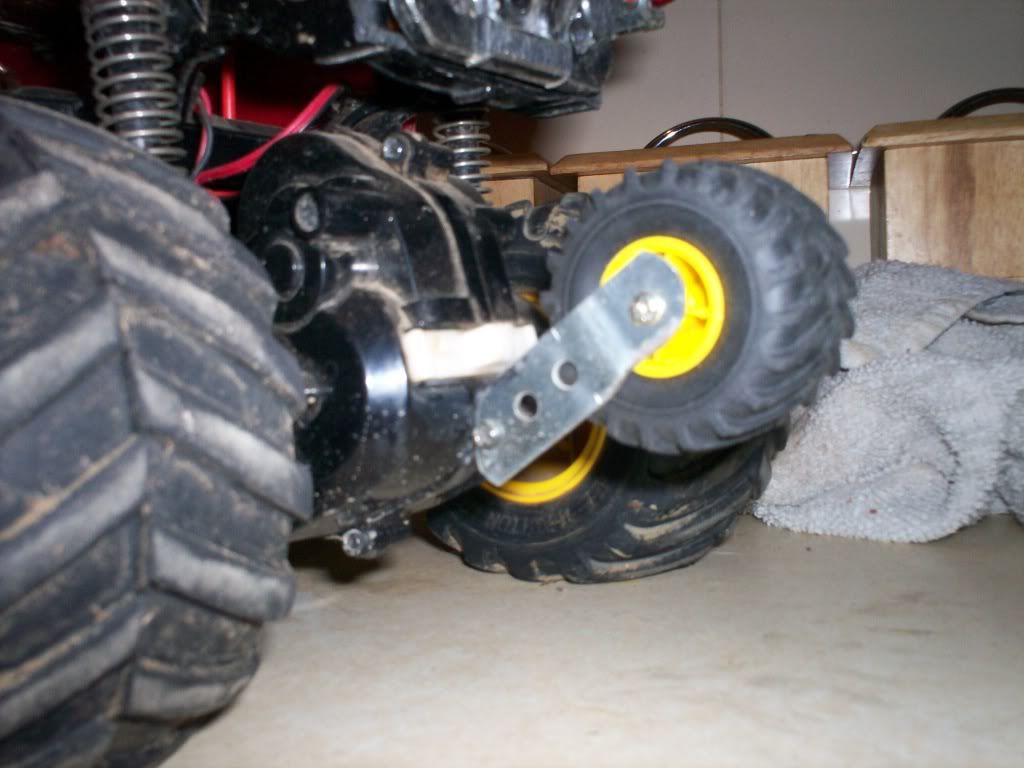

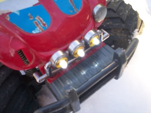

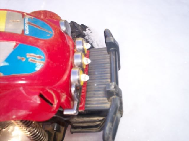

I got bored the other night and had a LED torch that no longer worked.
Three of the LED's are working again, and also a red one that used to belong to a car alarm.
Posted Image
Got a few battle scars now caused by having a brushless motor.
Lost a headlight, got an LED lightbar though.
Posted Image
Lost a piece of my rear wing and the cage around the rear.You can just make out a single red LED far right, I could only find one.
Posted Image
And the lightbar working, it's powered by 3 AAAbateries and has a seperate switch.
Posted Image
Thanks for looking.
