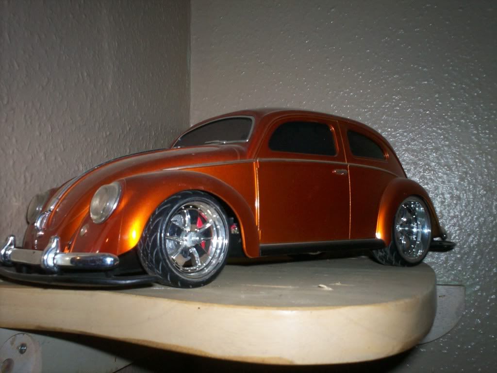

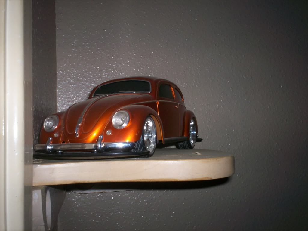

What should I put this on?
I won it on the bay before xmas quite cheap, (cheaper than a Tamiya body)
Was thinking M04-L but the body is a bit too long, maybe only mm's?
Posted Image
Posted Image
Posted Image
Edit 2 Add; might go faster if I dusted it?

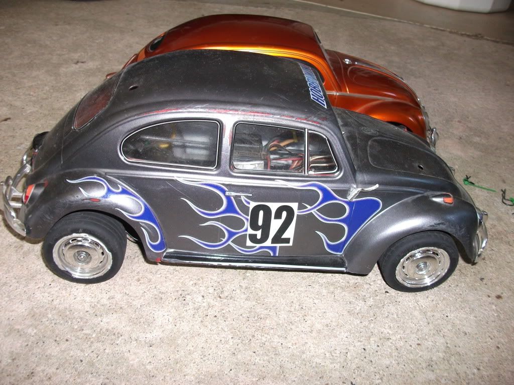

Is this the same body?
still very early in this project... rebuilt the gearbox with new gears and full bearings and stuck in a brand new motor. cut off the fenders and now it's time for some styrene slingin...
Posted Image
Posted Image

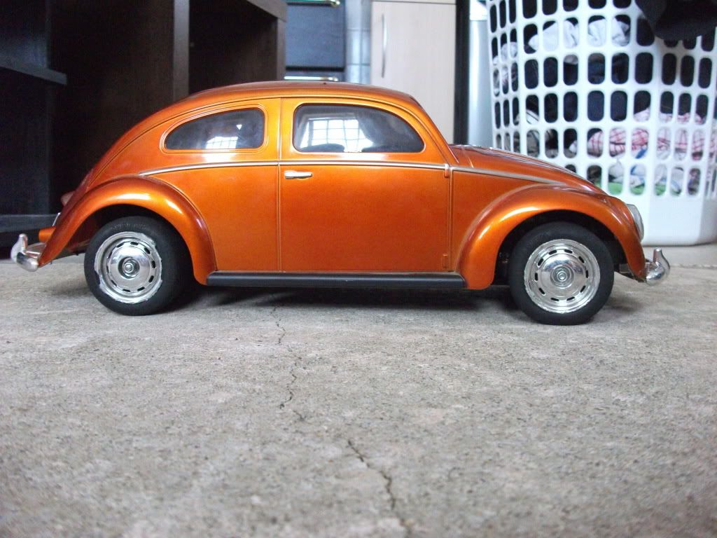

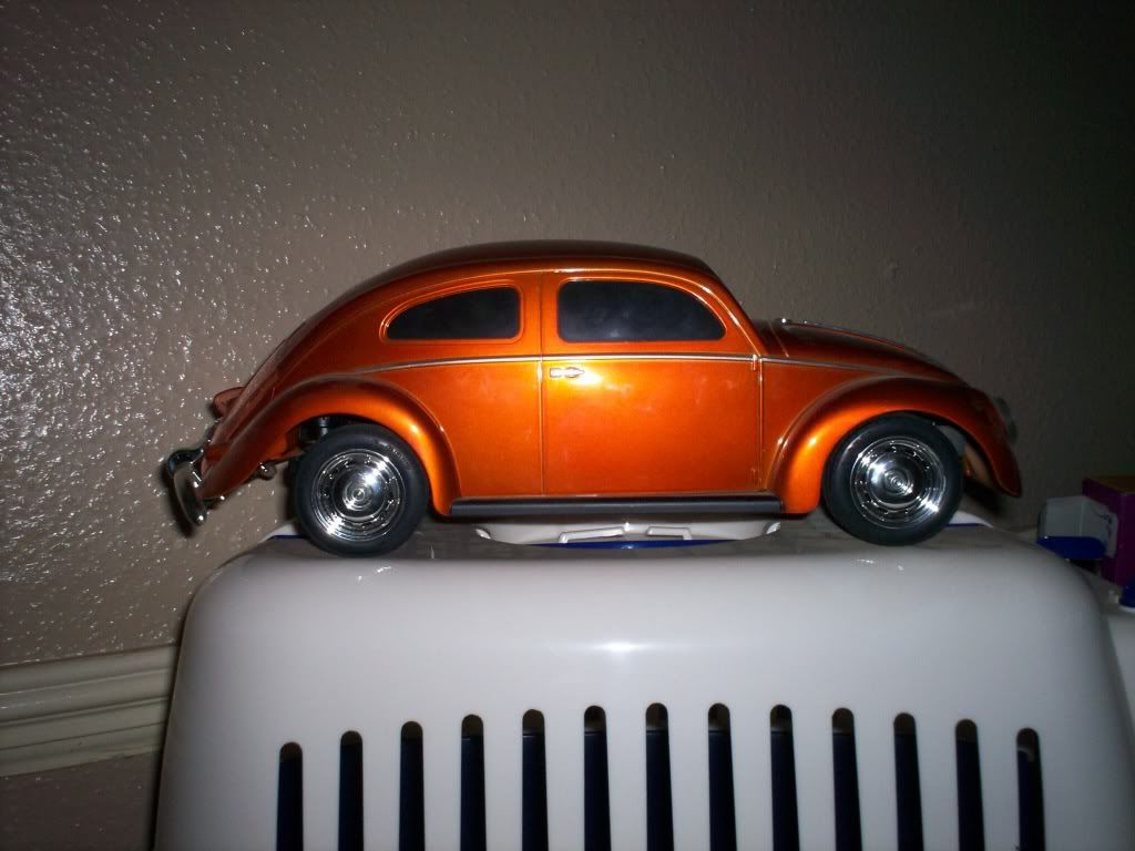

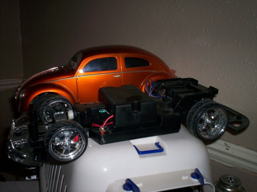

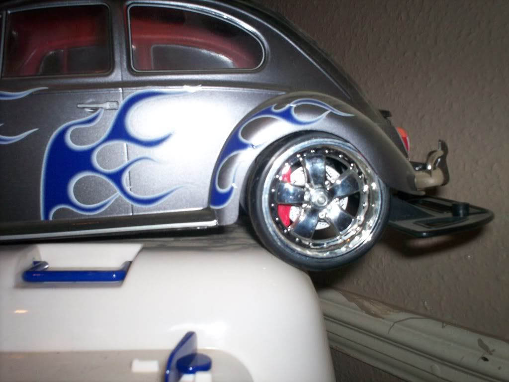

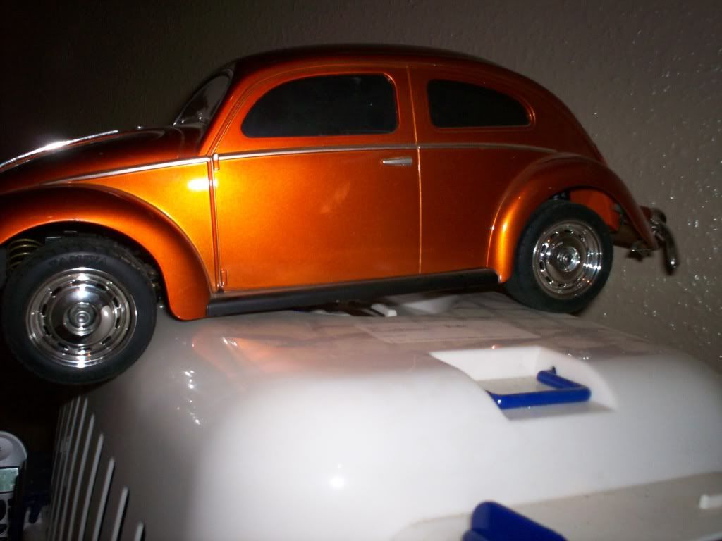

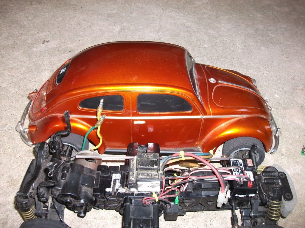

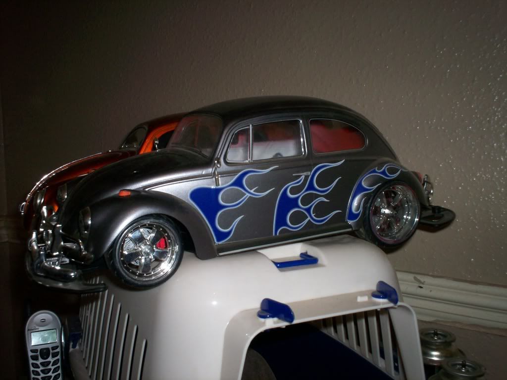

Here is the Maisto body on the M04L, Just sitting on, not fixed
Posted Image
The width is perfect!
Posted Image
Need to shift the rear wheel back a wee bit?
Posted Image
This is the Maisto chassis
Posted Image
Tamiya body on Maisto chassis, Nice
Posted Image
Posted Image
So, I think I want to fit the Maisto body to the M04L chassis as a runner, need to stretch the chassis a bit and source some nice wheels.
Any ideas or opinions gratefully received. Thanks

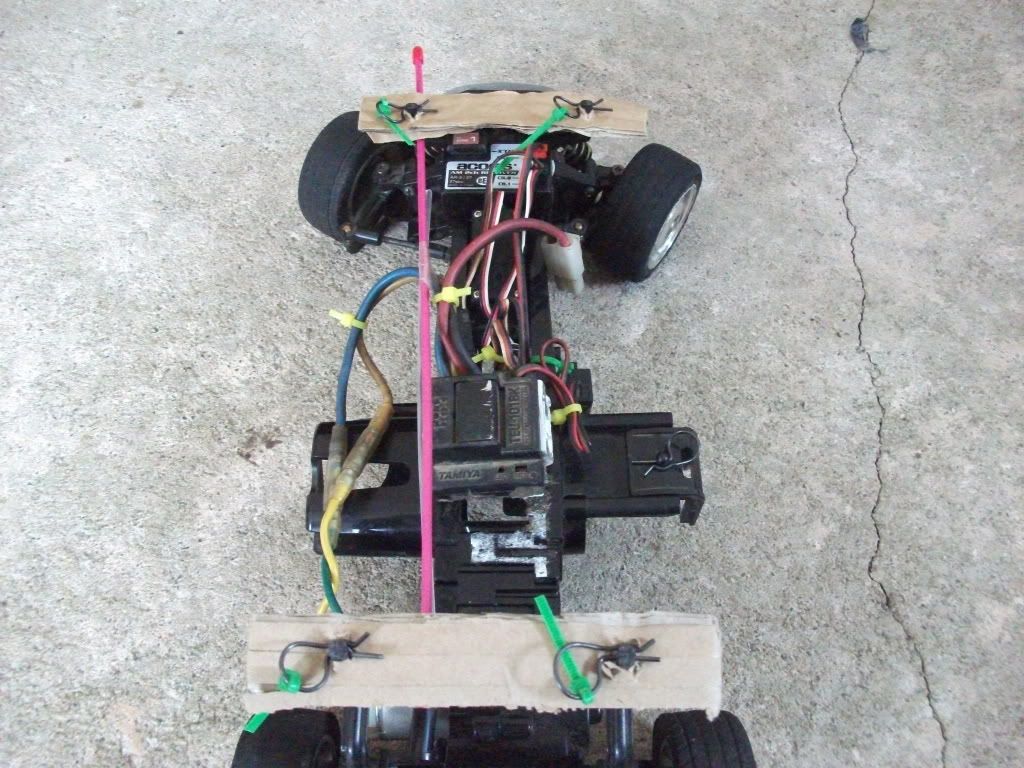

Got a new chassis to replace the bent one and it came with the spacer, added it on to the chassis and it's a perfect fit for the Maisto body, just need to find a way of fixing it on to the chassis?, any suggestions welcome. I don't really want to drill/ ream holes in the body.
Posted Image
Posted Image
Posted Image
Posted Image
I also want to fit a larger wheel and tyre to the rear of the car so need suggestions for that as well please. ;)

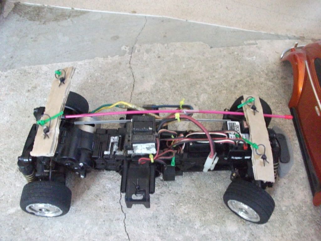

Just had a thought, how about this, but in styrene or aluminum? with velcro to hold the body in place.
Posted Image
Posted Image
Need a bigger wheel for the back end
Posted Image
How it might sit
Posted Image

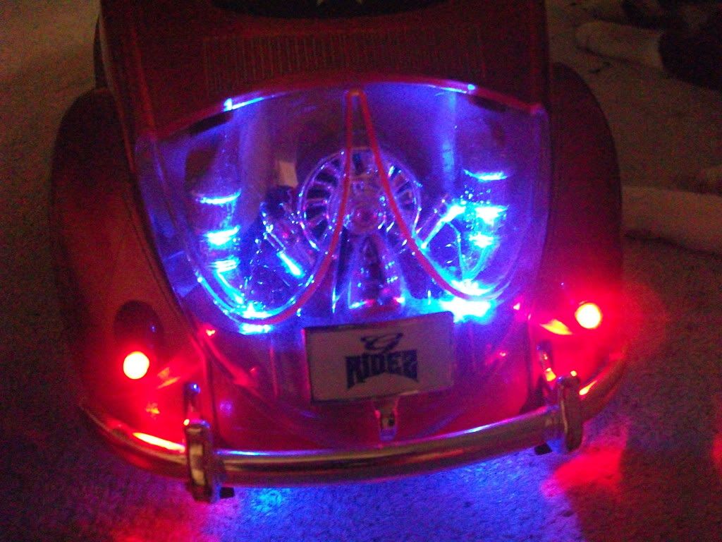

Stuck the body on with velcro in the end, I did try magnets first but I couldn't get good contact between body and chassis.
I left part of the old front bumper on but I might take this off.The velcro holds it really well and it can be picked up by the body.
Added some L.E.D's.

Thanks Skottoman, the original Maisto car had headlights and blue lights in the engine bay but no tail-lights, I blew them up by accident, I think I tried to power them with a Tamiya battery or something and they popped, so I got a set on the bay and fitted them instead.
Also the Maisto car had 3channels so the lights could be turned on and off by the transmitter but the chassis was rubbish, I did originally buy it with the intention of putting the body on a decent chassis especially after seeing some of Kingcobra's work. (if you havn't seen his work, click on the link above or search his username for some fine builds :) )
