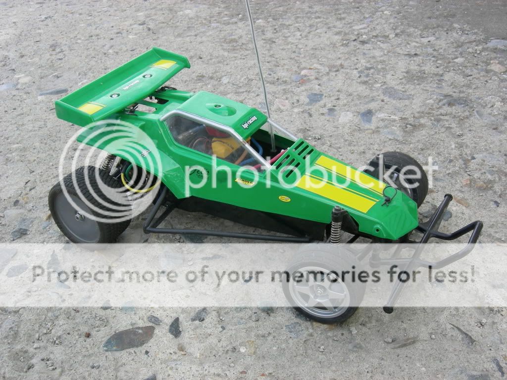

I managed to mount the tires from a Group C car (Mazda 787b) by using a 14mm Traxxas hex-adapter and some spacers, the front fits with no modification...
The problem is finding the green bits...
