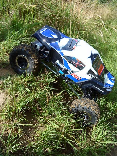

I couldnt resist the crawling temptation any longer and having read the great advice on Static Age's budget rock crawler thread I caved in and bought myself a Maverick Scout. What a well made bit of kit for the price. I was expecting a lot less metal content from a £125 RTR deal. I've mostly been climbing around the garden but I finally managed to take it out today on some proper rocks and grassy banks.
Posted Image
Posted Image
So far all I've done is drop the body down about 1 inch, added 200gms of lead to the front wheels and 100gms to the rears & vented all wheels to 3mm. It performed great today climbing a huge pile of rocks down at Priory Farm which is a local family friendly spot just outside Redhill. I even had my 6 year old nephew teaching me the give it some welly technique of climbing boulders wear I'd failed miserably.
Posted Image
King of the castle.
Posted Image
Posted Image
Crawler nirvana
Posted Image
I hate that body though. I have an 80's era Jeep body on the way from the states along with a set of bent lower links to improve the ground clearance. I'm also thinking to slightly re-gig the chassis with the addition of some alum "L" beams and remount the shocks onto them for more of a scale look. It'll also hopefully counter some of the torque twist it has on the standard set up.
Im toying with the idea of changing the motor as I believe the standard kit one is 14T, is that right? Sounds more of a sporty motor than crawler to me but I assume its the reduction in the gearing that enables it to perform so well. Still think it might be worth swapping out, am I right in thinking a standard Tamiya RS540 would actually produce more torque being 27T? I have a few of those sitting around already.
All in all Im very happy and it certainly makes for a whole different type of R/Cing fun. I now find myself eyeing up rock faces, earth banks and tree roots while Im out and about and thinking hmmm, I recon if I approach from here I could make it <_<
I'll get some more pics up once the new bits arrive.

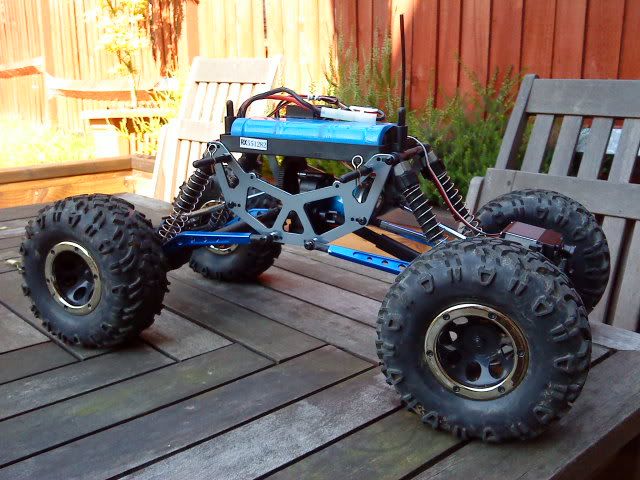

Right, I've had some time to tinker with the Maverick this week. First I've fitted a set of alum high clearance links from Dyamite. Needed to fit a spacer under the front shocks to help clear the links. I also angled them and sanded a small amount out of the links to help the front tyres clear them on full lock. Next up I decided to ditch the axle bumpers as they were just getting hung up all the time and the hubs look pretty tough anyway. I also removed their mounting points under the axles so it now has a nice clean scale look
Posted Image
Posted Image
Posted Image
I also had time to test fit a standard Tamiya RS540 motor in the chassis to gauge how it compares to the standard Maverick MM25 motor. It effectively doubled the top speed of the thing. Now Im thinking the Tamiys RS540 is about 27T so I'd agree the Maverick motor is around the 50-55T area as Static Age mentioned earlier. Here's a quick film of the Maverick with the RS540 motor fitted
Posted Image
Way to fast and I couldnt take the sound of mechanical butchery anymore :unsure: I think the next mod will be moving the lower link mount inboard.
Its been out on a few trips now and preformed really well. Just waiting for the Jeep body to arrive and I can get rid of the awful original.

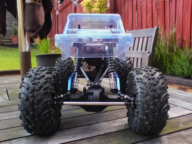

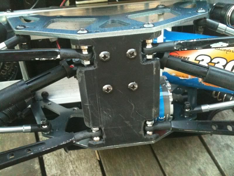

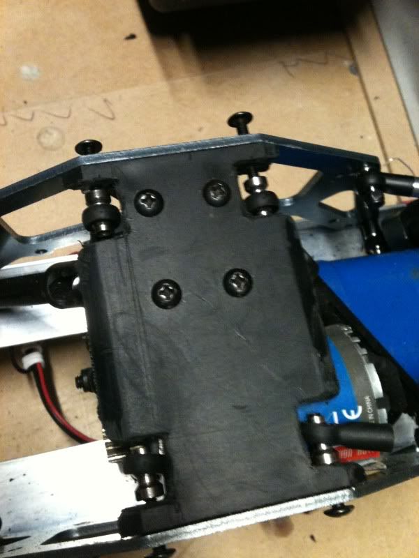

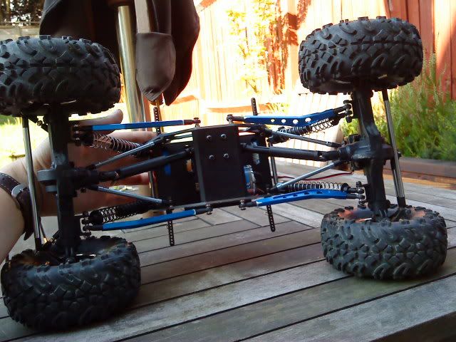

As well as inboarding them at the chassis end, you can also run them in or outside the brackets on the axles - just space the bracket apart where the link would be
This'll help to stop shocks and links clashing too;

I'll have to try that out twinset, great advice.

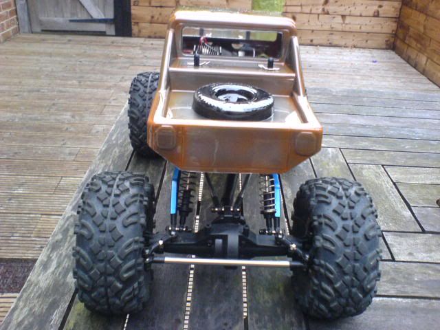

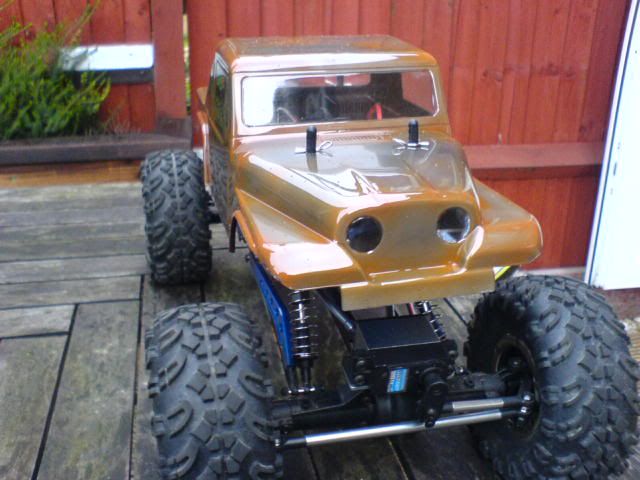

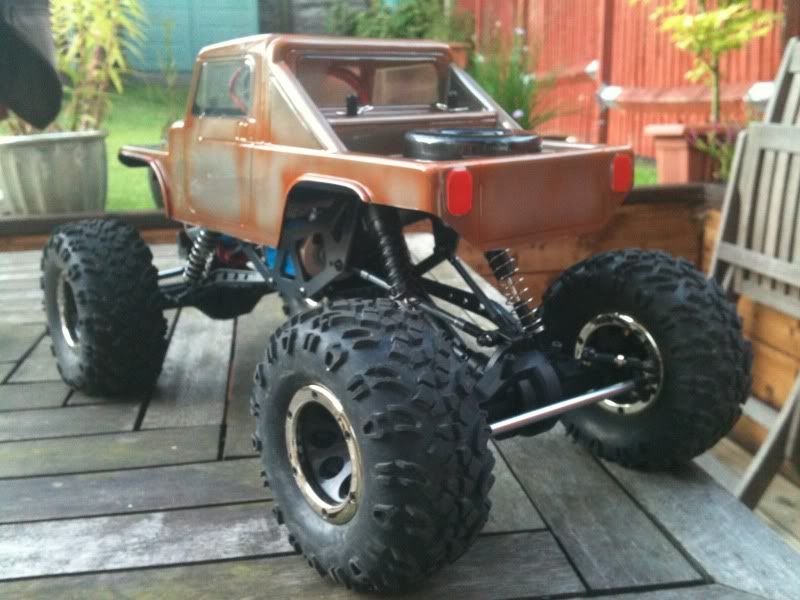

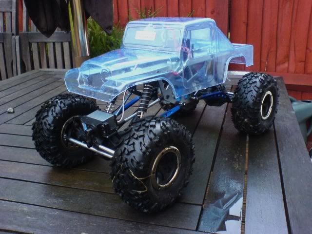

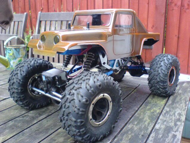

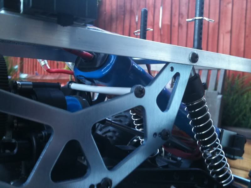

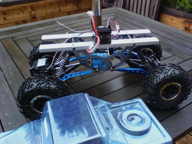

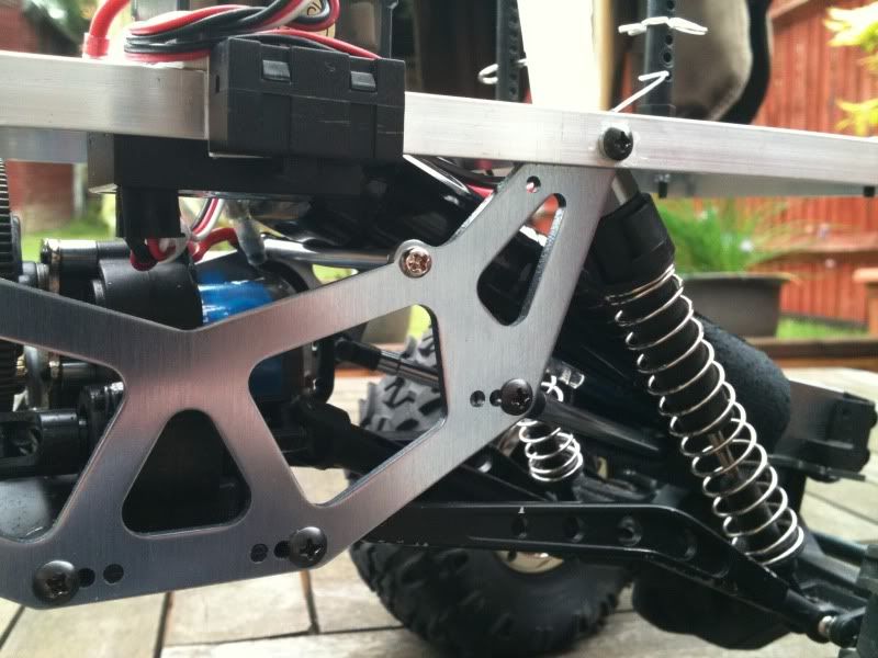

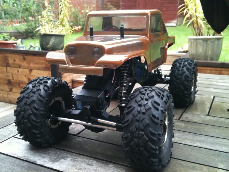

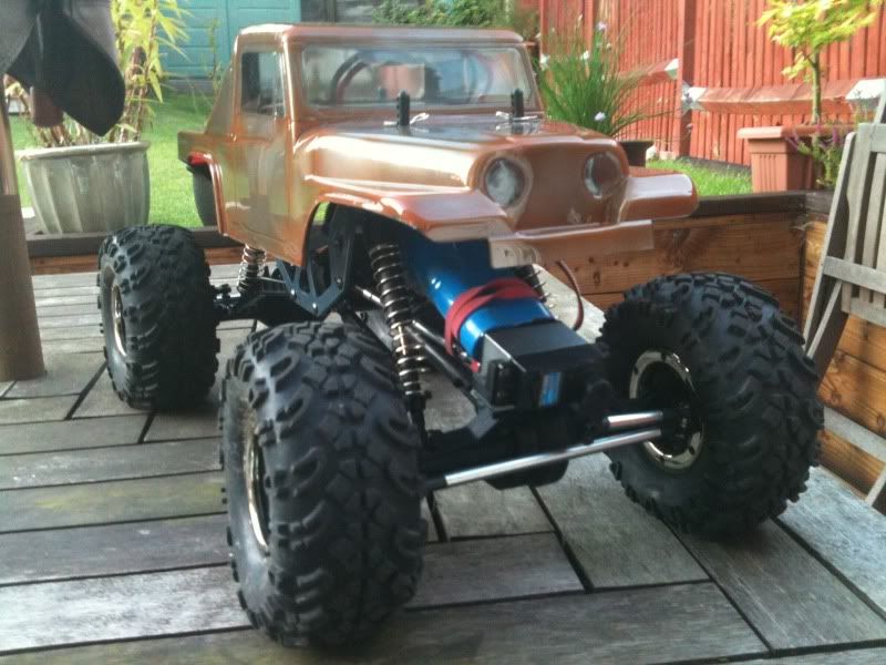

The Jeep body arrived so I've done the initial cut and fitted the alum L beams to the Maverick chassis.
Posted Image
Posted Image
Here's how it looks after another trim & a few test runs today now the body mounts fitted. Battery is currently just held in place by a rubber band until the mounting is finished but will be in a similar position over the steering servo. The reciever and ESC will be relocated once the layout is sorted.
Posted Image
Posted Image
Posted Image
Posted Image
Obviously the body limits the articulation at the extremes but its better than I was expecting. Im planning to move the top shock mounting points away from the centre which should help with the torque twisting the kit suffers from, although its bothering me less the more I run it. Im also thinking to use some tubing on the shock shafts to control their maximum movment and stop the body catching. Paint wise Im thinking I'll paint the inside of the lexan in a rusty steel effect and then give the outside a dirty old paint job. As it picks up knocks and scrapes it'll show through rusty underneath the paint.

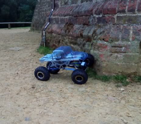

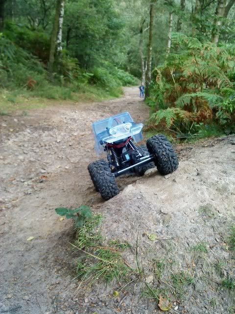

Took the Maverick out to Leith Hill for a little trail run to make sure the body lines are working before the painting starts. Its performing very well all around, climbing better than I'd have expected although the top speed it a bit slow for the long stretches between the bumpy stuff. All I've done since my last update is fit some tubing on the shock shafts to limit the travel and protect the body.
Leith Hill is great for trail driving, lots of dence woodland with walks and paths running through it, it even has some green lanes for real offroad motoring which get nicely calved up and produce some good climbing challenges. We parked at the landslip car park and me and my co-driver took the Maverick all the way up to the tower which at 965 feet above sea level is the highest point in the SE England (if you dont count George Michaels garage :) )
Posted Image
Posted Image
If we hadnt spent so long mucking about with logs and craters on the way up we would've made it to the top on the 3000mah nimh battery it came with. As it was it ran out of juice just 150 yards from the tower but it had been going for about 30-45 mins by then.
We came across this little twig and I wondered "will it make it"
Posted Image
Not bad but I figured it'll never make it back over...
Posted Image
Now thats not bad concidering the pretty limited mods I've done so far.
A quick battery change and we were soon mounting an assault on the defences.
Posted Image
Posted Image
Posted Image
We made it back to the car park with lots of battery left. It even survived a sideways roll down the hillside into the under growth, no harm done just bad driving on my part B)
Lots of fun had and no issues so its time to get the paint on.

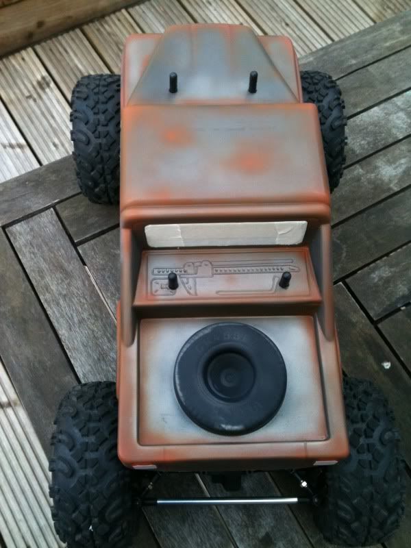

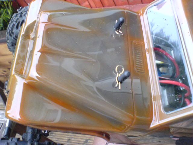

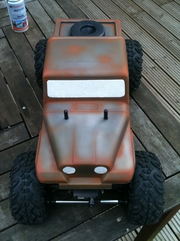

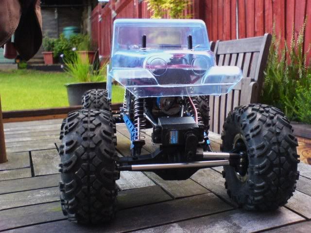

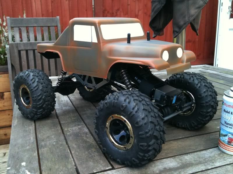

I got the rusty paint effect applied to the inside of the lexan this week. The lexan is so thick and has hardly any flex so I used normal acrylics laying down a heavy dusting mix of orange, red and brown, then over layed with a light silver and toning down through gunmetal to a dark steel colour. Once fully dry I backed it all with Halfords semi gloss black primer which I've found to be very tough and protects the other layers well and also gives the underside a uniform colour.
Posted Image
Posted Image
Posted Image
Posted Image
I forgot to cover the rear lights so I'll have the scrape the paint off the lenses carefully. The bodyshell came with very good masks for the windows and front lights.
Its a little hard to see the rusty effect through the glossy apperance of the lexan. Once I've given it a coat of Humbrol matt varnish on the outside it'll transform the look to the "old rusty bucket" look Im going for. I've found the varnish also sticks to the lexan well and provides a good key to paint the outer layers onto.
Im thinking to go with a faded red paint scheme on the outside probably starting with a mix of red/tan to get a dirty light colour and then increase the red to get what would've been the original base colour. I'll then lighten the panels and upper surfaces to get a sun bleached look and have a few rust spots poking through. The idea of the complicated paint scheme is that as the bodywork picks up knocks and scapes it'll show some realistic damage right down to the rusty steel I've painted on the inside. Although the last time I did this on a Beetle shell I liked the rusty look so much I didnt bother with painting the outer shell at all :D

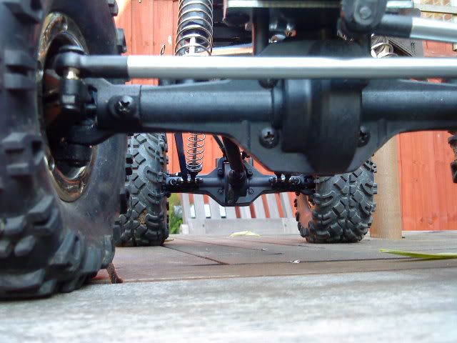

I finally had the time to get the lower links inboard. Didnt take long and I marked out, cut and fitted one link end first to make sure it all worked, then copied the method to the others. Its not as neat as I could've been but I was under a time limit to get it all done before "The General" started nagging.
Posted Image

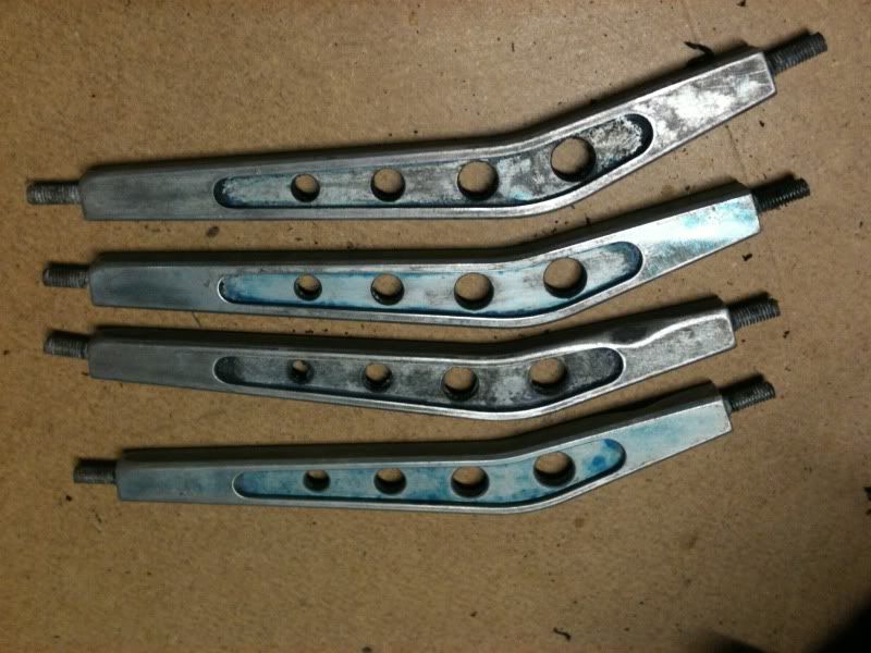

While the links were off I stripped the blue anodising off with some Mr Muscle oven cleaner and sprayed them with Halford satin black primer. Again they couldve done with another soak in fresh cleaner but as they were gonna be painted it didnt matter.
Posted Image
All fitted and test driven. Its already climbing better with this small change and it only cost me the price of 4x 3M nuts :)
Posted Image
I also opened up the tranny and found it was totally dry inside. That explains the awful gear meshing sound so that got a thorough greasing. In fact it seems the standard Scout doesnt have any lube in either diffs, the universal joints or transmission so its well worth stripping it down to do this if you get one. It now purrs around my garden like a kitten.

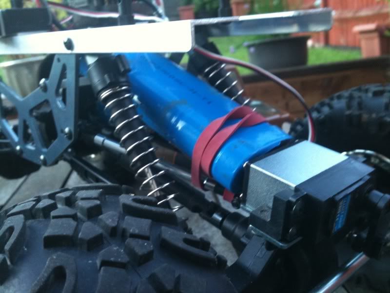

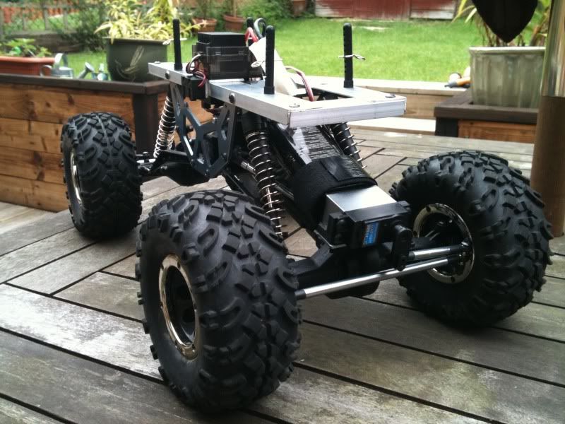

I'm also trying out a new battery position by resting the racing battery pack on the upper front links and a bit pf plastic tubing held between the chassis side plates. Its secured at the front with a loose rubber band to keep it inplace and of course the servo stops it moving forward. This lowers the COG nicely while keeping the weight over the front axle but importantly doesnt interfere with the articulation of the front end. I'll give it a proper test run like this and if Im happy I'll repace the rubber band & plastic tubing with something a bit more professional.
Posted Image
Posted Image
Here's how its looking now.
Posted Image
Posted Image
LED's are on the way from HK so I'll be making some light buckets from plasticard. Need to get on with the outer paint job when I get the chance.

I got the body shell from an Ebay seller in the USA called "steggun29" but he doesnt have anymore ATM. I dont remember it having any branding on the box. It was listed as "Venom Truck Cree 80S CRAWLER PICKUP BODY" but thats not finding anything now :o Its a shame as it was only £24 incl p&p to the UK, its well detailed and made from thick lexan. Came with good window masks and overspray film but no decals.
Yeah Im still not 100% on the battery position. I've made a stretchy velcro stap that looks better, holds it well but still allows a lot of front end articulation. I also replaced the plastic tube for alum.
Posted Image
Posted Image
Posted Image
Posted Image
L beams are completed. Played around with reposisitoning the ESC and receiver. Once I get them both waterproofed I'll make a alum bracket to mount them under the L beams to help the COG and leave the upper level clear for a cab interior.
Im really happy with how its going.

Got the windows and lights masked up today and gave it a quick coat of Humbrol matt varnish. It sticks like the proverbial to fur on the lexan so gives a great key for painting.
Posted Image
Posted Image
Posted Image
It really transforms the look of the rust effect. I did this to a Kamtec Baja Bug shell and liked it so much i didnt bother to paint the outside (funnily enough I had to remove the matt varnish on the Bug later and it looks good even through glossy lexan). What do you guys think, should I still go ahead and paint the outside of the Maverick? I always intended to paint the roll bar and its triangular side panels matt black so I might do that first and then see about painting the rest of the body work. I wondered about masking and painting each panel separately to get an old battered car look thats been repaired throughout its life and now the panels dont quite match. Maybe have one panel or door a completely different colour like its been salvaged from another vehicle.
Your opinions would be much appreciated.
