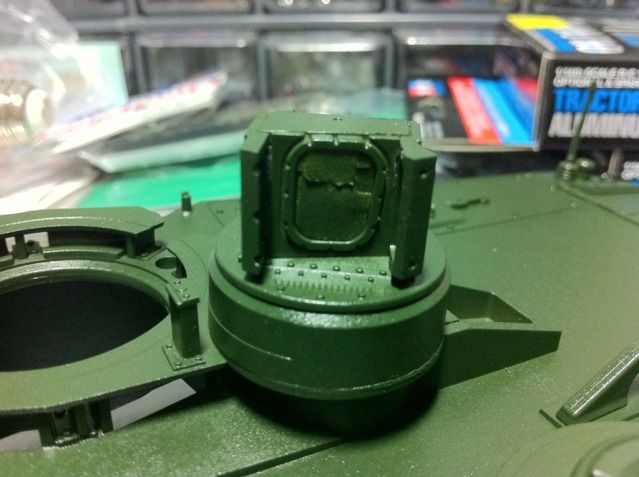

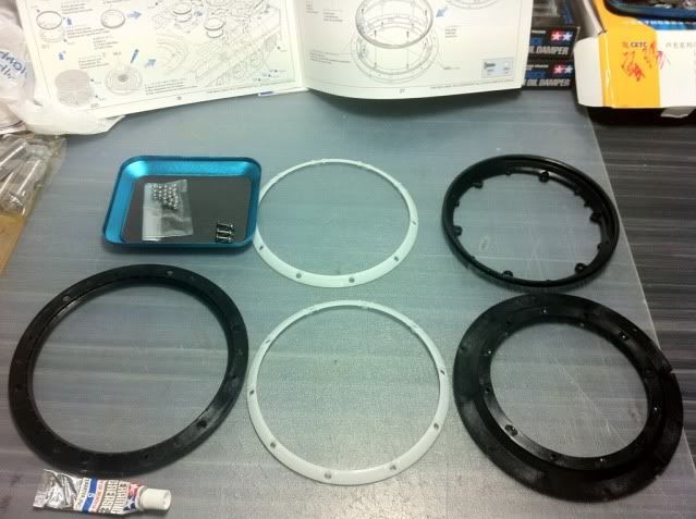

Finally have some time to work again on the tank,
1st, i fixed up the Turret Rings
Posted Image

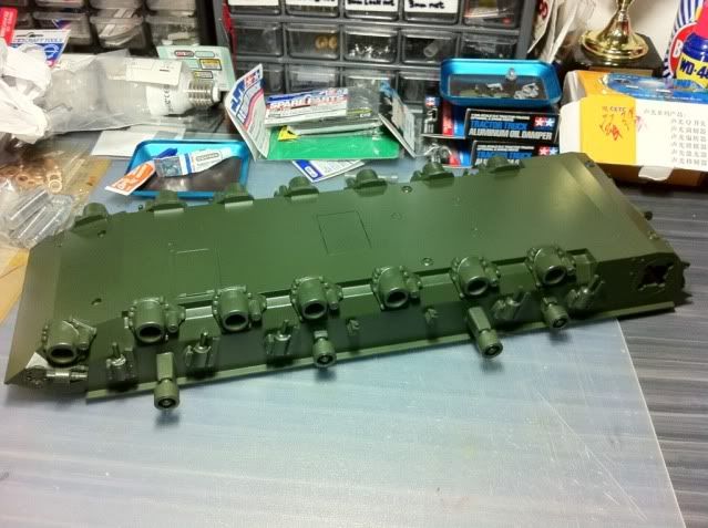

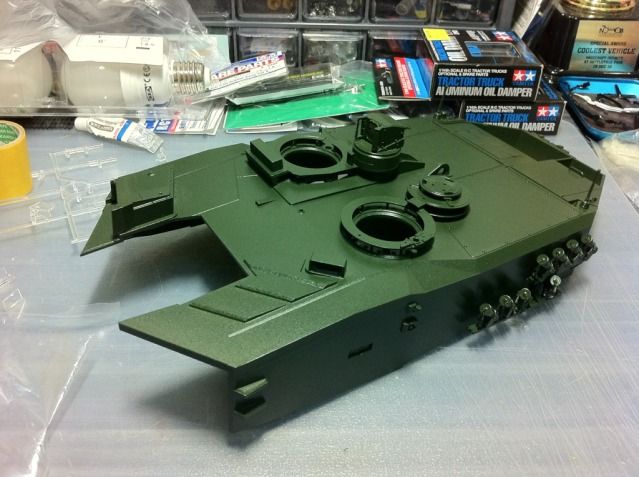

Next, i finally managed to put on some colors
1st, Lower Hull
Posted Image

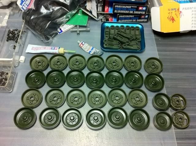

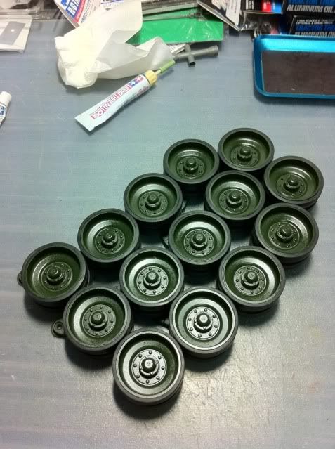

2nd, Wheels
Posted Image

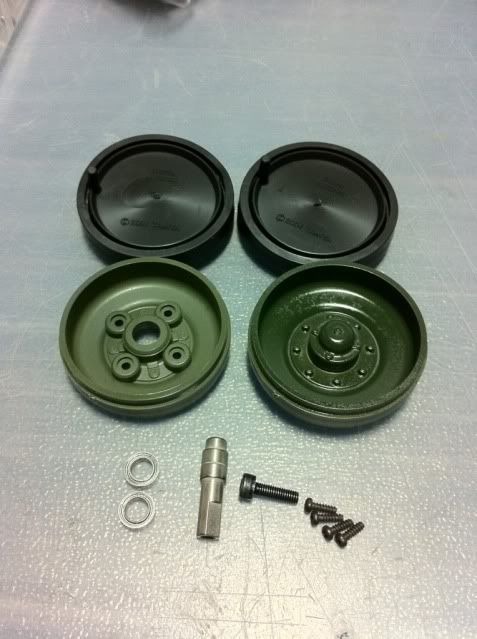

i only sprayed the outer wheel cos the inner wheel cant b seem when install together

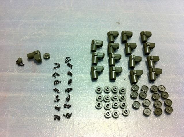

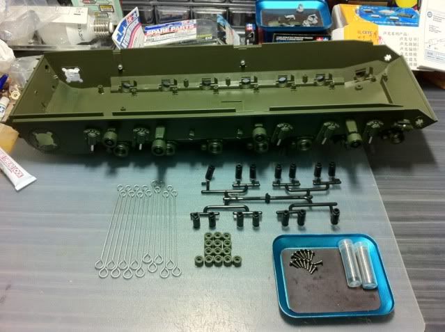

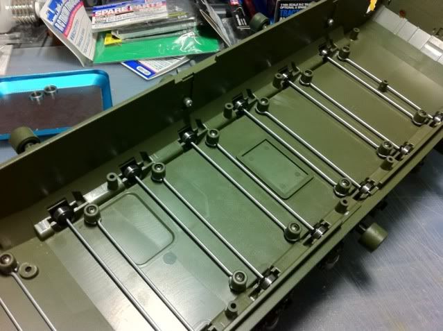

Next, i started the installation of the Torsion Bars and upgraded to ball bearings all round
Posted Image
Posted Image

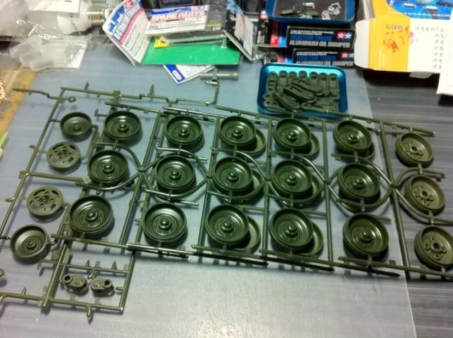

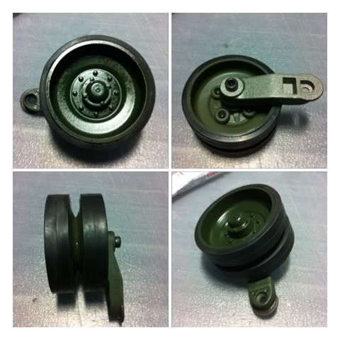

Next, was the road wheels installation itself. its such a PITA to have to cut out the road wheels rubber manual, doing the same thg over n over for 28 wheels, and putting them on the road wheel itself for 28 times.
this is only 1 road wheel
Posted Image

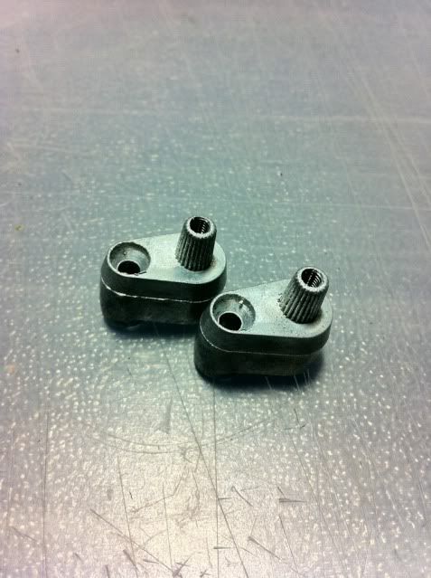

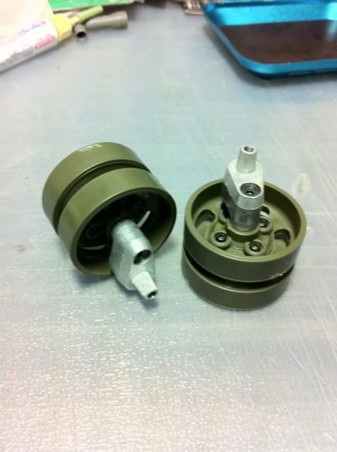

another 27 more to go......:mad: together with IMPACT metal suspension arms
Posted Image
After awhile....... :rolleyes:

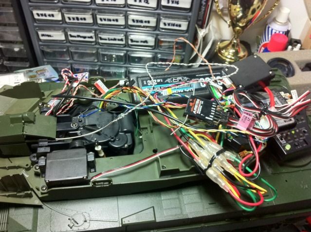

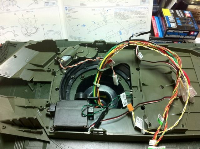

Had to open to cover to pull put the wires, was too short and kept too much inside.
Posted Image

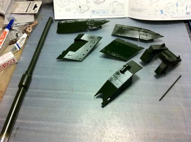

Some of the painted parts for today
Posted Image

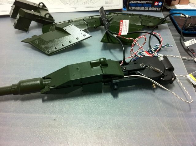

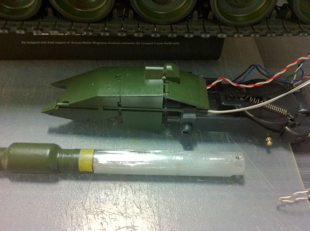

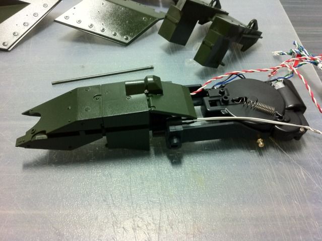

Started the installation of the main gun unit.
Posted Image
Posted Image
Posted Image

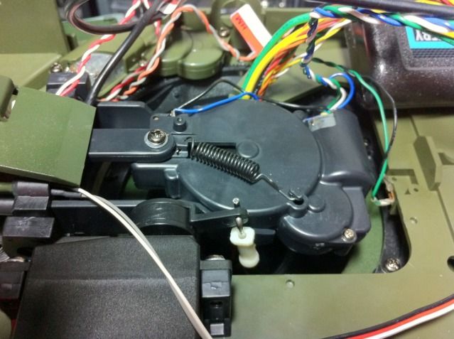

Then i ran into problem,
The painted lower half of the main gun was struck and the recoil action doesnt work.
I had to sand away the painted area.
Posted Image
After that, the recoil spring was over stretched and wont work anymore.
Looking through my spares, manage to find a stronger and better spring
Posted Image
Now, i have tidy up all the wirings.
Posted Image

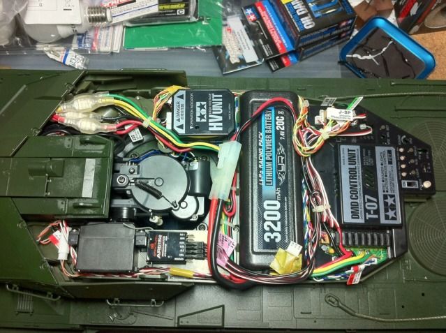

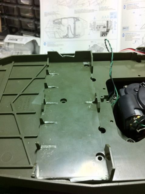

Ya, i tried with my lipo batt and its a tab too big, will have to sort out that 1st before tidying up the wires and closing it, thanks for the advise.

had to cut down/away part of the batt holder to fit in the lipo batt
Posted Image

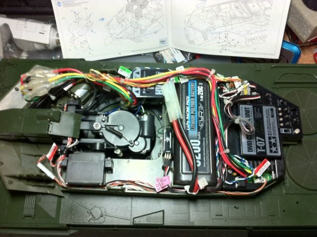

1st attempt to tidy up the wirings..might have to redo as the turret cant close properly near the rear.
Posted Image
at least it was better than before

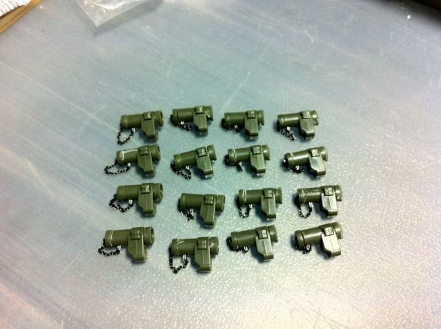

Smoke dischargers
Posted Image
Posted Image

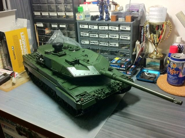

Posted 28 July 2012 - 11:49 PM

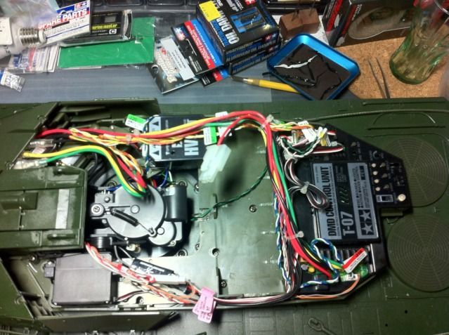

Redo the whole cables arrangement, this is version 2.0. Must say i am much happier with this layout, the hull can close properly. Just need to get a smaller batt and the space would be better.
Posted Image
This was before, the rear of the hull cant close properly.
Posted Image

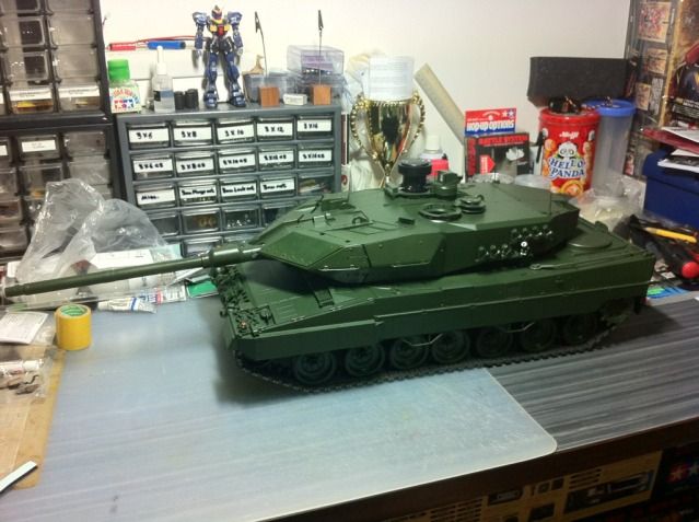

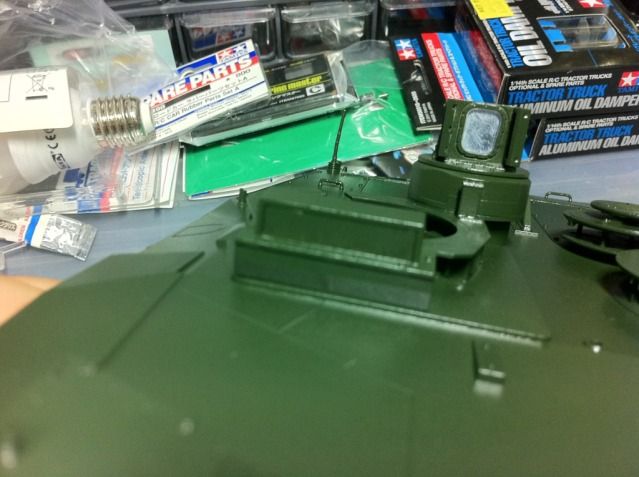

Hull paintng done
Posted Image
Lazy man style, masking of all the clear parts and simply spray.
Posted Image
Posted Image
90% completed, just some minor details like the spade,weathering,misc to add in, radio has been setup with the DMD and it was a BLAST for the test run. Will try to upload the video soon
