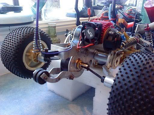

bahhh .... takes about an hour and a bit of alloy angel and some longers screws to mount front shocks on a frog , as forthe gear box , if you dont go and run a great big motor and replace the hex shafts with new ones or do a re re conversion to a cup and bones set up , you will have plenty of fun ..this front shock mount was made nearly 25 years ago , done with a hack saw and a file .
Posted Image
the re re set up that tamiya sell .. an easy fit both conversions can be done on the frog and the brat .. and you can fit a frog diff in the original brat gearbox , thats if it hasn't been changed already i

Can you tell me what rims and tires you have on your brat in the pics?
thanks, jeff

they are old traxxas '' eagle '' rims with proline mini pin rears and ribbed fronts , off a staduim race truck i had in the 90's , the fronts use a long axle and the rears use the round 5 pin drive like the frog etc . you can buy '' blue eagle '' rims as well but they are a sloped dish tyre and use the short axle .
i still have these rims as they where on my frog , not a brat .. that i raced as a srt back then .. i put a baja bug body on the frog but removed the big wheels and put sand scorcher wheels with alloy outters on it ..the frog is also full of '' 50 caliber custom '' alloy parts ..
