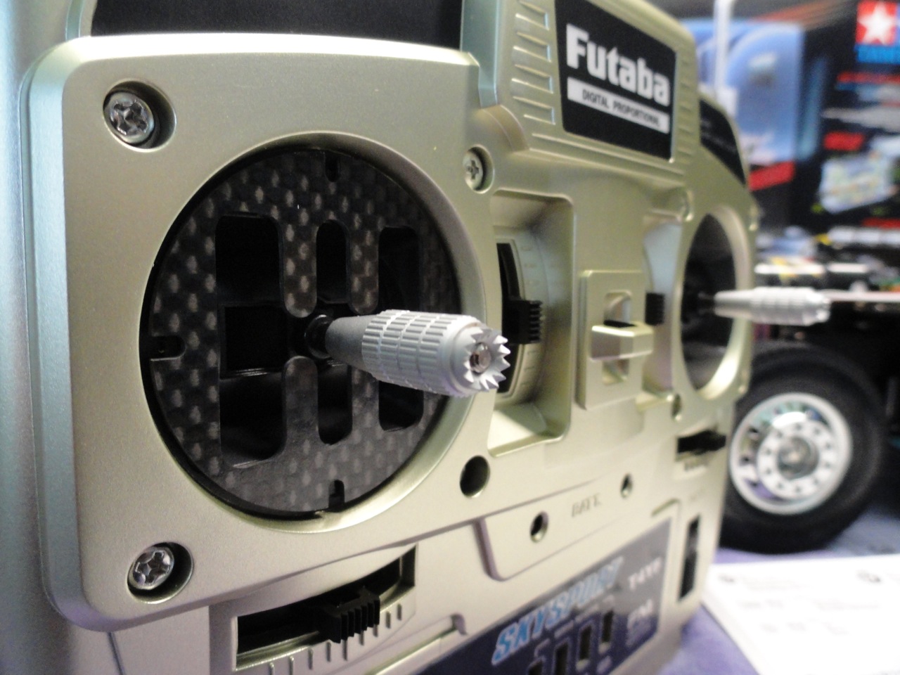

You can get shift gates for the left stick that make it easy to keep in gear.
Lots of them on ebay for the various radios. I got a carbon fiber one for my Futaba 4YF.
Posted Image
