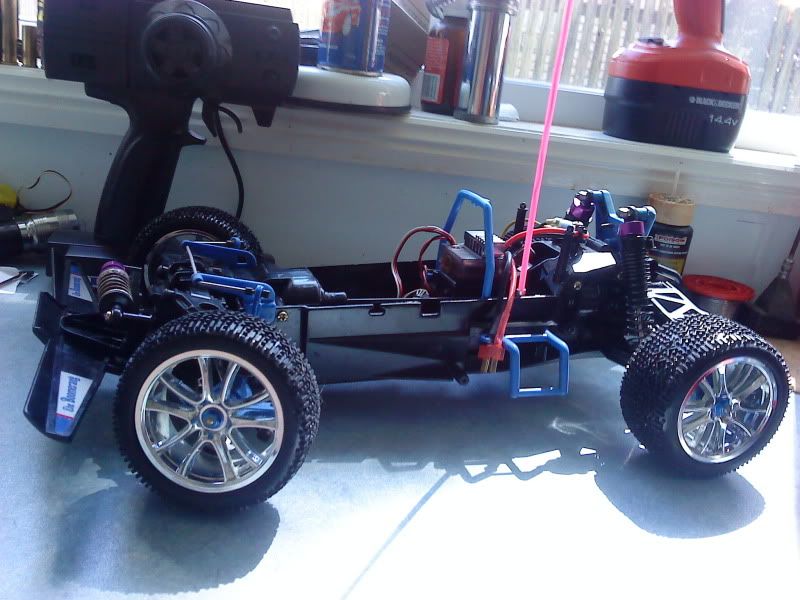

Take a look here,i have used them on my Fox.They work fine,quality is good. ;)
http://gpmracing.com...roducts_id=3625
I have also used  dampers from Yeah racing,but to be honest they're way to hard and dont really work fine. :(
http://www.yeahracin...ack-p-1877.html
