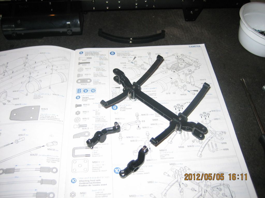

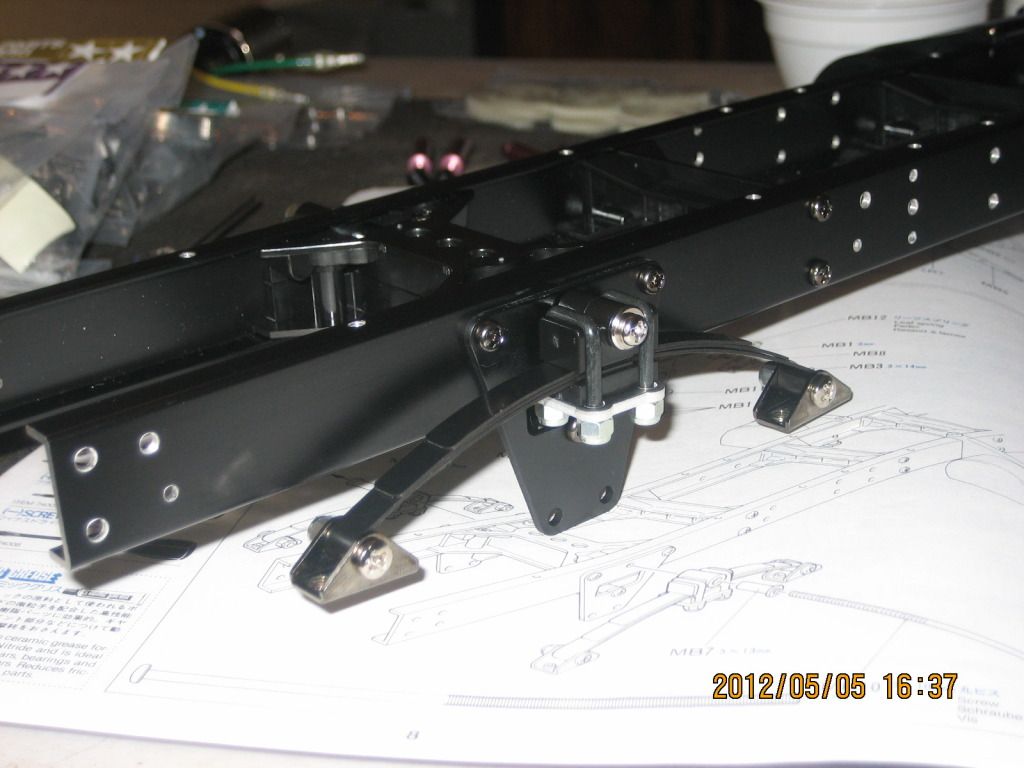

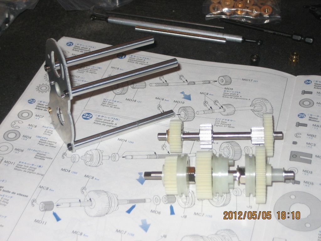

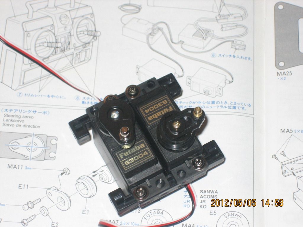

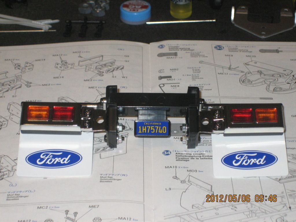

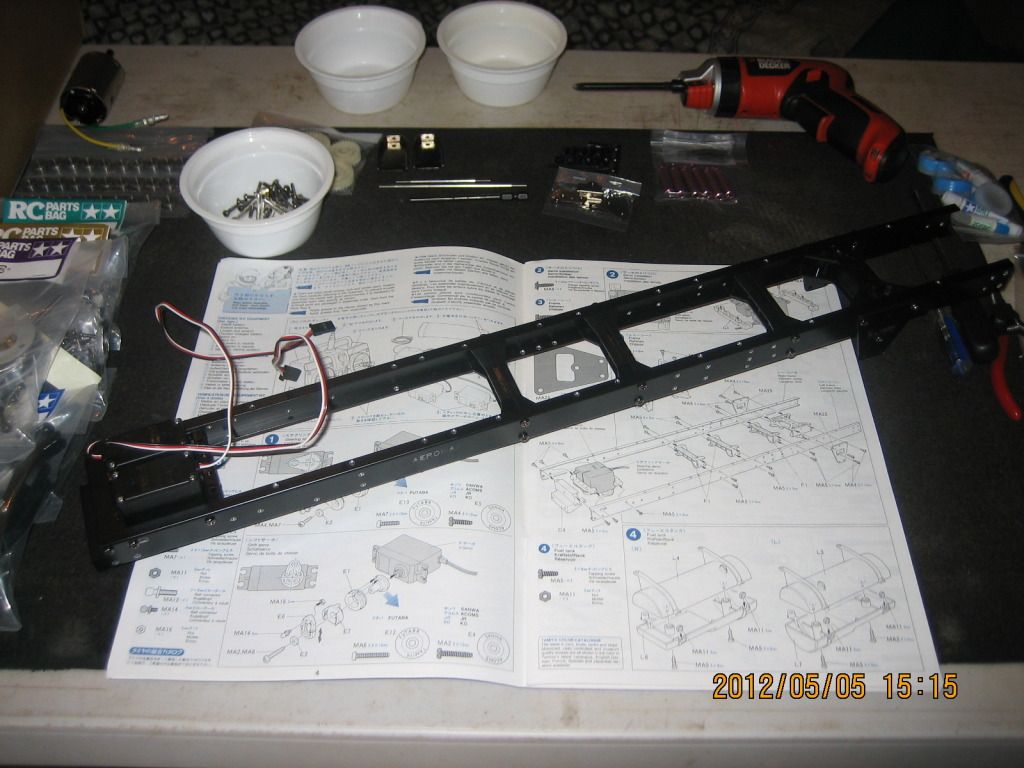

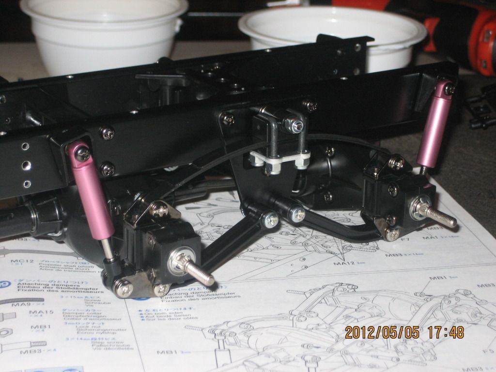

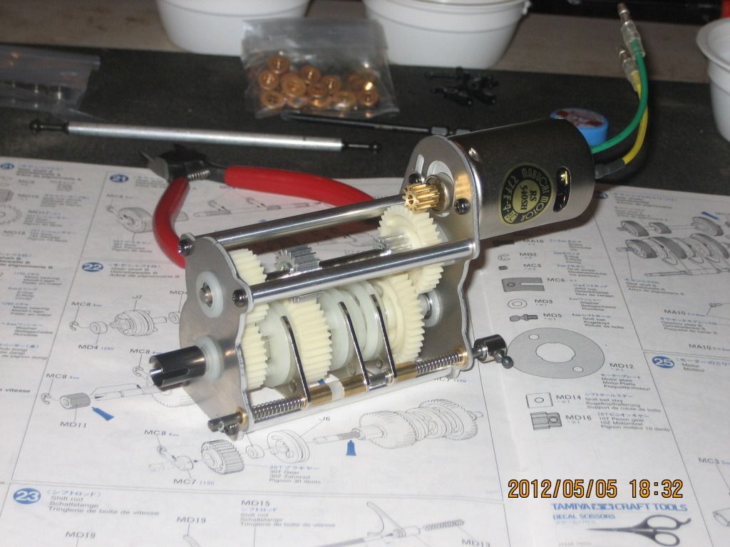

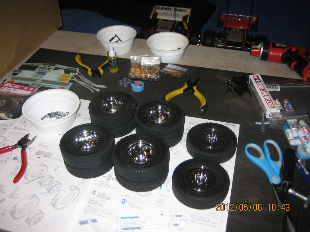

Still no MFC, and not even any paint yet :lol: , but decided it was time to crack it open and get up to my elbows :D
I still get a huge buzz from opening up a NIB, getting ready to start building
Posted Image
Posted Image
Futaba servos, to go with the 4YF
Posted Image
Man this thing is long, not much room on my table
Posted Image
Posted Image

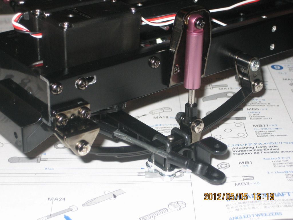

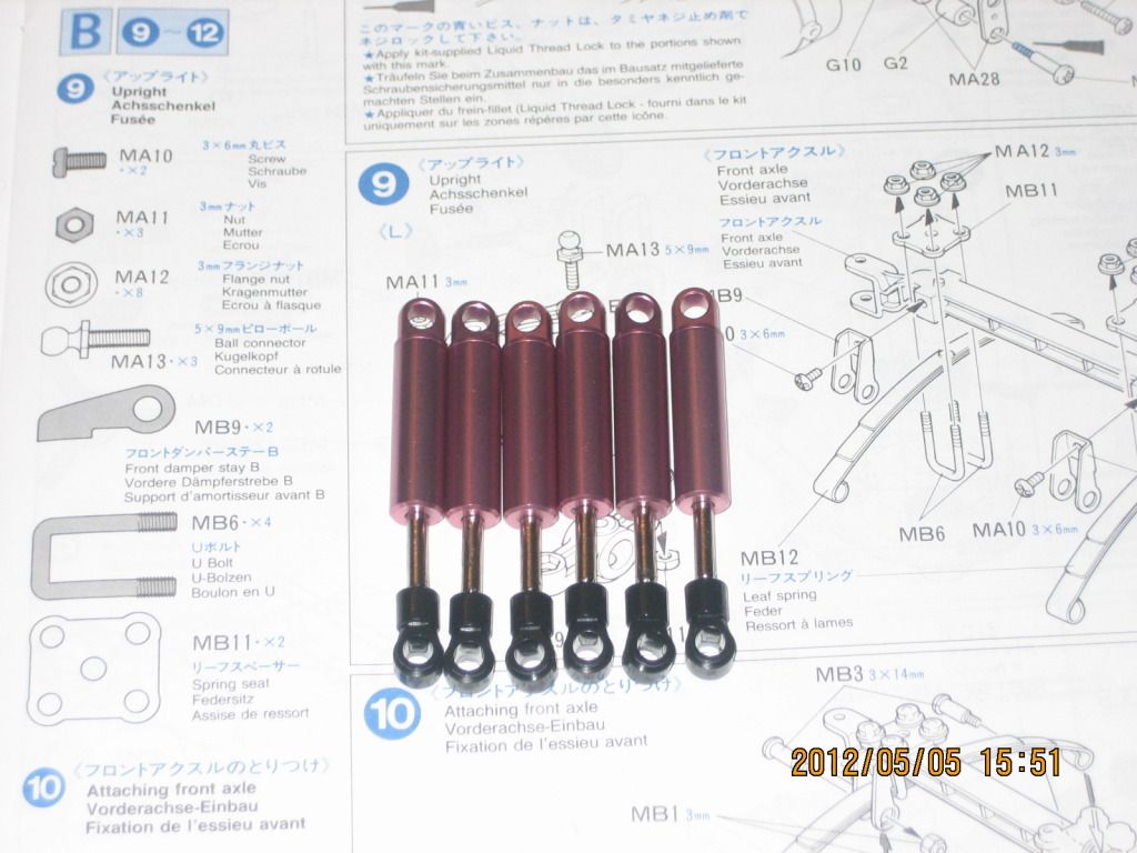

Shocks all built, not a fan of the anodizing
Posted Image

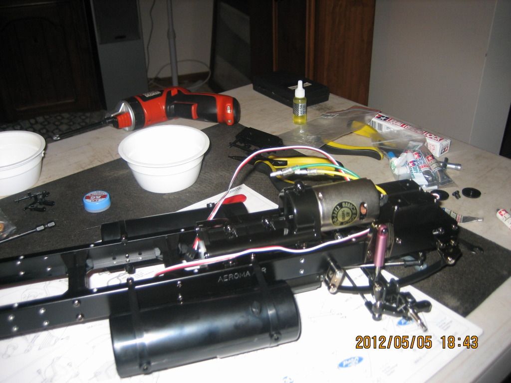

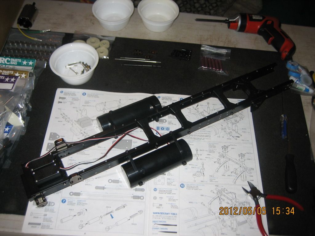

Front end progress
Posted Image
Posted Image
Posted Image

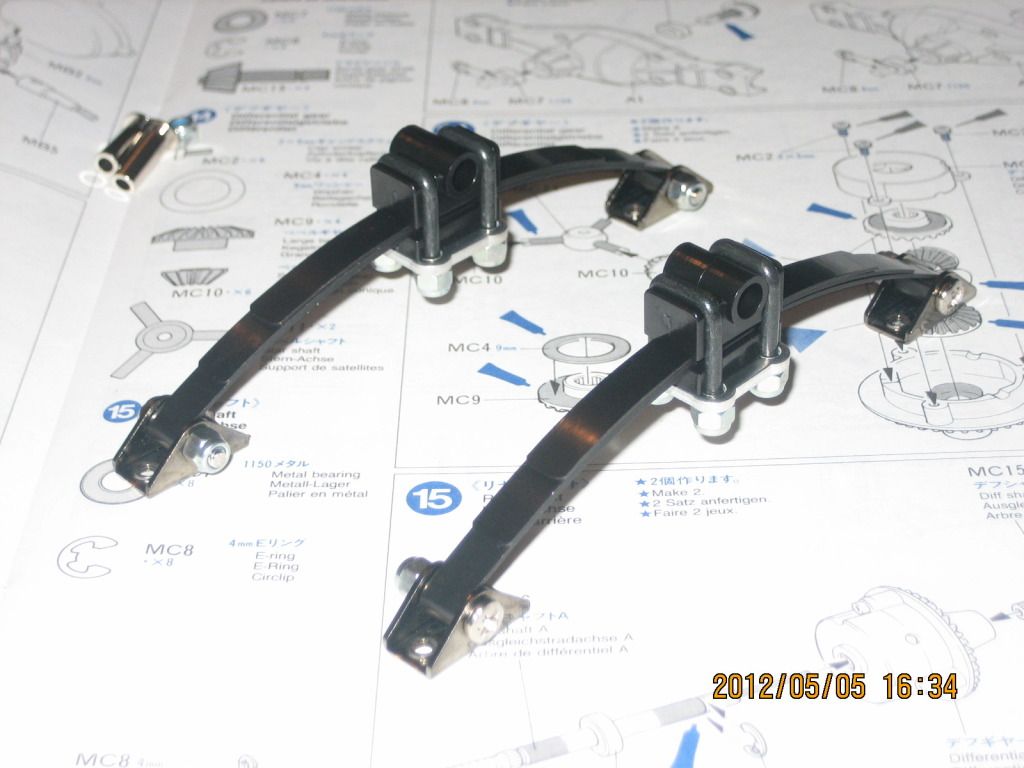

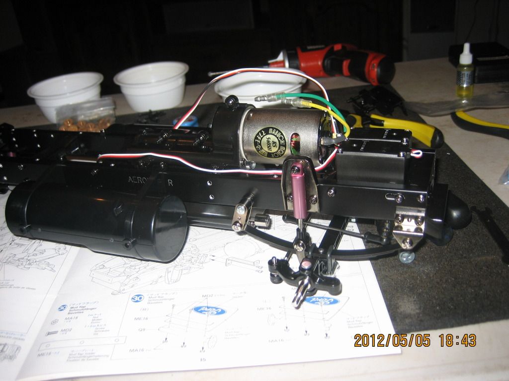

Rear end progress
Posted Image
Posted Image
Posted Image
Posted Image

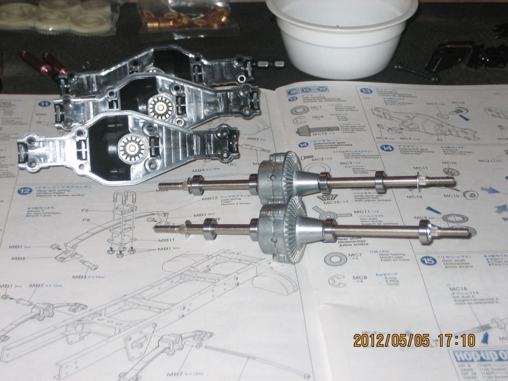

Gear Box
Posted Image
Posted Image
Posted Image
Posted Image
Posted Image
Thats it for now, heading away for a few days with work, but stay tuned

This is great!!!!! Now I bet you can appreciate the awesomeness that is the Tamiya Semi!
I see your kit appears to have come with ball bearings? I also find it interesting your fuel tanks are black instead of chrome. I guess you paint those? (EDIT: I see, looks like there is a cover for them...)
I hated the pink shocks also but you can't really get paint to stick, so I wrapped mine in chrome decal. Works well.
I may be starting up a Scania R470 build in 2 weeks when I get back from a vacation so it could possibly be a truck build fest!
Cheers!!!!
Skottoman
Cheers!!!!
Skottoman
I'm very concerned, the enjoyment of this kit may make me want to appreciate it over and over, meaning more kits of course :D
The bearings were ordered separately, as far as the shocks go, I have heard of anodizing being "stripped" back to normal aluminium, so I may research that a little further

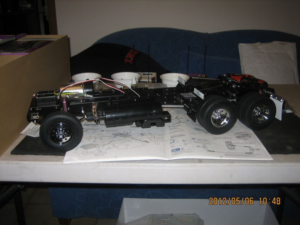

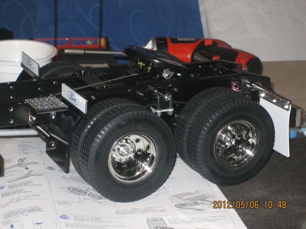

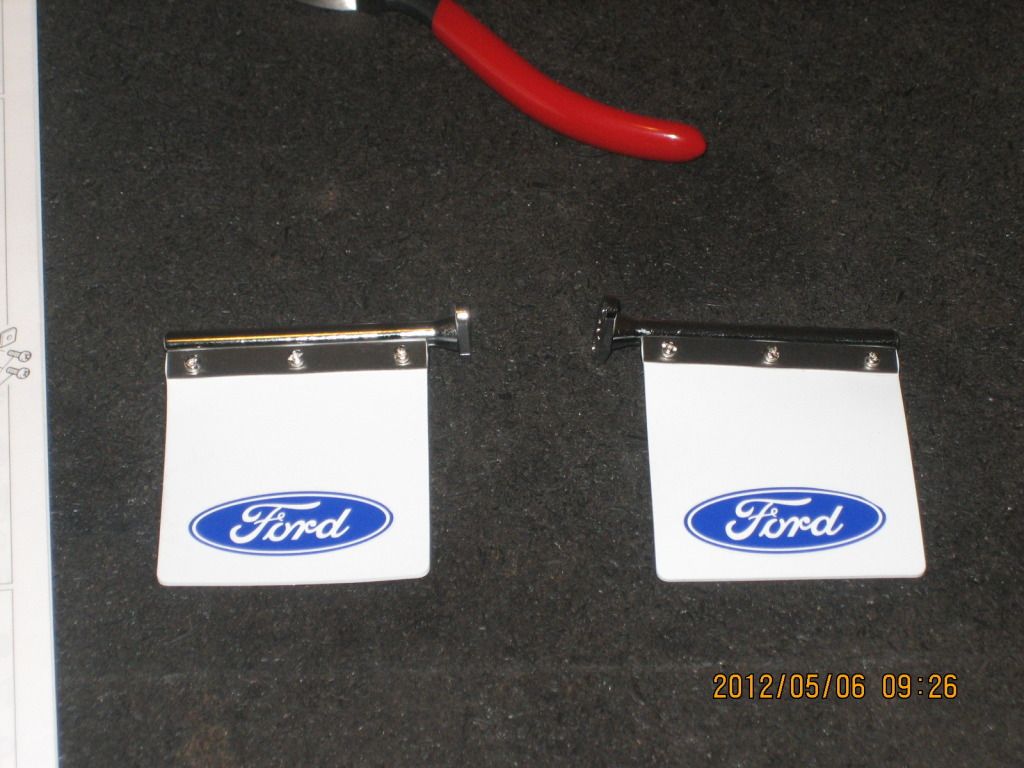

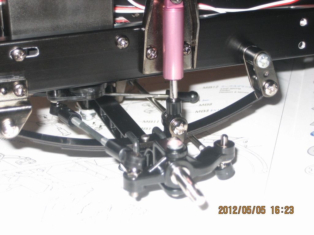

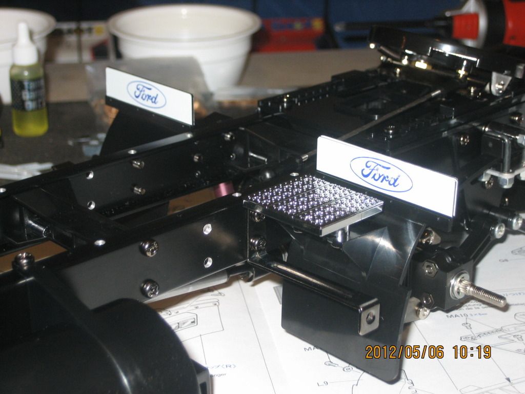

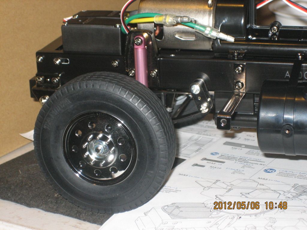

Decided to get a bit more done this morning, hard to stop :rolleyes:
Posted Image
Will need to do some disassembly for lights already :D
Posted Image
Posted Image
Posted Image
Bypassed a couple steps to get it sitting on it wheels
Posted Image
Posted Image
Posted Image
Posted Image
Think that will be it for the chassis until I get the MFC, will stop by the LHS soon to get some paint and get the body detailing happening.

Looking great so far mate! :) Yeah that is the thing with these, they are addictive to build. I so want another one!
You should be able to get the anodising off with oven cleaner, I haven't tried on the actual semi truck shocks myself though.

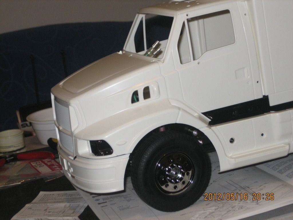

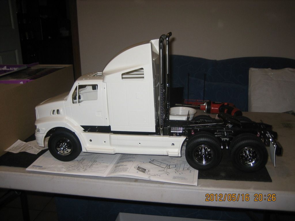

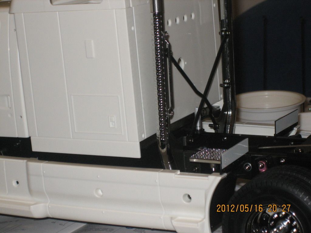

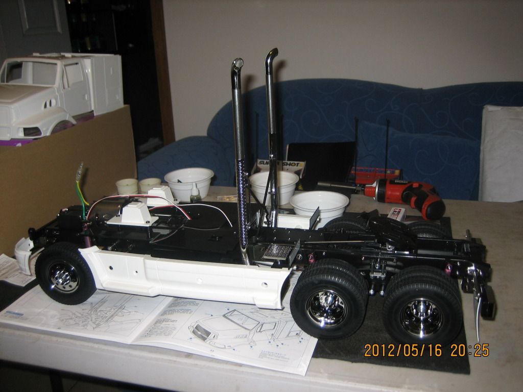

A bit of premature assembly to get a feel for the size of this thing
Posted Image
Posted Image
Posted Image
Posted Image
Posted Image

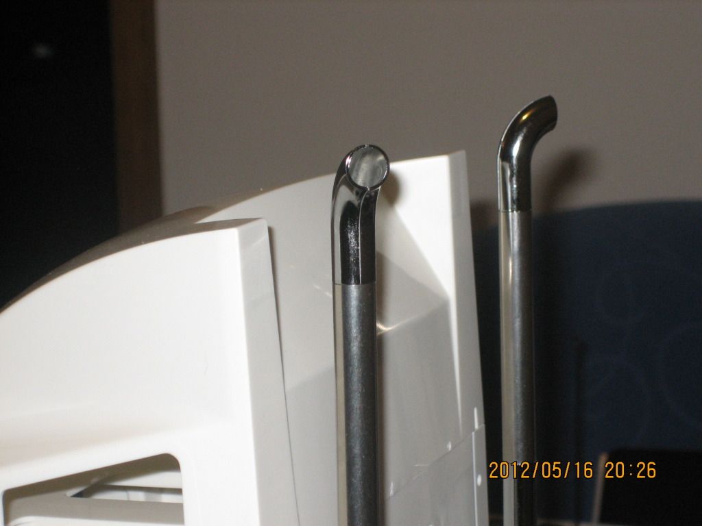

You will probably notice the smoke stacks at 45 degrees rather than straight out the back as per the kit instructions, I think it looks better this way, and perhaps more common to what is out on the full size roads. Promise I'll get some paint soon.
You Name It......And I Want It!

Very Nice!
I still have to get one of these..... must stop buying buggies :)

Looks massive! Aren't these just great to build? Doing a superb job...
Now the real fun begins... the body and detailing!
