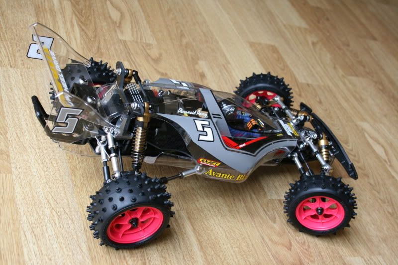

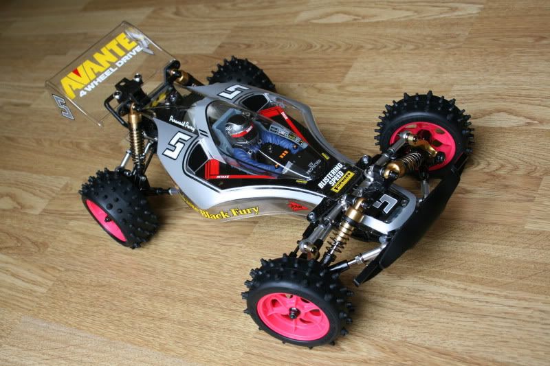

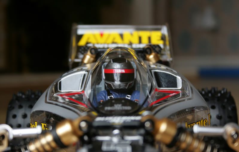

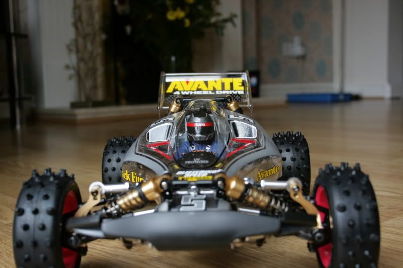

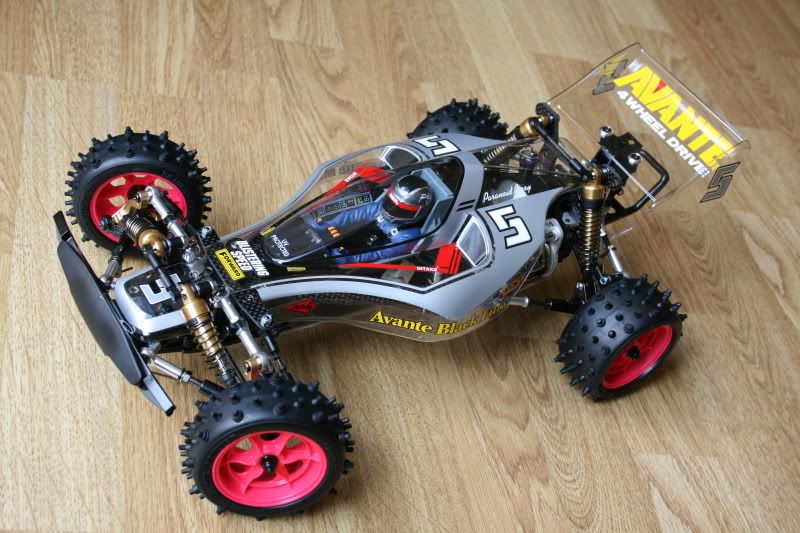

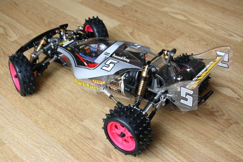

Well as its nice out I got the good camera out to snap some shots :P
Posted Image
Posted Image
Posted Image
Posted Image
Posted Image
Posted Image
