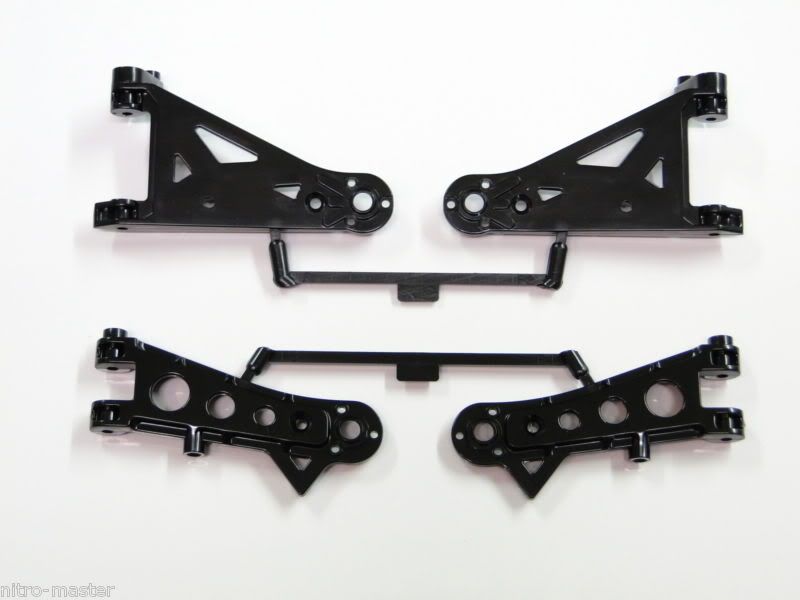

The new Super Shot differs from the old one... It is basically has the same changes that the re-re Hot Shot had over the original, plus a few more changes to parts.
* Chassis upper access hatch
* A/B rollcage parts have extra support struts for rear wing
* Dogbone drive shafts and axles/joint shafts are same as Hot Shot re-release, and original rear axles are black, re-re are silver
* Prop shaft/prop joints are now dogbone type, same as Hot Shot re-release
* Large E clips in place of C circlips for gearbox joint shafts
* Gearbox parts have deeper recess for joint shaft bearings to accomodate larger E clips
* GT Tuned instead of Technipower
* Generic sponsor decals
* Window netting is different, and is held on with black zipties instead of enamel wire
* Rear shock tower is new thicker material instead of FRP
* Rear understay lower shock mount is four-piece part, original was (partially factory pre-assembled) 2 piece part
* TA02 style steering knuckles with hex headed ball connector for upright instead of the flat headed one
* Original front understay lower shock mounts were dark metal colour, re-re ones are black and "L" and "R" stampings different
* No tab to cut away on the lower front suspension arms
* Urethane bushings in gearbox joints and prop shaft
* Sponge tape in the battery compartment to hold the racing pack battery in, and the small aluminium battery post is missing
* Re-re includes plastic antenna and antenna holder option
* Re-re includes rubber cover and dust seal for receiver switch
* Unitized thrust bearings instead of thrust washers
* Screws to mount steering servo have integrated washers rather than separate washers
* Shorter screw pins have different screw head
* No rubber bag for motor
* OH&S stickers (Ooooh! Look out! Moving parts!!!)
* Re-re has no resistors on rollcage, not even dummy ones
* Re-re has the black gearbox guard from the re-re Hot Shot

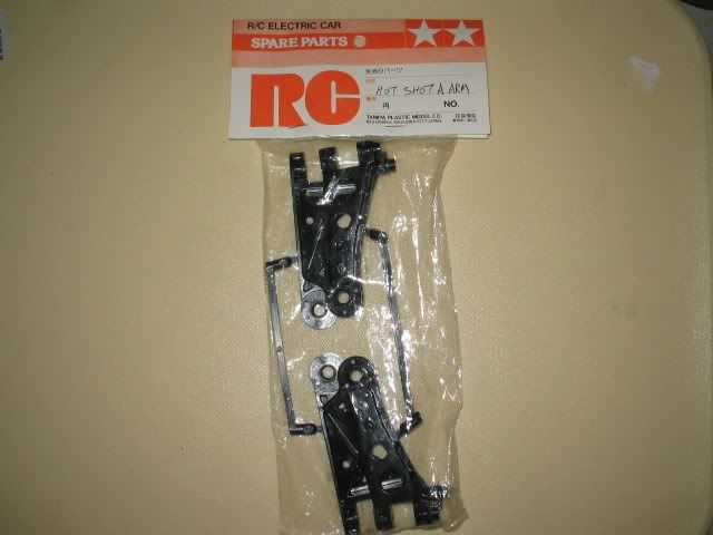

The parts that are unique to the Super Shot were expensive (body set, wheels, underguard) because they were both rare, and there was a fair bit of demand for them. The demand is still there, so prices will still be at a premium, and there are enough changes to the Super Hot Shot that original parts eg decal sets will still be rare and expensive. JR-RC was selling parts for a reasonable price, but resellers seem to have got a hold of a fair chunk of these popular parts and marked them up, which is why the prices appear to be creeping up again.
If anything, re-releases tend to make finding original parts much more difficult.
The suspension parts for the Super Shot will continue to be expensive, because people will want to buy them to hop up their Hot Shots. That's why Super Shot pressed parts bags were so expensive.

Actually there IS a way to differentiate between vintage Hotshot 2 F parts and those from 2007. The 2007s now have a tab on the moulding sprue whereas the originals did not.
Original
Posted Image
2007 (re-release)
Posted Image
The actual parts themselves though are identical, so they would have to be still on the sprue to know which era they came from.
Also confirms that RA1028's set are the real vintage deal.

Nice one with the tab Andy, seems to be a dead cert of distinguishing them (providing they are still on the sprue as you mentioned).
