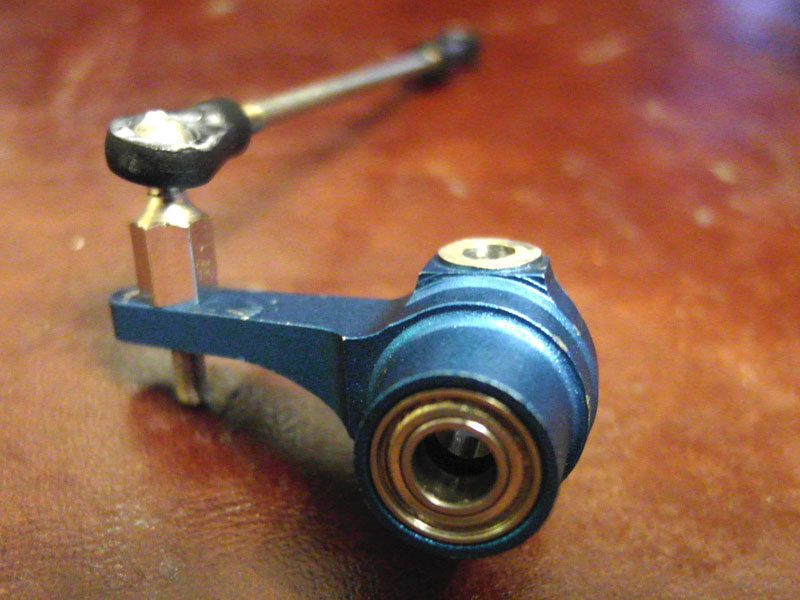

Bump steer is pretty shocking. However, I've just looked at the photos and it looks like I can improve this by swapping the two sides over, and putting the ball joint in the other way.
Can't believe I didn't see this before.

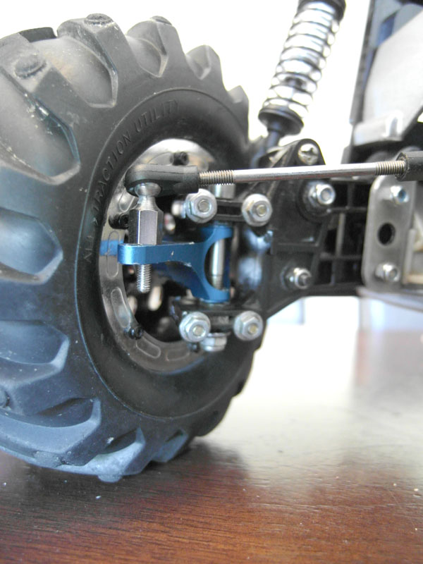

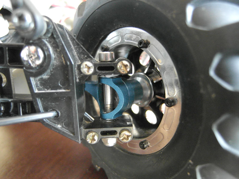

I've now managed to refine the front axles to eliminate bump steer, and remove any wheel movement. Originally, the holes in the uprights were slightly larger than the original MB pin, so I've changed this for a 4mm x 40mm half threaded rod, and and a standard Tamiya locking nut. I had to open the upright holders hole a little, and the upright, but they not fit securely and have no flex.
I've also now flipped the upright, and am using a longer ball joint, this has lifted the pivot up quite a lot. The tie rod is nearly horizontal, so hopefully bump steer has been eliminated.
