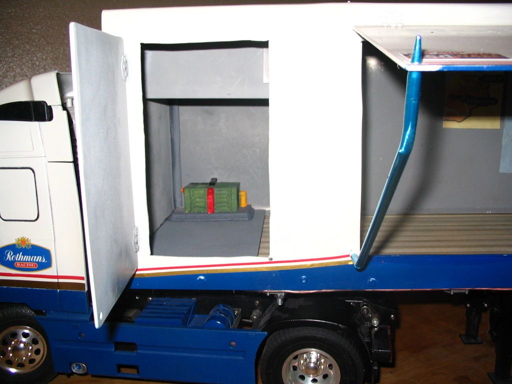

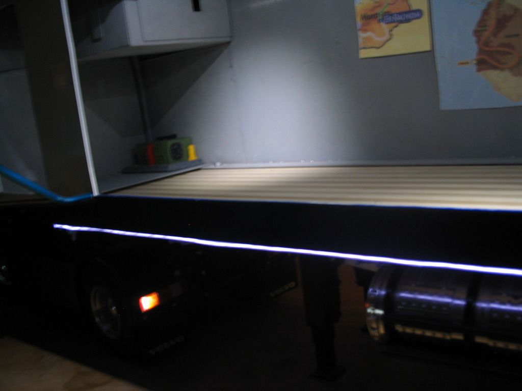

This is the corner with the generator and power lines.
Posted Image And with the lights on, There's a lot more room in there for a second car or the dancing girls and wet bar. Maybe it's a good thing I took the couch out. I still have some finish stuff to do but at least the electrical is all done.

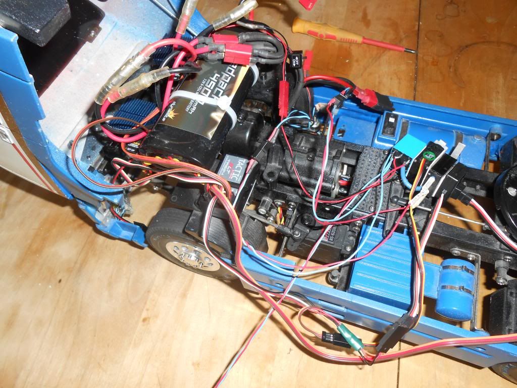

Ok. I'm finally prepared to fix the problems with this one. They're all power and control issues that sounded good but didn't work so well in reality.
The truck motor is too fast for it to really be driven.
Any movement of the sticks for the gate causes problems so it needs controlled differently with a way to turn the gate on and off.
Battery issues, too many in all the wrong places.
The truck and trailer are too intermixed with no good way to seperate them.
My ideas are a 55 turn or 2800 kv brushless for the truck, 6 channel radio with the 959 on something seperate, one channel to shut off the gate ESC and interior lights. truck to have all the power radio gear and ESCs lastly is a single plug for wiring to the trailer.
It sounds easy enough but it's going to be tough to make this into a real runner and not just a shelf decoration.

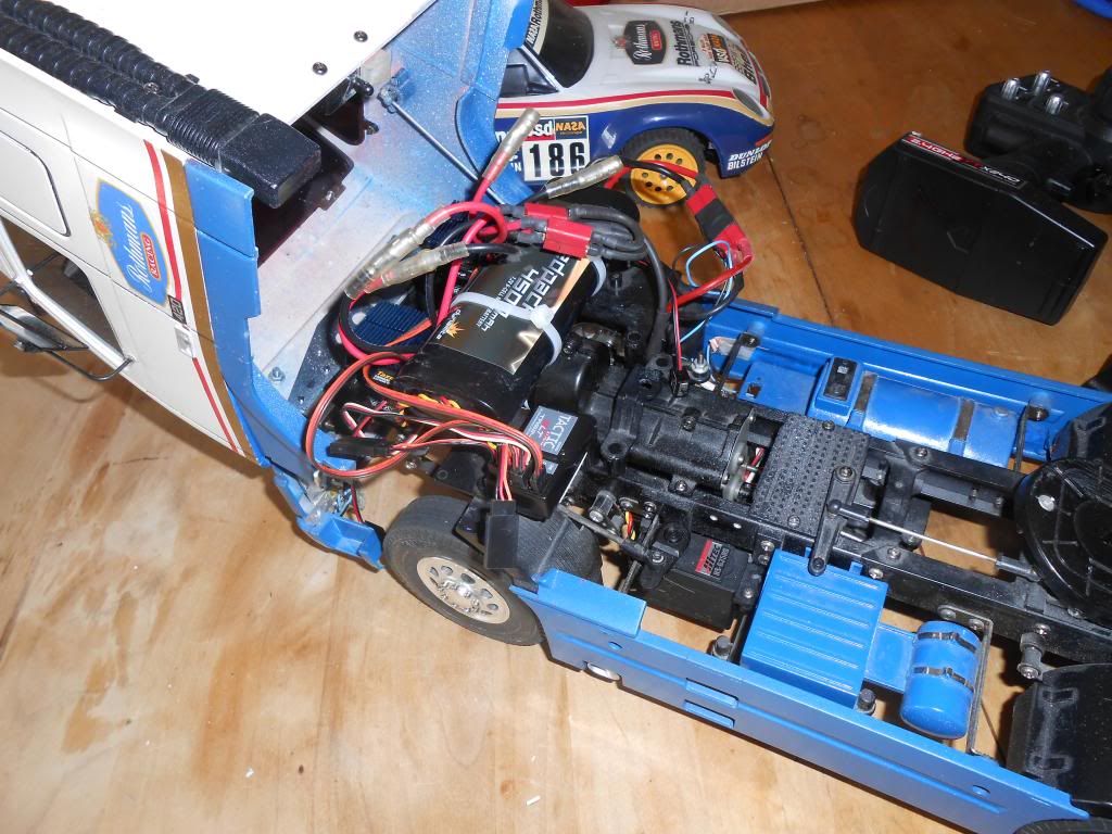

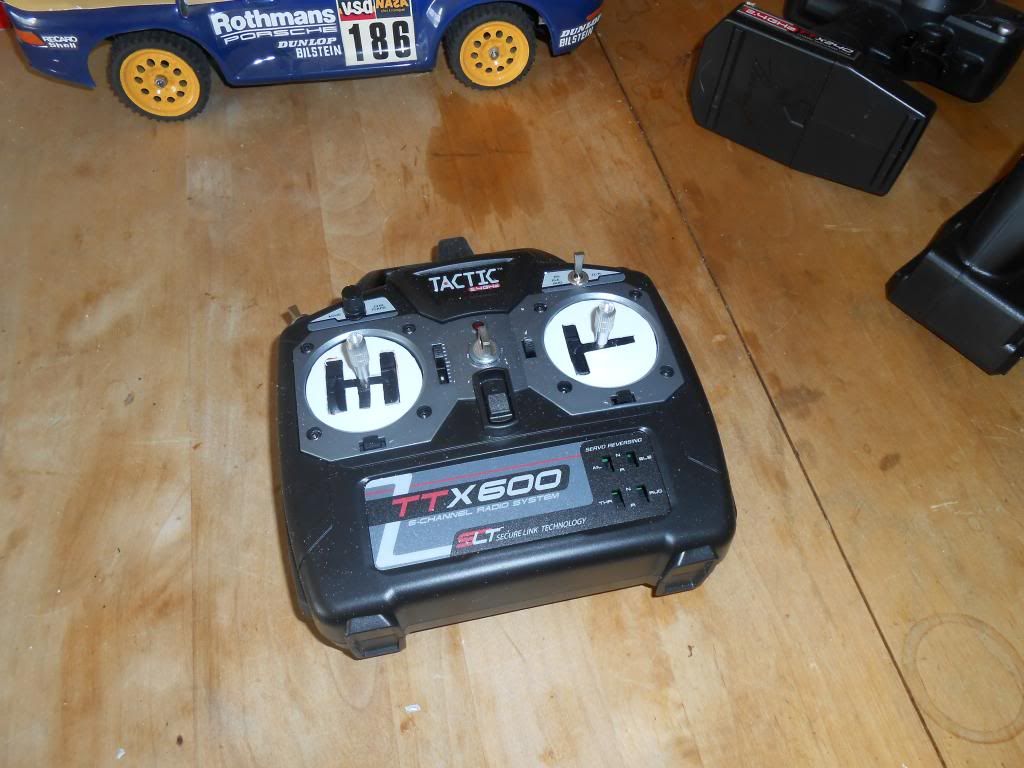

To start I went from the 4 channel to 6 and made it self centering on the throttle. I made custom gates for both sticks since one will have some input on the lift gate when it's attached.
Posted Image
I put a 5000 MAH under the chassis and a 4500 in the cab. These are paired together and all functions fed from the cab. Both ESCs are in the cab and with the added weight a high torque servo is now used for steering. I also replaced the 17 double motor for a 55 turn. I'll be tidying up the wiring once it's all in.
Posted Image

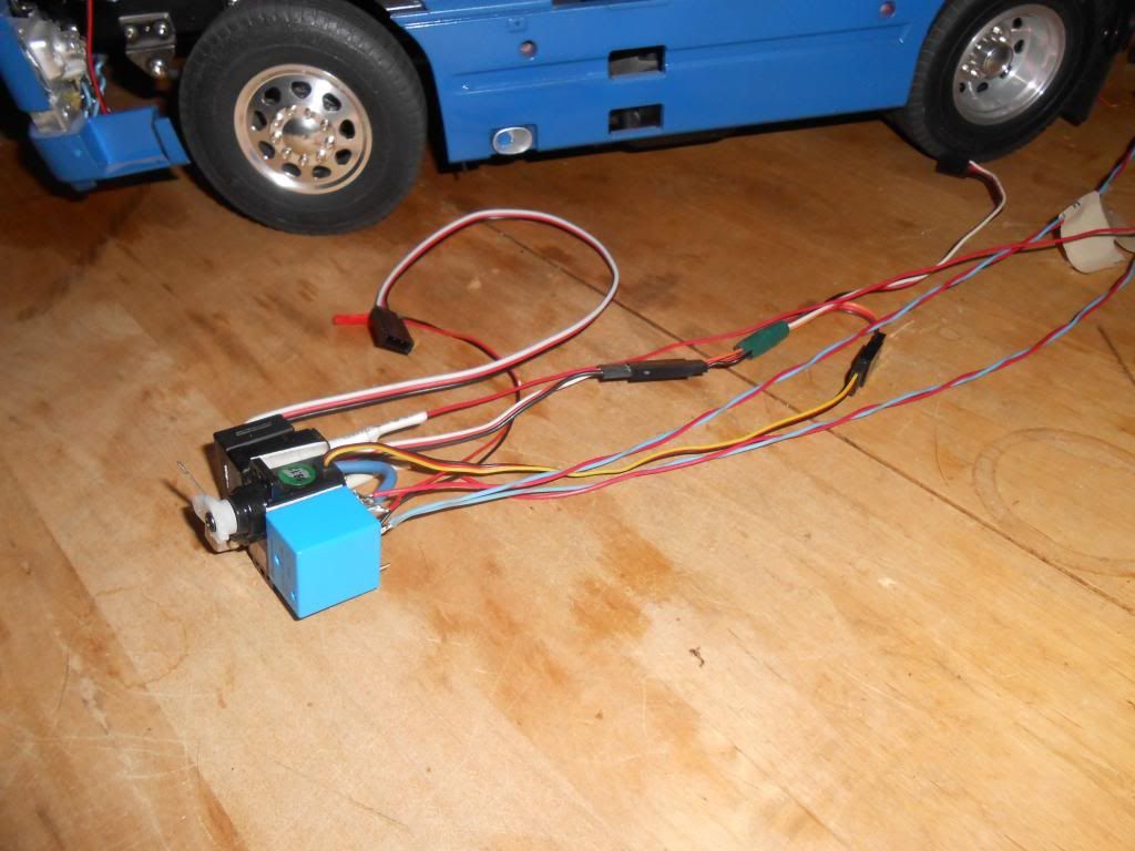

This is a bit of what's needed to switch back and forth from lifting trailer or running truck.
The truck and trailer have full battery voltage lighting for headlights and rear markers on seperate circuits that used to be able to feed in either direction.
The trailer has low voltage flourescent side markers that have to feed from a reciever.
There's also high volt overhead lighting inside the trailer that used to be only controled on the trailer side.
The gearbox for tailgate lift has it's own ESC that needs to be shut off when not in use. It used to be active all the time and it's why I was always snapping cables.
I used to have dual recievers to control from both the truck and the trailer independent of each other for specific functions.
To clean up this mess, I went to a single reciever with the truck feeding power and in complete control. Getting control of all the lighting and the second ESC was why I kept putting it off.
I want to be able to have the lift ESC off and all exterior lights on or switch to lifting trailer mode with only the interior trailer lights on and the second ESC enabled.
I decided on a small D to A converter made by HPI to switch over the low voltage lighting because it can handle more lights in the future. Then a micro servo to actuate a lever switch for the high volt lights and ESC enable via a small relay.
Here's a picture of what will be this things electro mechanical brain. I've tried it out seperate from everything and it works but there's a lot of things to tie into to check it on the truck.
Posted Image

It's tied in and works as advertised. I did it in a modular way with connectors everywhere so if I want or need to remove it, it'll be easy. Speaking of easy, all I have left on the truck side is to put it all under the cab. It looks like 5 pounds in a 2 pound bag to me. I don't think the D style plug will handle the amp load for the lift so that has to be sorted out. Here's my latest rats nest.
Posted Image

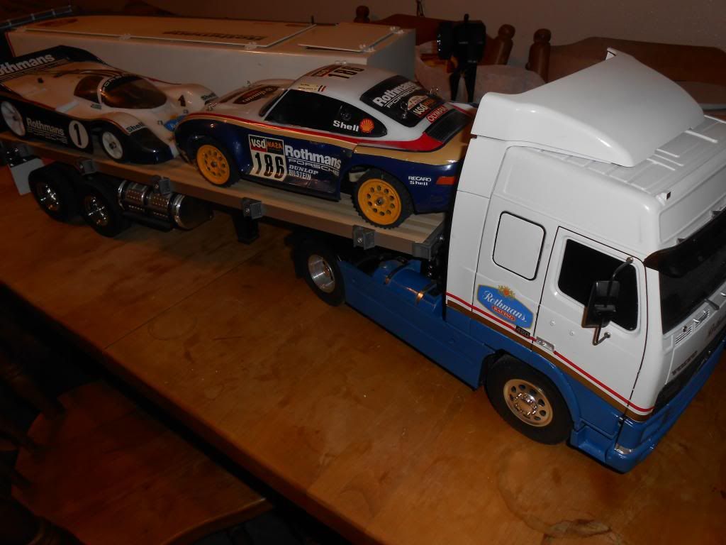

The original idea for this was that it could be a flat bed too. That idea fell apart somewhere along the line and I really wanted to be able to drive it once in a while. With the truck as a stand alone and everything feeding from it, the box can be removed with 4 easy to reach bolts. I wanted to see this anyway.
Posted Image

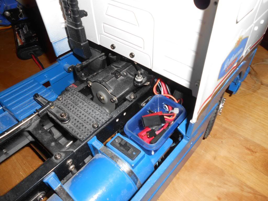

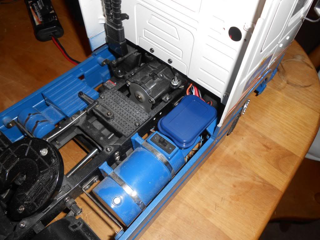

Posted 06 April 2013 - 04:41 AM
I didn't realize that finding a good little box was such a task. I've looked everywhere I could think of and finally found a travel box for safety pins at a sewing store. It's like the smallest tupperware you'll ever find but the size was right.
Posted Image
Open it's mostly hidden under the front edge of the trailer and closed you can't tell it doesn't belong there.
Posted Image
