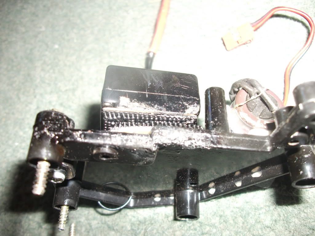

This is the switch wire and the servo wire where it leaves the ESC
Posted Image
The top deck escaped serious damage with a little heat and smoke damage to the receiver and tray.
Posted Image
This was much more than letting the smoke out, this was a full on electrical fire as you can see from the damage, I know it was second hand so I don't really have any comeback but if I had bought this new I would be even more annoyed. I suppose I am going to have to pay out more money on this but at least I will get a warranty this time.

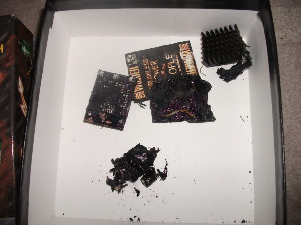

Posted 05 September 2012 - 06:43 PM
They want me to send it back so,.....................
Posted Image
Posted Image
Posted Image
#56 wolfdogstinkus
wolfdogstinkus
    Member
  • Members
  • PipPipPip
  • 1688 posts
  • Gender:Male
  • Location:Northamptonshire, U.K
Posted 05 September 2012 - 07:03 PM
I wish I had it on video, it was a sight, lol, and it stinks, only problem now is I gotta send it back to castle, how is it going to get through customs? when it stinks like a half burnt burnt thing.
