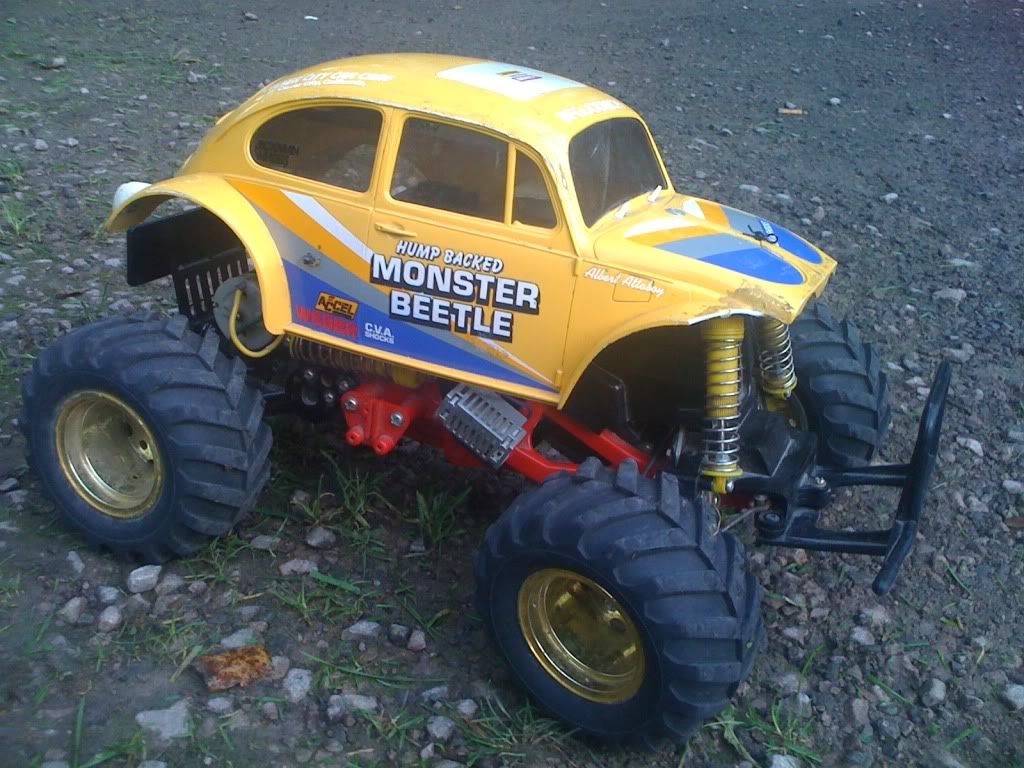

Here's one I just picked up today in a local ad. Quite the opposite of yours: Excellent original body with undamaged nose cone (thats a first for me!). Even the gutters are perfect! No cracks anywhere, but no idea why its painted primer gray. Chassis is pretty rough, rusty, and no shocks. The owner gave these aluminum ones but they'll never fit a Monster Beetle. Rims are excellent though, but only 3 tires, and 4 baldies. Cant complain for 40$, I think I could sell the nose cone and lights for that amount.
What do you use to strip the body, brake fluid? Will it work on primer? And what is plasticard?
That's one GREAT purchase. I'm sure if you sell the shocks you'll get enough to cover both, the purchase the Monster Beetle itself and some original shocks, too. Brake fluid will take off all the stuff. Just cover the body with some using a brush for a couple of nights and then it all will start coming off. Whatever you hear, don't dip it, because not only the brake fluid is expensive and you'll need a lot to do that, but also because sometimes it does affect small hairline cracks and such, making the body less resistant to impacts.
