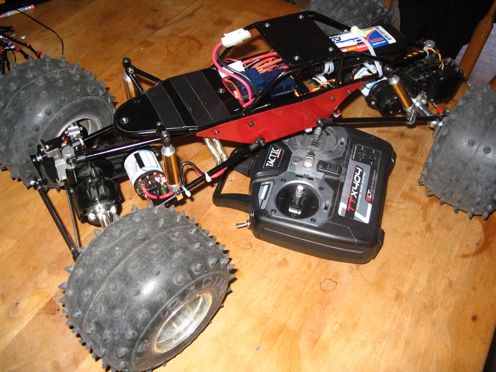

I had it out and it's great fun. Climbs about anything and with a bit of dig it goes down steps real well. It has a top speed around 10 MPH and the turning radius is about 4 feet. I'll make a cover for the second battery or find one with enough amps.
Thanks for pointing me in the right direction, I'd have given up something I'd later have wanted otherwise.
At some point I may go with the new Tazer brushless for this. I looked at them and their low KV like 2000 to 4000 and 125 dollars for the combo. The kicker is that they went waterproof and I've never had anything but great luck with them in the past.

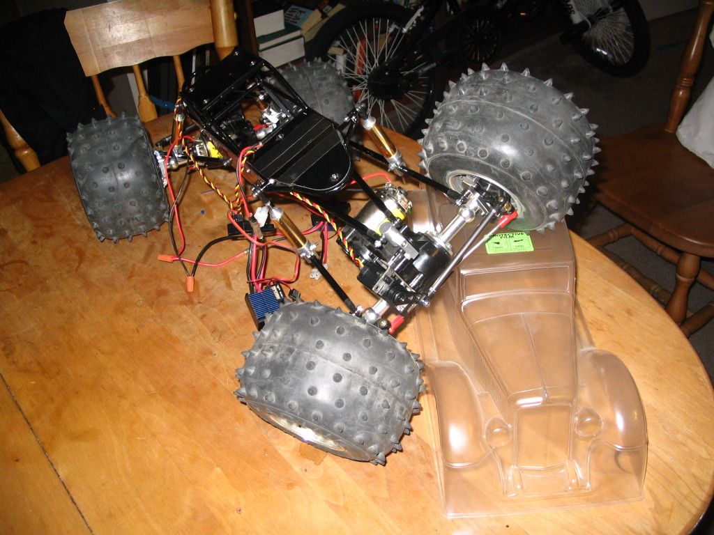

Anyway, here's a picture as it sits ready to run.

Looks even better from that angle - the chassis looks in great shape
So how did it go?
I far prefer watching droop rigs as they just sorta 'slither' over stuff - far more elegant than regular suspension.
Good score on the radio too, it's a shame the manufacturers don't got behind crawling more - the only stick set I've ever had with springs all round was a cheap Acoms one which was 'big rig' compatible.
For batteries, have a think about LiPo - a couple of smaller backs dotted around the chassis would work great - another good reason to get some axle braces - bit of alu sheet too and you got an axle-mounted battery plate!
You should see what sort of run time you get with one pack too, I used to get 20 mins out of a 3000mah pack no problem.

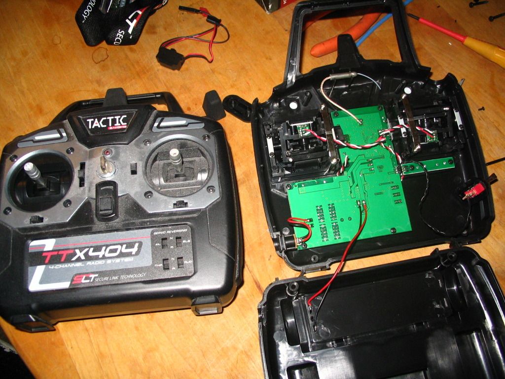

On the tactic 404 transmitter there is a round serrated piece with a metal spring bar that has a slight point that makes the stick ratchet and stick in place.
If you cut the round notched part flat 90 degrees to the stick and turn the metal bar over so it's basicly flat you now have a have a cam and a spring bar to make it return to center at the flat. There is a fixed and adjustably mount end for the spring bar that needs to be trimmed down about 1.5mm on the fixed end to make it even with the flat for the cam height. It's not rocket science so you can adjust the spring to make the flat line up to center really easy if your not dead on 90 degrees.
I used a cut off wheel in a dremel and a flat file but you could easily skip one or the other to do this. It's not that much that gets removed. It took maybe 5 minutes to do both of them and hours to think of.
This makes an excellent 2.4 crawler transmitter for 70 dollars. It also makes a perfect semi truck transmitter that can easily be fitted with the shift pattern gate for a 3 speed transmission. A note on the semi side, the 606 transmitter is almost certainly constructed the same but it's a dual rate compatable with a MFU. The 606 sells for around 120.
This fixed a problem I had with 3 builds so I'm more than a little happy about it.

On a 5000 MAH battery it's run time is around 35 minutes. Most of that was still learning to drive it so it might be more. With the dual motors it died in a hurry too, no noticable slowing down first. The ESCs and motors weren't even warm, so that's a good sign. It's still fun
