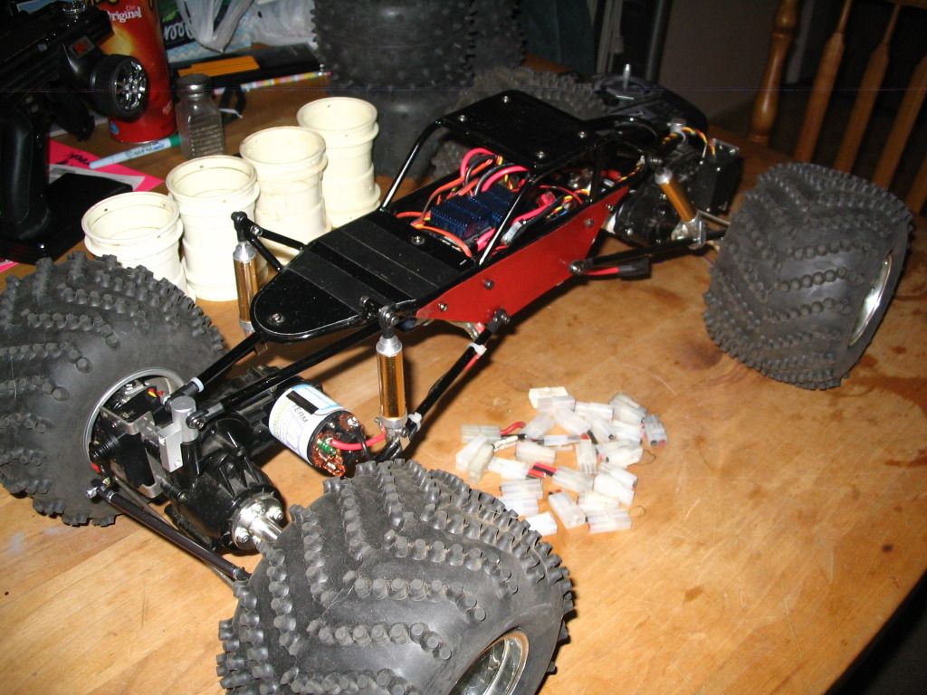

Well it's 5000 MAH single battery, Two Hitech high torque metal gear servos, two Integy 55 turn motors, two Tazer 15 T escs and a Tactic TTX404 radio. I'm going to try out the other tires just for fun. Under it is some of the connector carnage, 14 pairs of just Tamiya ones to be tossed out.

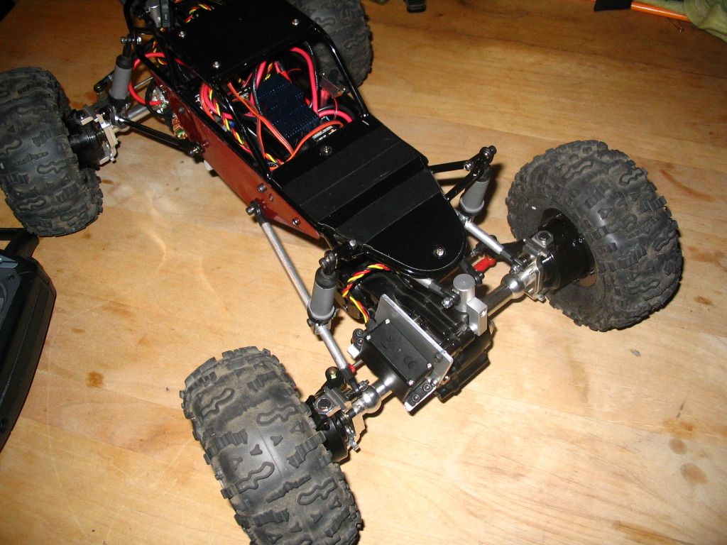

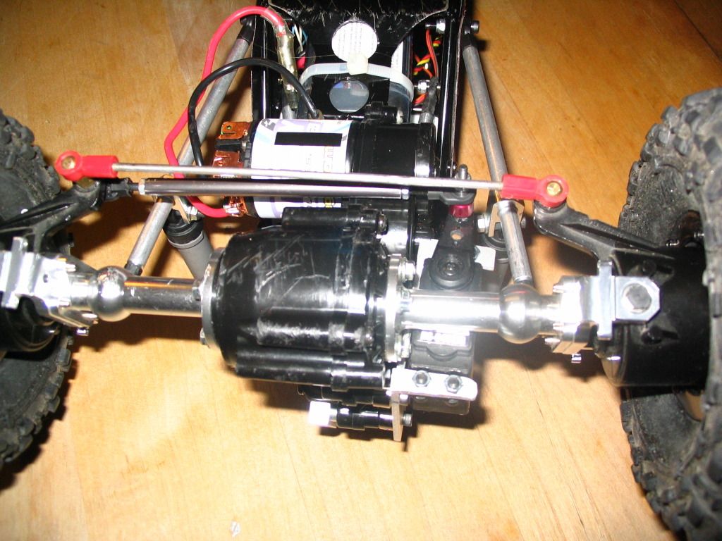

Just a couple of improvements. I replaced all the links and shortened the wheel base by 4.5 inches. It's now 13 inches. Swapped out the shocks and gave it another 1/2 inch of travel. I looked at all the steering options for sale and didn't really like any of them so I made the servo bracket to fit how I wanted and it works really well. I made 2 brackets so the rear gets the same treatment. There's no more flex in it and the axle protects it.
Posted Image Posted Image On carpet it's new turning radius is 3 feet, on a harder surface I can spin it almost in place using reverse and forward at the same time.
