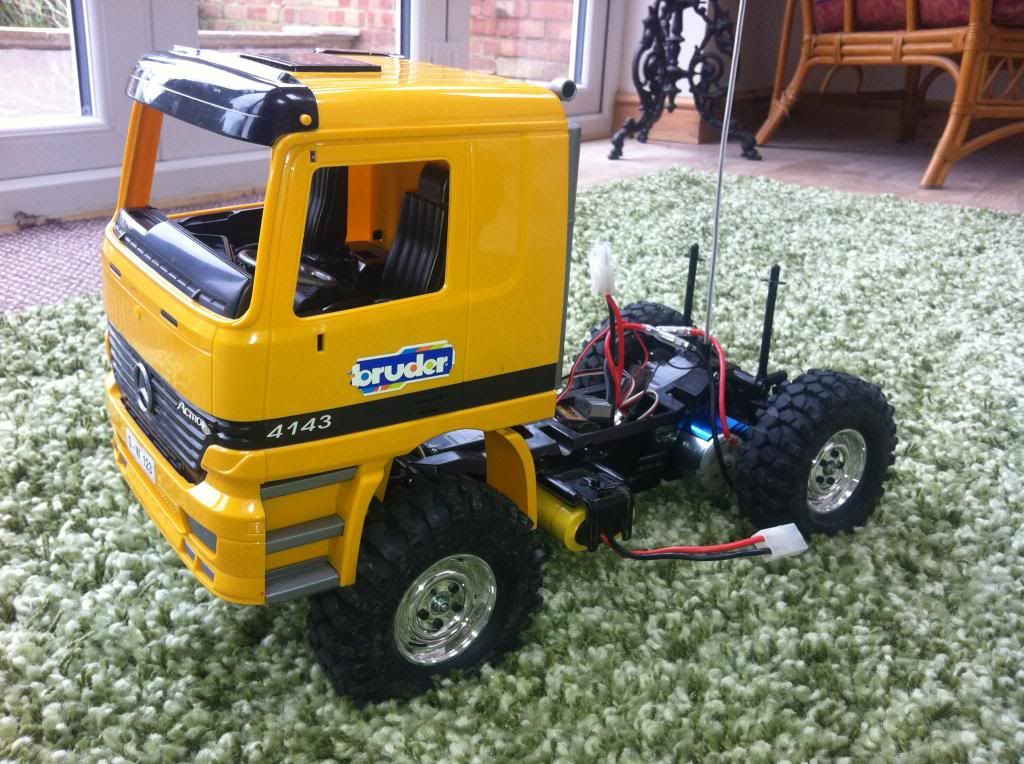

dyahipfakta 50 Posted April 17, 2013 Ok so my parts have all arrived and are mostly fitted. 70t motor from blacksmithproducts. (the cheap one) Chinese esc 6 pounds and my bruder cab Fitted the motor and esc and have to say I am rather surprised. ESC is great and motor is slow enough with stock gears but still has enough speed and seems to have much more torque. Neither of which get even warm after 10 minutes so that is a win. So impressed with the 6 pounds esc I may order another as a spare! Any ways bruder cab i really like and I think i will be using, needs a paint job and some adjustments but I think it works well. So my jobs list now stands at. Adjust cab arches to fit wheels Paint cab possibly olive green Find a way to mount the cab Make some adjustable steering arms then see if I cant get abit more travel out of the suspension Finally to decide what to do with the back half of the truck I dont really know about this one. Maybe a flatbed but not sure if the wheelbase would look odd. eg too short. Wont happen very fast but will make an entertaining project. 2 Share this post Link to post Share on other sites
bromvw 743 Posted April 17, 2013 How about TL-01LA parts to increase the suspension travel ? It looks like you could hide longer shocks under that truck cab and a box body on the rear would hide them too . Just a thought . It could make a good looking Dakar support truck maybe ??????/ Share this post Link to post Share on other sites
dyahipfakta 50 Posted April 17, 2013 Loads and loads of space under the cab its bigger then I thought to be honest. Ill have to look into the LA parts sounds interesting. Any ideas what I could build the rear section out of? I am planning on building an fake external roll cage for the cab out of plastic tubing if I can. Share this post Link to post Share on other sites
mr crispy 2293 Posted April 17, 2013 That looks very good. Hard to see its a TL01 under there. Even the battery placement is quite well placed and could be hidden by the fuel tanks. I think it'd look good as the front of an articulated lorry, so it would just need a mocked up trailer hitching attachment plate.... then you just need to make a trailer Share this post Link to post Share on other sites
bromvw 743 Posted April 17, 2013 Loads and loads of space under the cab its bigger then I thought to be honest. Ill have to look into the LA parts sounds interesting. Any ideas what I could build the rear section out of? I am planning on building an fake external roll cage for the cab out of plastic tubing if I can. Rear Section could be basically a box made from styrene ( plasticard ) but how about looking for a ready made one ? They come up on ebay or try a toy store and see what they have that could be adapted . Share this post Link to post Share on other sites
dyahipfakta 50 Posted April 17, 2013 Thanks guys. Dismantled the cab for adjusting and painting. May have a play with some plasticard have to say its been something I wanted to do for a while. Share this post Link to post Share on other sites

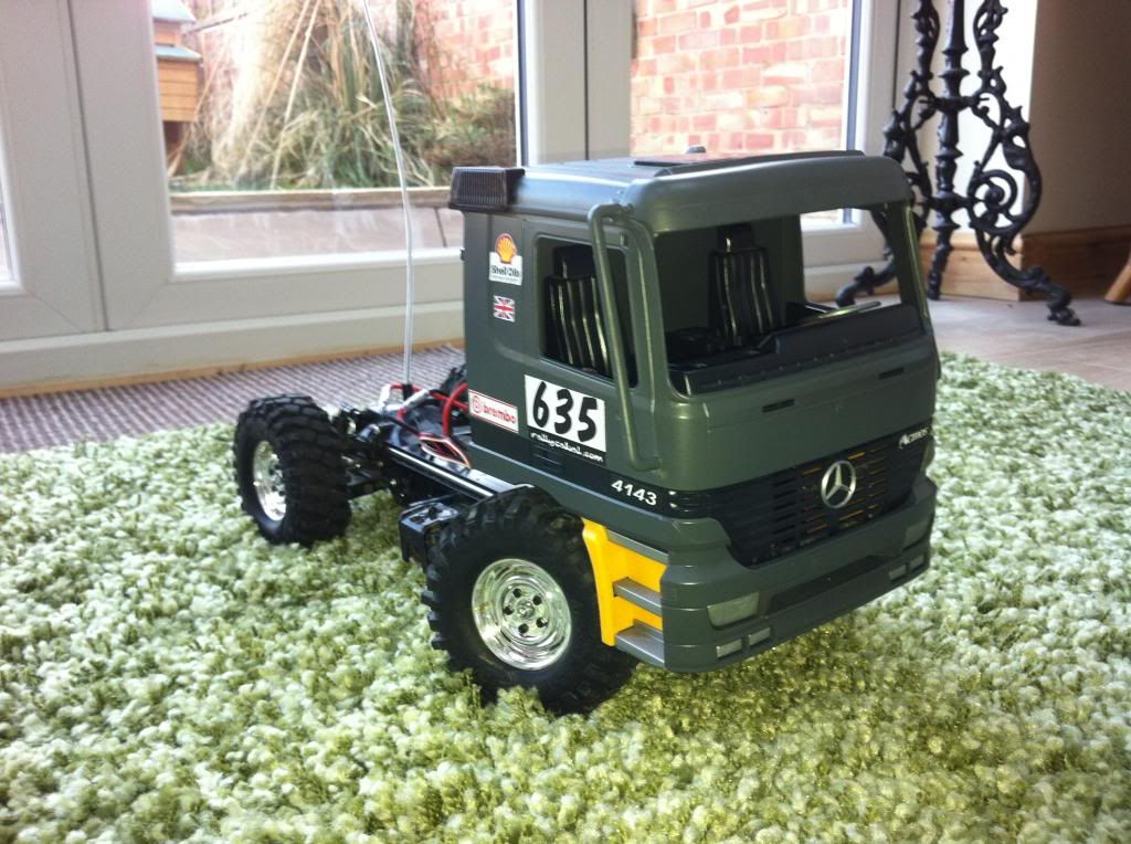

dyahipfakta 50 Posted April 19, 2013 Another little update. Was on night shift last night so when I got up at lunch time I put the cab back together after abit of paint and some home made stickers and test fitted it onto the TL01 as is. It works runs well and I think looks spot on I just need to make a better mount as its a fair amount of weight and the stock body posts aren't really cutting it. Share this post Link to post Share on other sites
