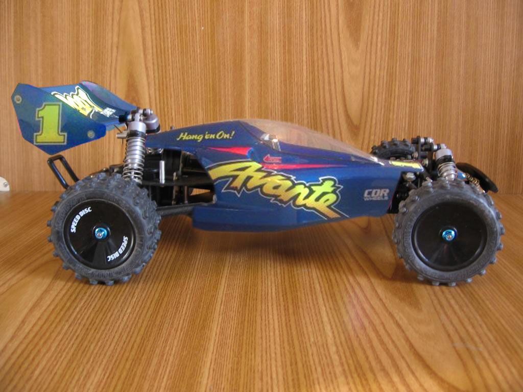

This is my Avante 2001. It is in poor condition, especially the body, and the wheels are from my Winger but here you can see what I said about the "preparation". My Avante 2001 has Avante little bumper and Avante/Vanquish rear dampers position and the wing is in a different position. The difference in front of original configuration is massive in my opinion.
Imagine it with the correct Avante 2001 wheels, the driver cockpit and a brand new body and stickers...
Max
