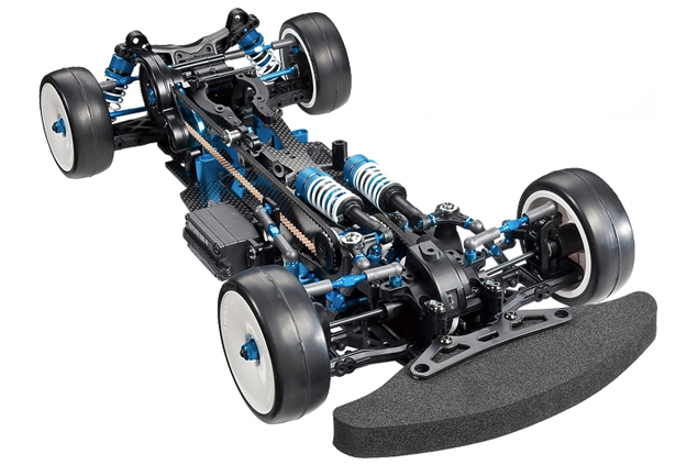

It seems interesting, and I was excited for a carbon car with IFS (for low bodies).....but I just can't get past the really messed up rocker-arm angle on the front suspension.  It's obviously terrible and really kinda ruins it.
