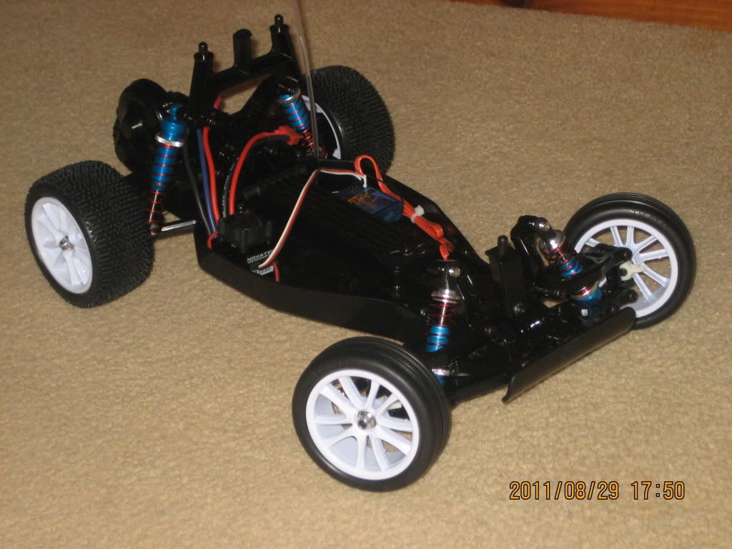

Here's my entry to the HBAS, complete with full bearings, Novatech Assasin 3600kv brushless, Yeah Racing shocks, and 3Racing wheels and tyres. Painted the roof pearl white to match the white wheels.

Looking like a beauty!!!

Looks great...
