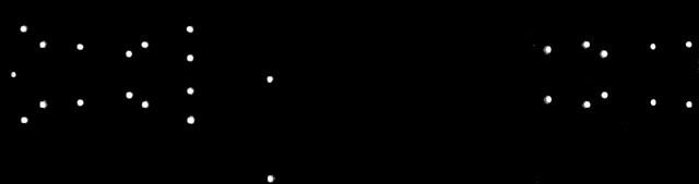

this is not a digipix... as the lens' perspective will introduce scalar inaccuracies
its a scan & trace, difficulty compounded by the chassis being longer than the A4 flatbed
but at least you can be sure the holes are where they should be!!
thank you!!! i will print that out and line it up with the holes i already have, the inaccuracies should not be a problem as i have most the holes.

you need a pic of evoIII chassis plate?
scale pics of the carbon plates would help me a lot
unfortunately the evo 3 manual does not have plans for the carbon plates. but the evo 4 does, im thinking i might build an evo 4 plate and use the conversion kit and the diff boxes but if i scale the pdf up to 215% the front diff box holes line up but the evo4 is shorter. dont know what to do but to risk drilling a hole in the wrong place suposse i could slot the hole. well im still waiting for my blue bits so i can attach them to the cf plate and see where i can lose some weight (right now i have traced around the tb-02.
