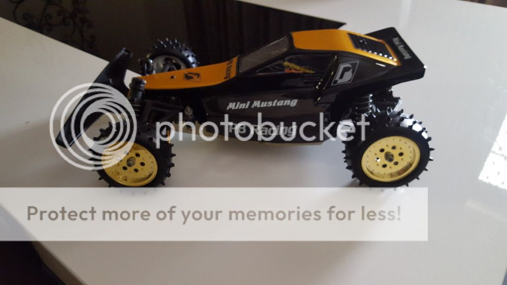

Just Finished my refurbished look of my Mini Mustang.
For running at Boondal I decided to go for Re re Super Shot wheels as they bolt straight up with new Schumacher spike tyres with foam inserts.
I hated my first attempt of painting the original sourced shell so I ordered another body from TBG and went to work on a black and gold scheme .
Just a basic but a effective look I feel. I refined the saddle pack set up better and it will run a 2 speed down the track with a brushless combo. At this stage it's got a 12t brushless combo geared very low.

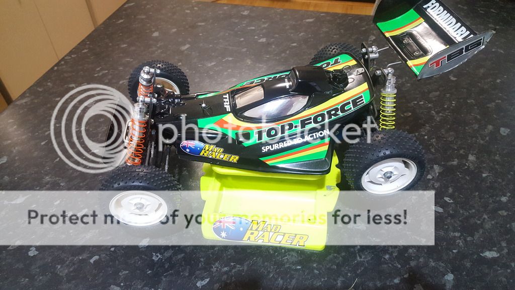

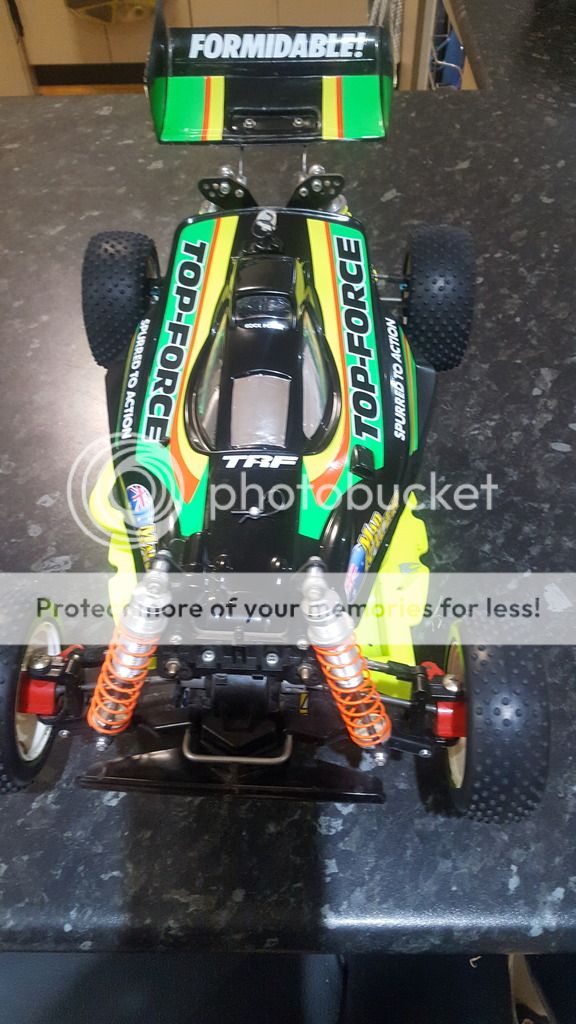

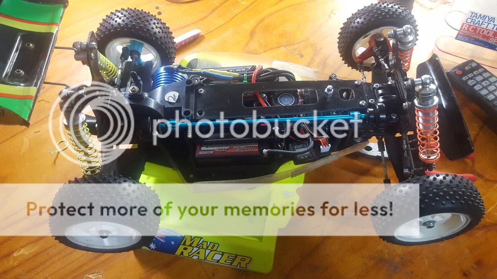

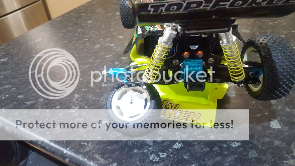

Well I built this up about 5yrs ago. It's what I call a Bitsa build but some serious R&D had been put into it over that time.
I was going through all my spares that I acquired over time from my Rays & Terror Conquer and relized that I had almost enough parts to build another Top Force. I had a Top Force but was a New Re re and didn't want to run it so this was a good way out. I wrote a list of parts that I thought I needed and went to work in purchasing them. From memory it came to around $150 . I had lots of sticker sheets from JR RC store when he was selling them at stupid low prices and a non genuine shell from Canada.
From the out set this build was with our bumpy slippery loose dirt Boondal track in mind. With a few tricks thrown in of my own.
Shocks are Yeah Racing 90mm shocks front and Rear. Losi springs and drilled pistons
Ball diffs front & rear while the front is a new TA03 light weight diff being used.
A Yeah Racing alloy centre shaft being used
AE B44 battery tray was grafted in recently for the saddle packs and a low profile steering servo to allow room for the esc to be in the middle of the centre line.
A 9T Ez Run combo gives the tyre shredding power.
A Yeah Racing Alloy Motor Mount and Diff Cover.
Losi Stud tyres on Top Force Wheels. Top Force Universals all round.
The rear end is where lots of research and trial & error of components . ( Axels and correct alignment )
I wanted more rear grip then the original rear hubs offer & more adjustability in roll centres . So after 3 different attempts of doing this mod I ended up with a set of Yeah Racing alloy M05 hubs with 2.5d of toe in. ( This is why I love Tamiya parts ) I wanted vertical mounted ball studs too as I feel this aids rear grip as well as the toe in which is critical . Mega traction was the end results with a re drilled Roll centre ( Camber Rod ball stud ) pick up on the rear tower to get better geometry through the suspension range.. It's almost like a trailing arm set up with only a .5d of camber change throughout the suspension travel. So much traction I had to stiffen up the rear end to stop traction rolling. This mod has since been performed on my Rays too.
The front end had a Evo copied front tower but it gave too much steering as the shock tower is a little shorter so the original was put back on.
So how does it go. Simply awesome.. Has lots of grunt with a good top end. Traction from front to rear is very balanced and very predictable . I recently played with diff set up's to get a better balance and feel there is very little more in tuning to do.
Well its a Bitsa but nothing is rough and looks like a original Force so I'm really happy with it.

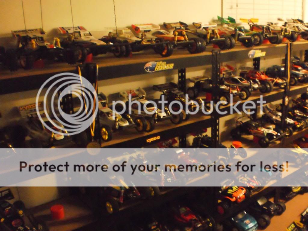

The shelfs are from Bunnings. Bought over a period of time as my collection grew. They are Hammerlock design but not sure what Brand. Problem I had is the manufactory changed it's design over the years so they look a little different up close to some newer shelfs. Length is approx. 80cm long by 30cm deep. chip board shelfs .Just big enough to hold a 10th scale on a paint cap. 6 Shelfs span the length of our garage .
Problem I have every time our panel lift door is open ( Wife's Car ) everyone can see them. Oh well we have insurance
1
I use Shelfing from the local Hardware store. I have about 10 4 shelf units. All cars are stored on top of paint can lids. All of the top shelf is non runners. Rest are organized into brands like Schumacher, Losi, Marui and of course my Tamiya's. Cars that aren't on the paint caps are in my hobby room awaiting for work. Any parts that I need are ordered then put on the shelf next the car so I know what parts are for what car.
