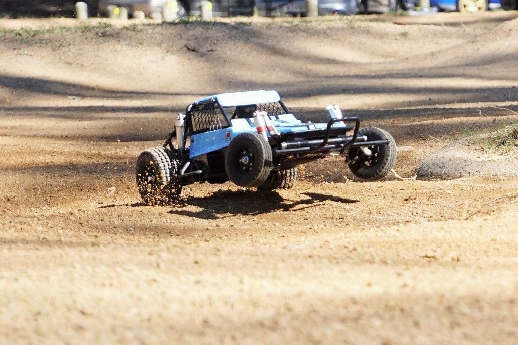

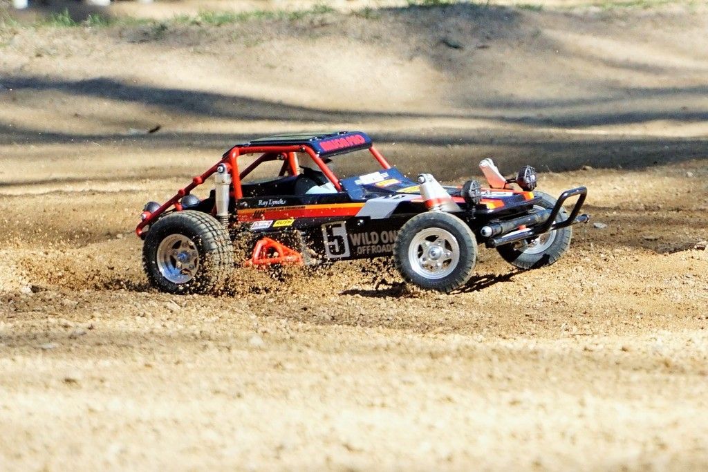

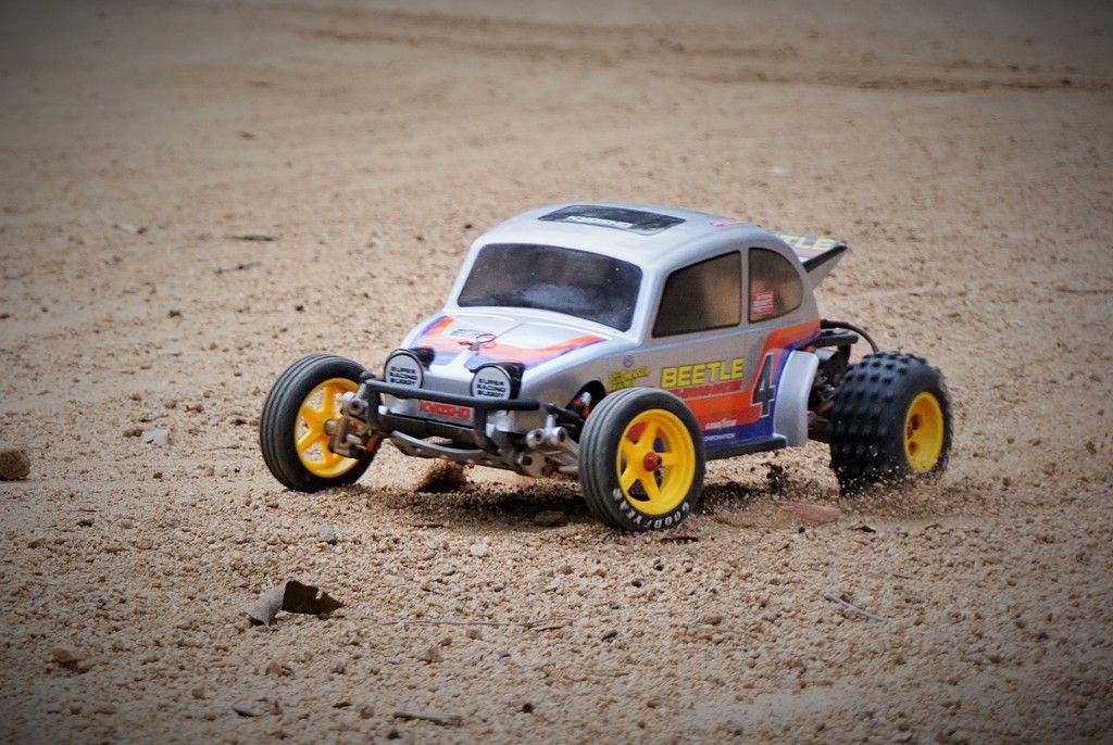

The problem with the Frog is most owners build it up with 0 degree in the Castor block.
Instructions aren't that clear in the vintage manual . As soon as you add a few degrees ( Very little angle) in the castor block like what the Wild one has in it's trailing arms makes the Frog so much better and not edgy in steering inputs.
Don't think I'm all for the Frog as my W/One is a awesome performer once softer rear shocks were put on. The front end on the W/O flogs out quickly as Gruntyfuggly said. But is awesome to drive.
Just a big flaw by Tamiya on the Frog /Brat that they didn't explain this. I think a little in the back pages in the vintage manual if memory serves me correct? . Maybe someone can confirm this. No info in the re re Manual. Just checked.

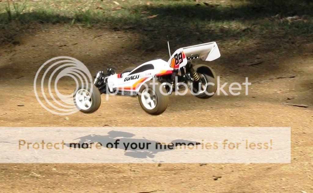

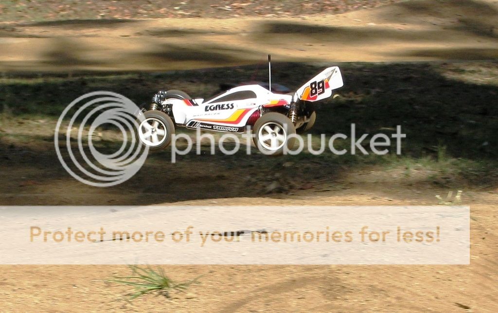

Well I recently finished my Egress Re re build to run at Boondall.
The build went smoothly but was not happy with the ride height of this at all. The front sat too low and the back to high even with the pre load adjusted to the max at each end. So after a few simple mods and a new front shock tower I hit the Boondal track.
I used modern rubber and electrics. This was dialled. Every bit as good as my well sorted Avante or even better thanks to the longer wheel base.
Just loved how much rear end grip the trailing rear arms give and stacks of steering too match.

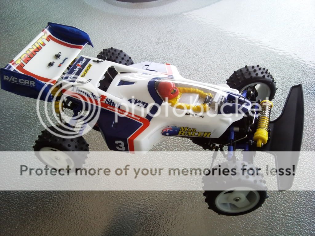

I use a 13T EzRun system in my T/Shot and it screams and it loves it LOL
I have adj top links, Unis all round and a alloy A5 brace, Custom wing mounts & wing and modern rubber on 2.2 wheels. Not in pic.
Seriously under rated buggy...
