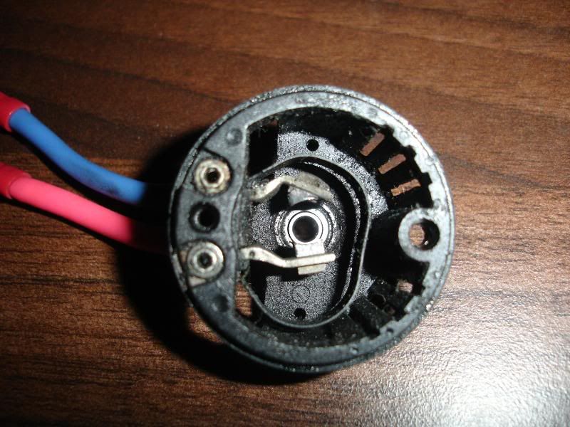

  1. Ok I just took the motor apart to see what I could see, the magnets and windings look ok and the motor turns freely. I took this photo of the end bit.
    I tested votage right onto the ends of what I am guessing are the brushes, the middle bits. One is springy the other seems tight, one looks obviously worn. Is that the problem?

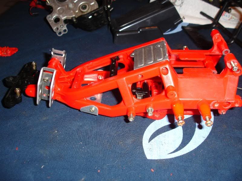

    Last night I fully stripped the chassis, de greesed and cleaned it all up and put it back together, these photos show as it is now (today I had to work :( )

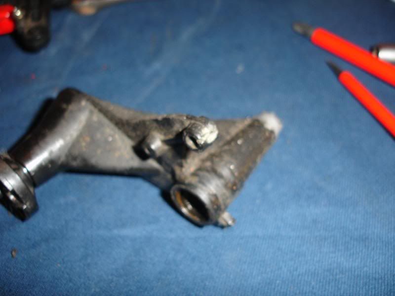

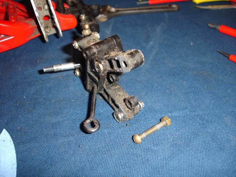

  14. Well there's no turning back now!

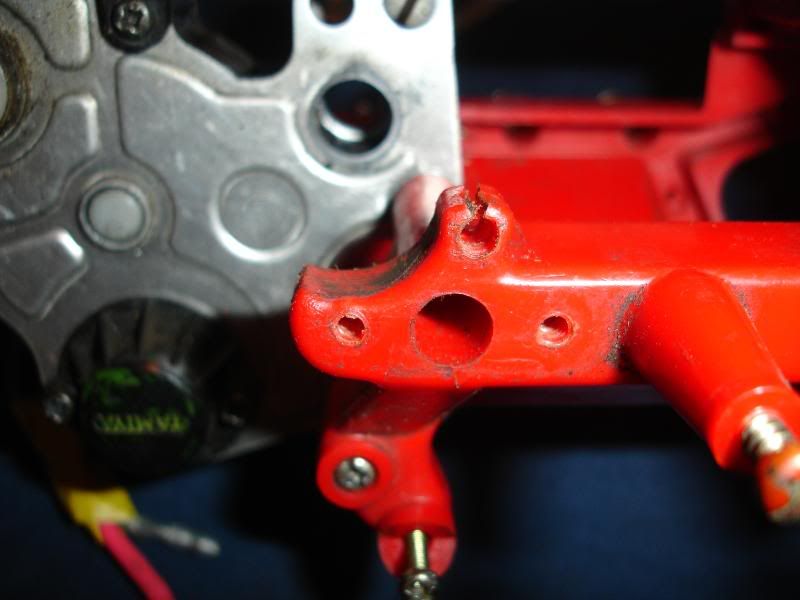

    Sadly it looks like the incorrect screws have caused some damage, not alot as most of the screws seem to be ok but one of the rear trailing arm covers was held on using three incorrect screws, the bottom one was too big and has caused this damage...
    What would be the best way to repair this kind of damage? also hopefully so the correct type screw will fit again. I guess I now need to trace these three screws and see which screw bag they are from. Would they be available separately without buying a full bag of ebay?
    The below picture shows the trailing arm shock mount damage, both sides are the same...
    New arms required?
    Now then, on both sides at the front the upper wishbone bolts were replaced with standard bolts, this has the problem that you cant tighten it up because it causes the wishbone to go tight. Are these something you can buy? The picture hopefully shows what I mean...

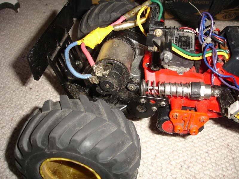

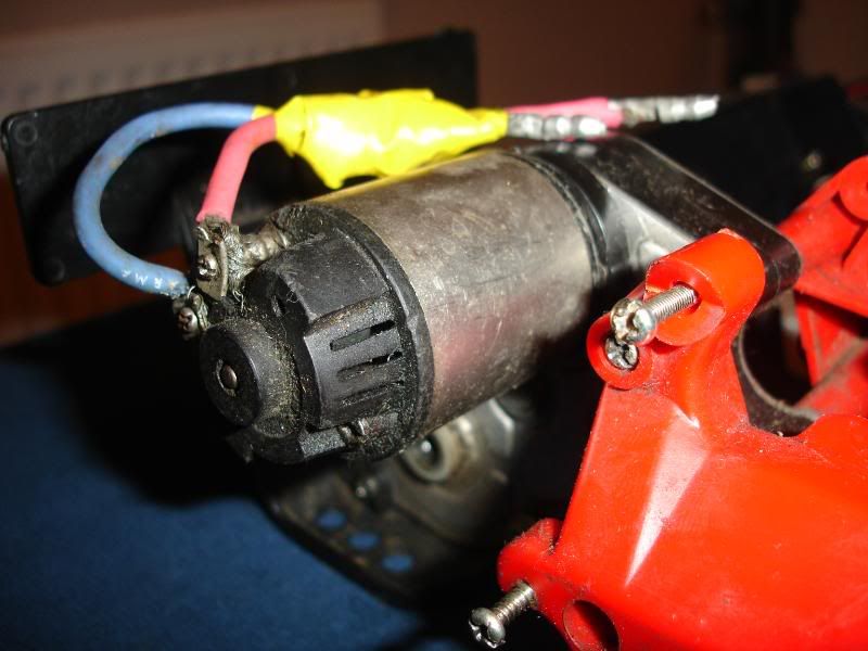

    I also thought I would show a picture of the motor again to see if anyone knows what it is?
