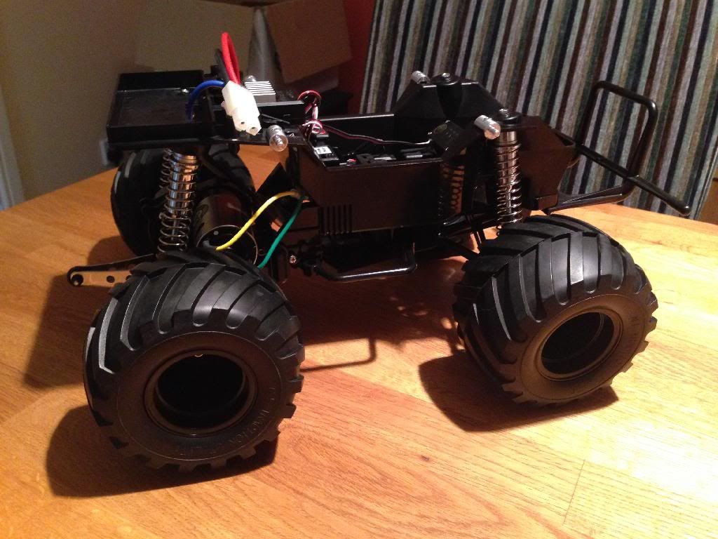

Fitted the sport tuned motor and cva's to lunchie and got her up to here:-

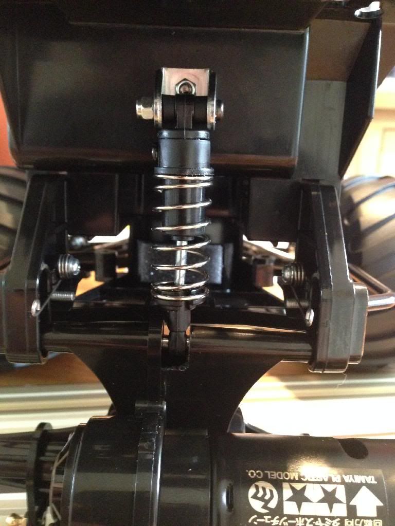

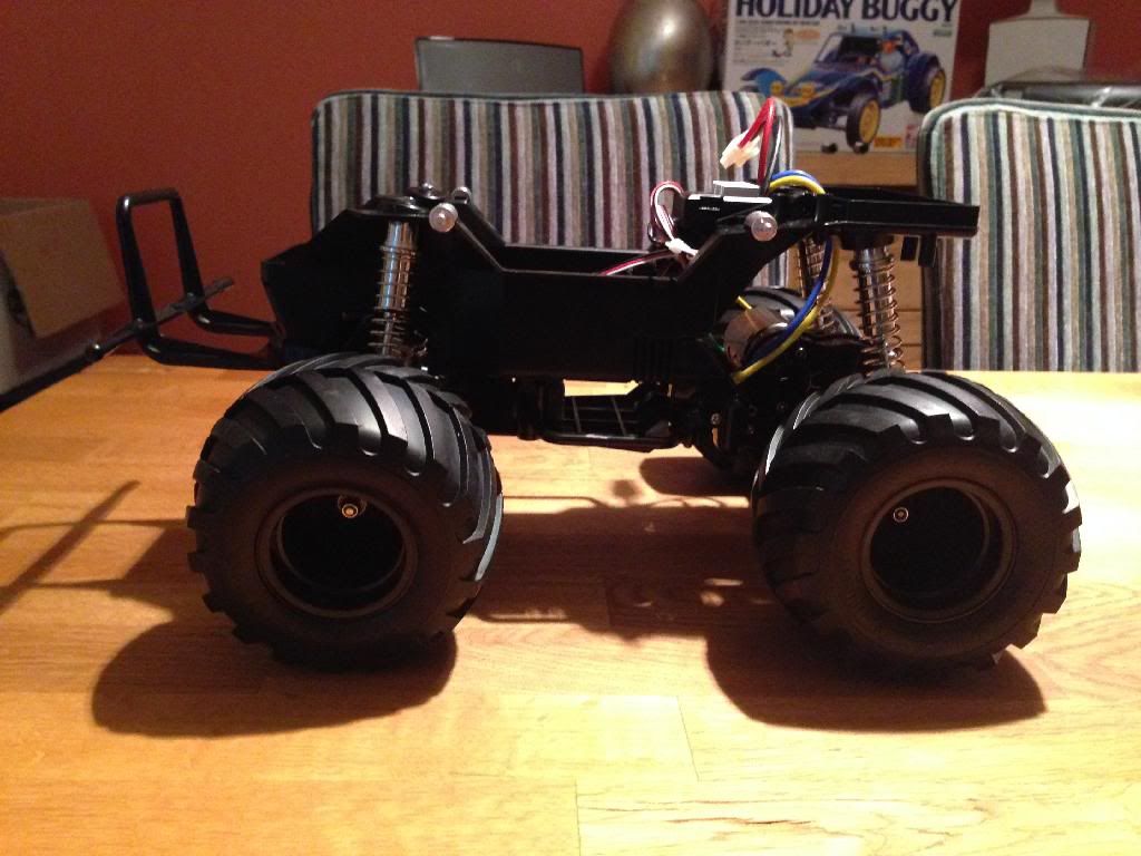

Wow, so I spent half of today messing with these along with doing a third shock mod and I am at a bit of a loss
It seems the spring rates are really weak and although they seem fine at the rear the front is a problem... They literally will not hold the front end up.
I have tried swapping out the springs for the original lunchbox ones but as they are longer I had to compress them and they were just to stiff, so I stole some from my holiday buggy rears as I am fitting cva's and ditching the friction dampers. They were ever so slightly to short so I fitted a spacer clip and they were ok once fitted...
The issue, aesthetics
the springs have wider coils and just looked wrong against the rears, so I am back on the supplied (84365) springs with tension clips.If I place the chassis down the shocks support the tub but if you press the tub down they only return about half way :S
I am thinking that when driving the front will lift naturally but I think it seems too soft for jumps and wheelies and will bottom out as soon as it comes down.
As this is my first lunchie are these the correct settings? The 84365 kit is the correct kit for the cw-01 chassis so I would of thought big T knew what they were doing but it seems far to soft to me.
So how do you guys have yours set? Any suggestions on springs if this is too soft?

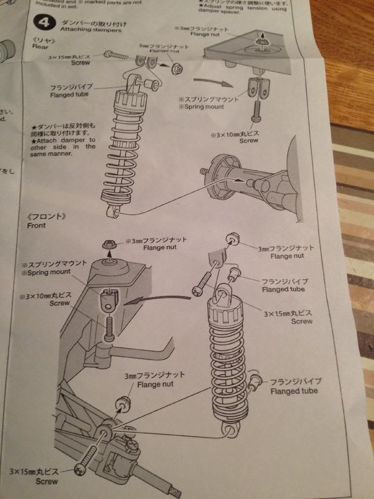

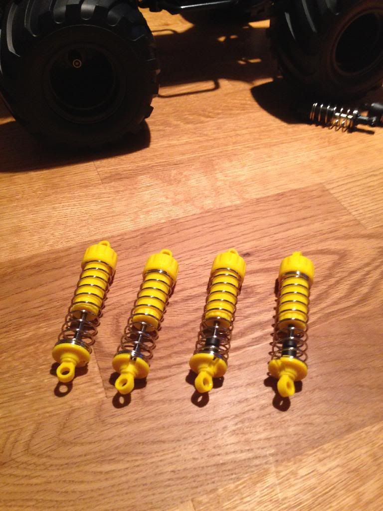

Guys, my 84365 cva short shock set arrived today which are clearly designed for the lunchbox as the instructions show fitting to a lunchie/MP chassis. In the instructions it suggests cutting the rubber tube to create two 10mm bump stops and fitting to the front shocks only.
However it does not show this in the actual lunchbox manual in the cva option section??
It does seem to significantly reduce the travel of the front shocks so I am slightly bothered by it. What have others done? I am guessing it helps the front end with jumps?
Some pics of included instructions:-

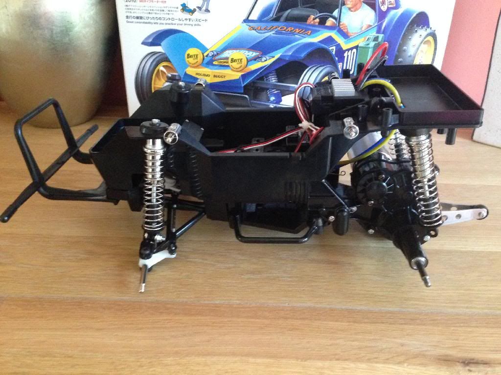

Well I got cracking with my lunchbox, did quite a bit and got up to here:-
There will be a build thread to follow as I have been taking pictures as I go along, first thought is how much flex there is in the front of the tub. I think I can add a chassis brace using some of the left over A parts. Will just need to source some threaded rod from my LHS.
None of my hop ups have arrived so I will be taking it apart again to fit the third shock, cva's, sport tuned motor and chassis brace. Although I did get these
