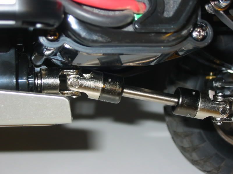

Anyhow, I just noticed something peculiar about the rear driveshaft that might explain why your ejecting e-clips.
This is the drive shaft in question:

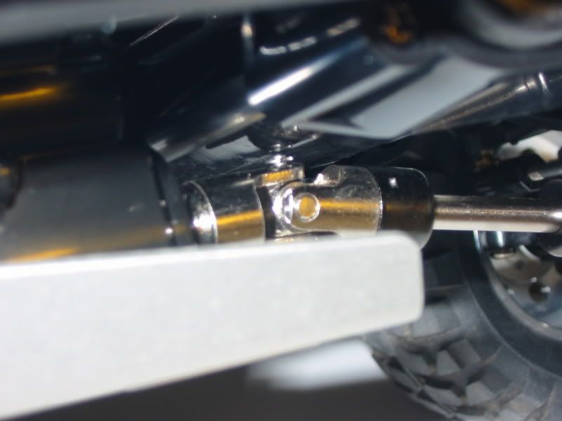

And this is where the e-clips hit the battery![:S]
I casually checked over the assembly and it all seems to be in place, but I haven't heard this complaint from any of the other High-Lift runners.
Has anyone else had clearance issues with the rear driveshaft and battery??
-Steve
I admit they're close but mine don't touch the battery.
For now I've used a split pin and put this joint at the axle end to avoid clearance issues. It works fine as a "trail" repair (another thing to put in the toolbox!), so I just have to find some teeny weeny circlips[:@]
