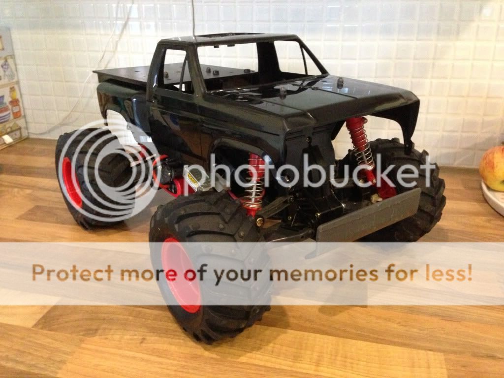

Well, put her down on the floor in the house to take it for a test run since it's pouring rain outside
First, wow... can't believe I got that tranny put together right and everything seems to shift PERFECT.
Second, good lord thats a noisy drivetrain!
Third, the Tamiya 302 ESC might not have been the best option. Too much braking; letting off the throttle abruptly makes me wince as I can envision gears slamming into each other. Doesn't appear to be adjustable, so a better, more adjustable unit might be happening sooner rather than later!
Cheaped out and just threw a TEU302 in there for now. If she turns out to be a go-er and not just a show-er I'll put in a proper crawler ESC and motor.
Didn't want to tangle with too many unfamiliars all at once!
The Bruiser's suspension actually tried to do something to absorb bumps, something that a High Lift doesn't
I've left my diffs unlocked (but with a healthy squirt of AW grease in the centers to slow them down) and the silver can in because the Bruiser to me is a big jacked up truck that is only 4WD some of the time, not a rock crawler so I want to be able to put some boogie on but not have the thing trip over it's self like crazy, a thing that locked diffs do at speed.
Just try it with the Black motor, but I think you might find a poo in your pants when you snag 3rd and give it a boot full
They are the rhinoceros of the rc world, big, heavy and dumb but can crank up to a deadly pace really quick... and don't stop in a real hurry for anything.Hah! Good comparison. I'll definitely keep that in mind as I'm testing it out this week; as heavy as this thing is it's got definite ankle snapping potential
