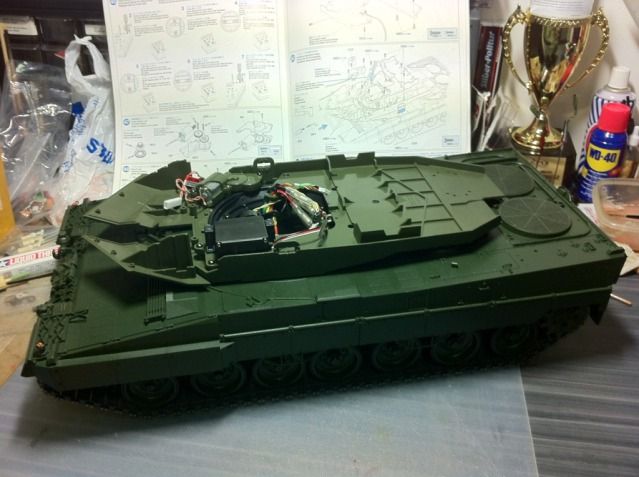

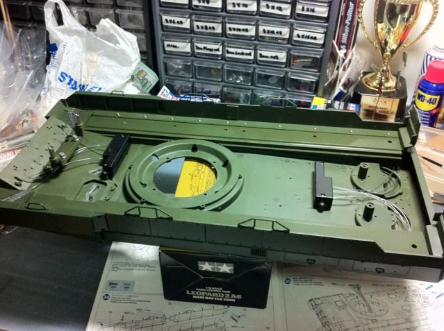

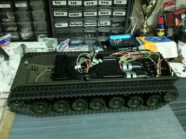

  5. Redo the whole cables arrangement, this is version 2.0. Must say i am much happier with this layout, the hull can close properly. Just need to get a smaller batt and the space would be better.
    This was before, the rear of the hull cant close properly.

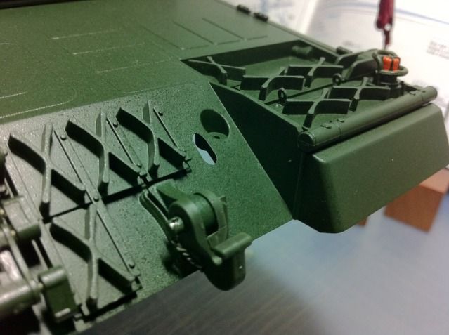

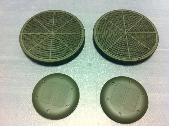

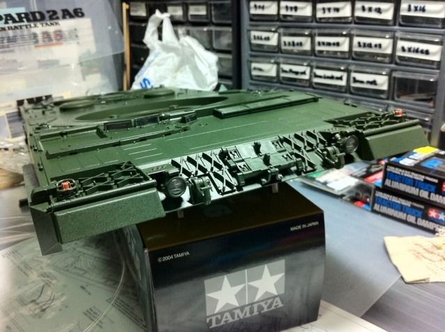

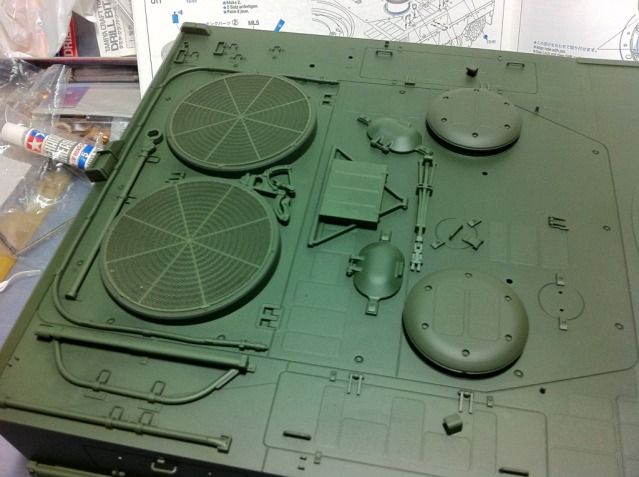

    Hull paintng done
    Lazy man style, masking of all the clear parts and simply spray.
    90% completed, just some minor details like the spade,weathering,misc to add in, radio has been setup with the DMD and it was a BLAST for the test run. Will try to upload the video soon

  10. Had to open to cover to pull put the wires, was too short and kept too much inside.
    Some of the painted parts for today
    Started the installation of the main gun unit.
    Then i ran into problem,
    The painted lower half of the main gun was struck and the recoil action doesnt work.
    I had to sand away the painted area.
    After that, the recoil spring was over stretched and wont work anymore.
    Looking through my spares, manage to find a stronger and better spring
    Now, i have tidy up all the wirings.

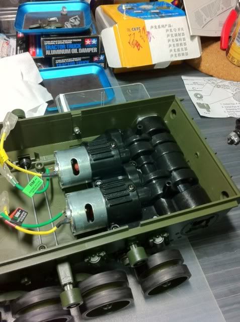

  11. Next, was the road wheels installation itself. its such a PITA to have to cut out the road wheels rubber manual, doing the same thg over n over for 28 wheels, and putting them on the road wheel itself for 28 times.
    this is only 1 road wheel
    completed the 1st road wheel,
    another 27 more to go......:mad: together with IMPACT metal suspension arms
    After awhile....... :rolleyes:

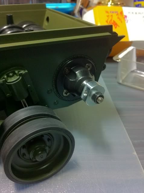

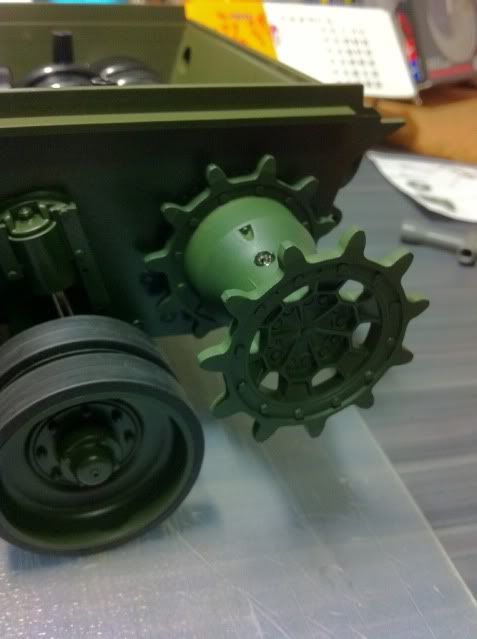

    next was the Idler wheels installation,i got IMPACT upgrade part to replace the plastic Tamiya was providing...

    Next, i started the installation of the Torsion Bars and upgraded to ball bearings all round
