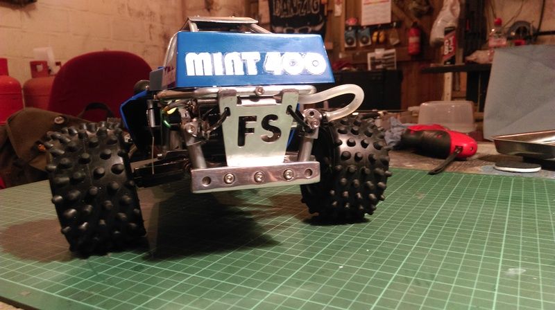

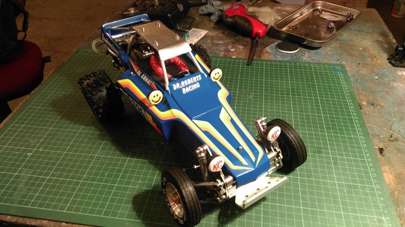

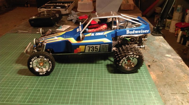

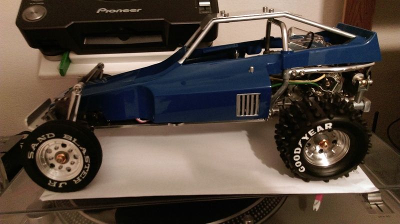

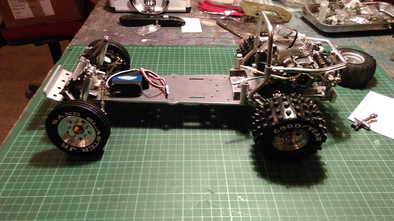

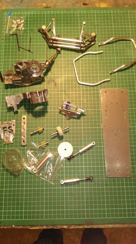

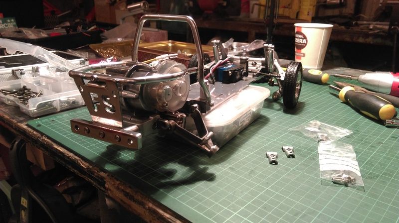

Bought a very well used vintage super champ on the bay a few weeks ago.
When it turned up it was a lot worse than I thought, all the metal work was painted in black, gold or silver brush paint. After taking it all apart things got worse, stripped threads, wrong nuts & bots, self tappers jammed in places, one brass UJ & one steel (painted gold) & not to mention more things covered in terrible paint.
It was too far gone to make a 100% vintage resto so I decided on a custom build with aftermarket & rere parts.
As it arrived, minus the upper deck.
The dreaded paint

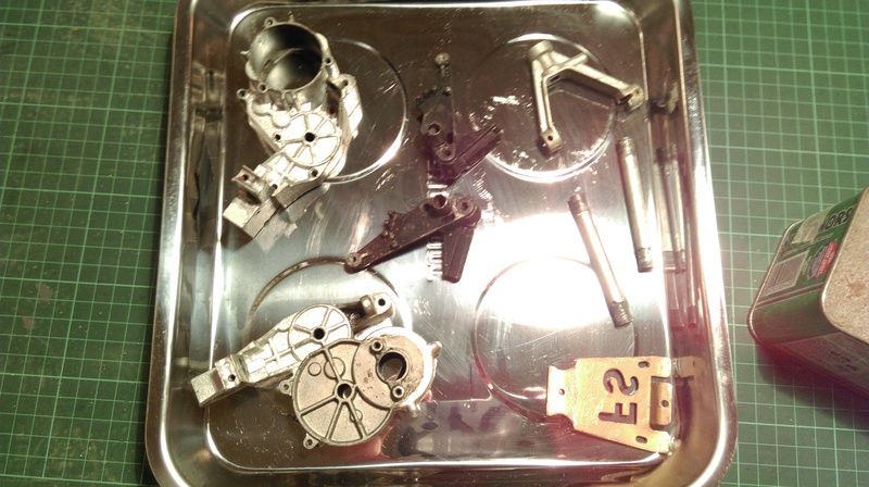

After paint stripping & fine wire wheel.

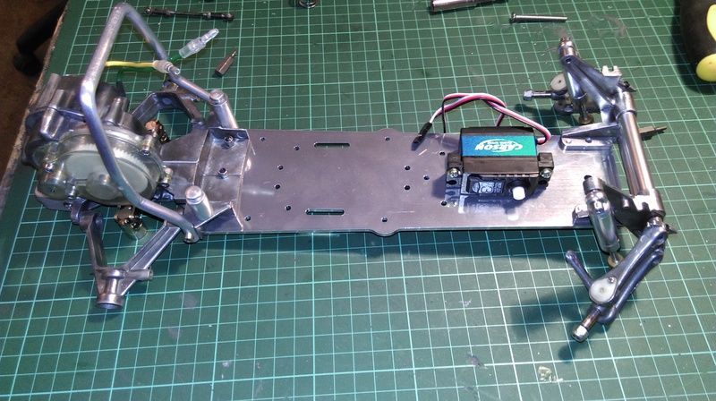

Front end assembled & pargu chassis at the ready. At this point I stripped the rear damper to find that the piston rod was bent in 3 places.
I manage to rescue the clear gear cover after cleaning the paint off with thinners. I was about to put the drive shafts in when I noticed a bend right next to the threaded end, how is that even possible?

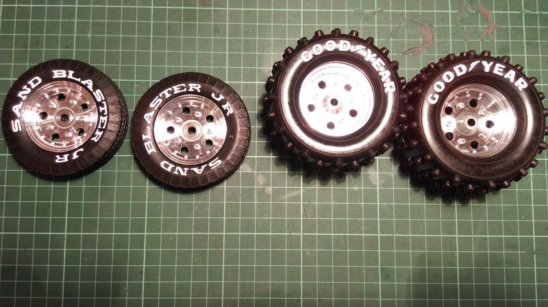

Original sand blaster juniors & marui good year tyres on rough rider wheels with pargu alloy covers.
Front damper were sourced from ebay, 80mm with internal springs, I used the brass bottom mount from the original srb dampers.
Rear oil bottle & bracket are from RC channel as well as the arms that attach to the rear damper.

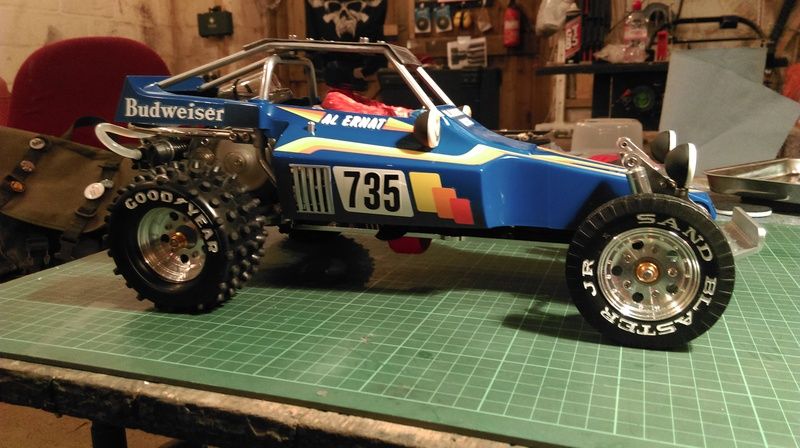

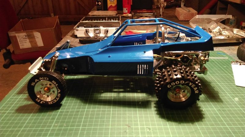

Rere body
Decided to make my own roof, I find the roof with the wing makes the buggy look a bit high. Polished up the plastic of the body & finished it off with a combination of rere & repro decals.

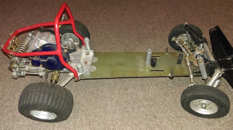

I have also acquired a slightly more complete but equally beat up Super Champ.
I'll be carrying out a similar custom resto but with a rere super champ body. I look froward to your progress pics.
