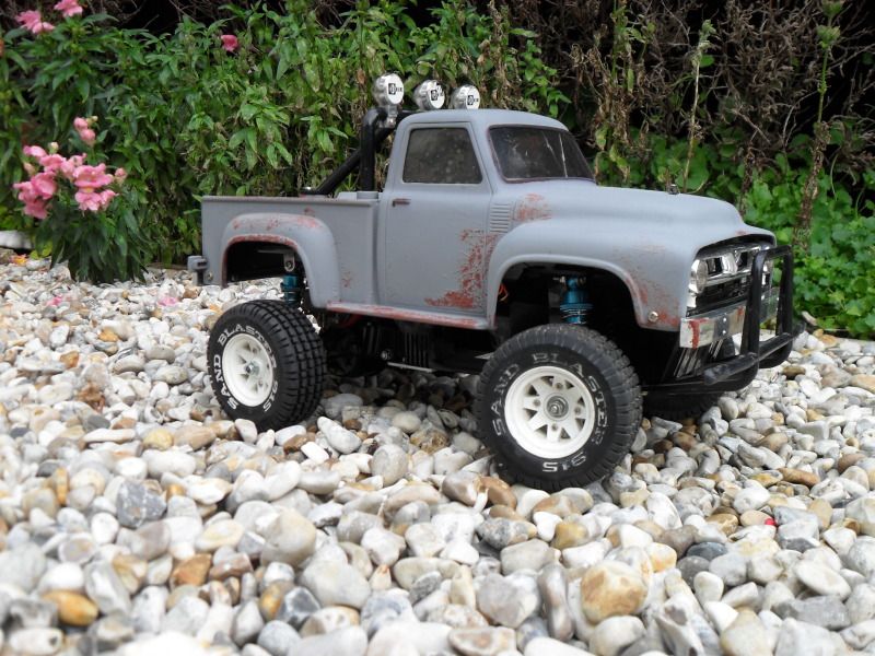

Put a hotter motor in & it wheelies fine, as long as it can get grip. The wheelie bar could do with a slight adjustment to get longer wheelies. Other than that its really good now,
Thanks for all the positive comments.
Thanks. Been running it today. Not quite enough power to wheelie on the tarmac. I tried the Pajero/Hornet gear ration with the 18 tooth pinion but all I gained was more top speed.
Just carried out the third shock mod, lots of the rear axle bounce has gone & I now get more grip. Time to go back to the lunchbox/punmpkin pinion & a hotter motor.

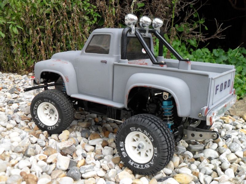

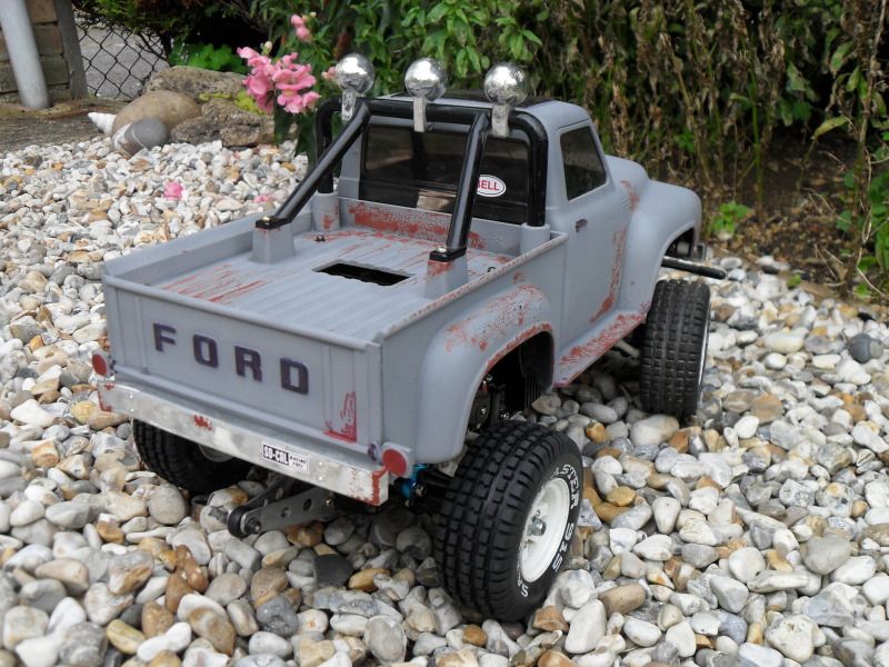

I got around to painting it last night.
I think all it will require now is the third shock mod.

Radio gear in & a quick test in the house confirmed that it does wheelie.
It's mostly the bouncy balloon tyres and pogo-stick suspension that makes the Pumpkin unstable. Stop the tyres from ballooning and bouncing with some inserts and wide gaffa tape stuck to the inside of tyre, and use oil dampers and it's quite stable too. But it will still wheelie over the short wheelie-bar and stand up on the tailgate.
This is a great looking project, but it will maybe need a bit more power to make it work as planned.
I've done all of those mods on my lunchbox & it really helps, like you say it still wants to flip over the wheelie bar. If the old yokomo motor isn't enough then I have few others that can make it more lively.

I think I'm going to go for a mat grey primer paint job, though I'm not 100% sure. At least if I don't like it it's ready to receive a colour coat.
Should be able to paint it some time this week & post pics.

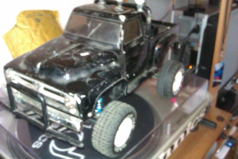

Having owned a Lunchbox since the 80's and having had a few Hornets I have always fancied the old Pajero.
Rather than go to the expense of buying a good one or restoring one & having the fear of running it I thought I would build something similar.

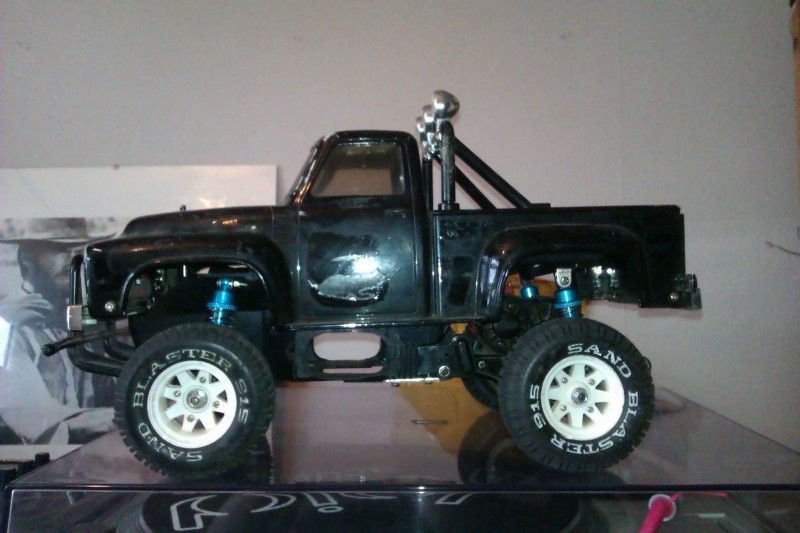

I have a stack of Lunchbox spares so I bought a tatty looking Midnight Pumpkin on ebay very cheaply. Turned out to be a bit of a bargain as it only looked tatty but had no broken parts what so ever & came with a set of Futaba radio gear.

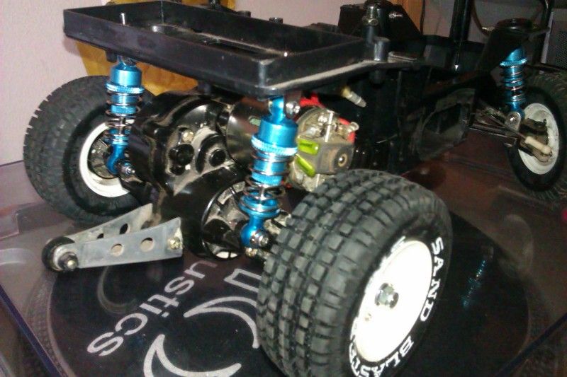

I pulled all of the parts off of the pumpkin that give it the monster truck lift, fitted some short oil dampers & spare set of brat wheels & tyres.
I offered up the body & it looked good. I then put it away in the cupboard to work on another day.
over a year later I drag it out to have a go at finishing it.
The body looks bad but its just dirt & remains of sticker glue. The fact that It has been brush painted doesn't help.

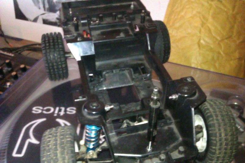

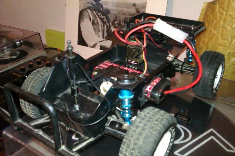

I had to lengthen the wheel base slightly. Pulled the gearbox pivot mount out of the chassis by 15mm & added extra strength via a alloy plate.
Cut away the insides of the chassis & made holes on the outsides to accommodate a stick pack.
Stripped the gearbox to fit bearings, I found that the gears were in superb condition. I'm guessing that it was only run a few times & in mud hence the vehicles appearance.
I fitted a vintage yokomo motor which is similar in performance to a sport tuned. I kept the pumpkin pinion to guarantee wheelies & hopefully a good run time.
Next step is to clean & paint the body & fit some radio gear. I want it to look like a well used old truck so will probably go for a flat paint finish & keep the cracked windscreen.
I'll post more progress pics as I go.

I also tried having the battery in the same position as that, I found it was affecting front axle articulation. I have a couple of old stick packs that I might re arrange into the cells either side of the front axle style.
