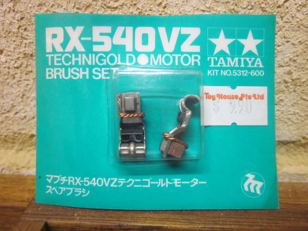

  5. keep watching ebay the technigold brushes come up from time to time.
    you could also use the Technipower brush if you wanted to.
    I'm not really sure what the difference is between the technigold brush verse the technipower brush compound but the brushes fit in the cans. also the Dynatech motor used the same brush design.
    one brush might be made of more copper then the other but i've never really looked at the difference.
    'Madracer' once spoke about it: in this thread: http://www.tamiyaclub.com/forum/lofiversio...php?t60390.html
    "Yes you can use them all between them.
    The instructions says only use Technigold brushes as performance will not be the same but that was just marketing hype ..
    The differance is the technipower/tune motors you had to solder the pig tails on where the gold are pre soldered . Gold has vented brushes (large grooves to help bed in and keep com wear down.
    The Dynatech are just plated gold brush holders. Will fit no problems.
    I have all of these motors."
