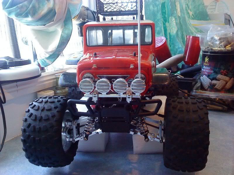

Thanks - found one of your older posts yesterday and am inspired by your land cruiser!. With all the alloy parts available I'm now wondering whether I'd be better buying the basic chassis parts and building from that, rather than buying a stock kit and then extra the outlay of new motors, pinions, a few alloy bits and wheels.
