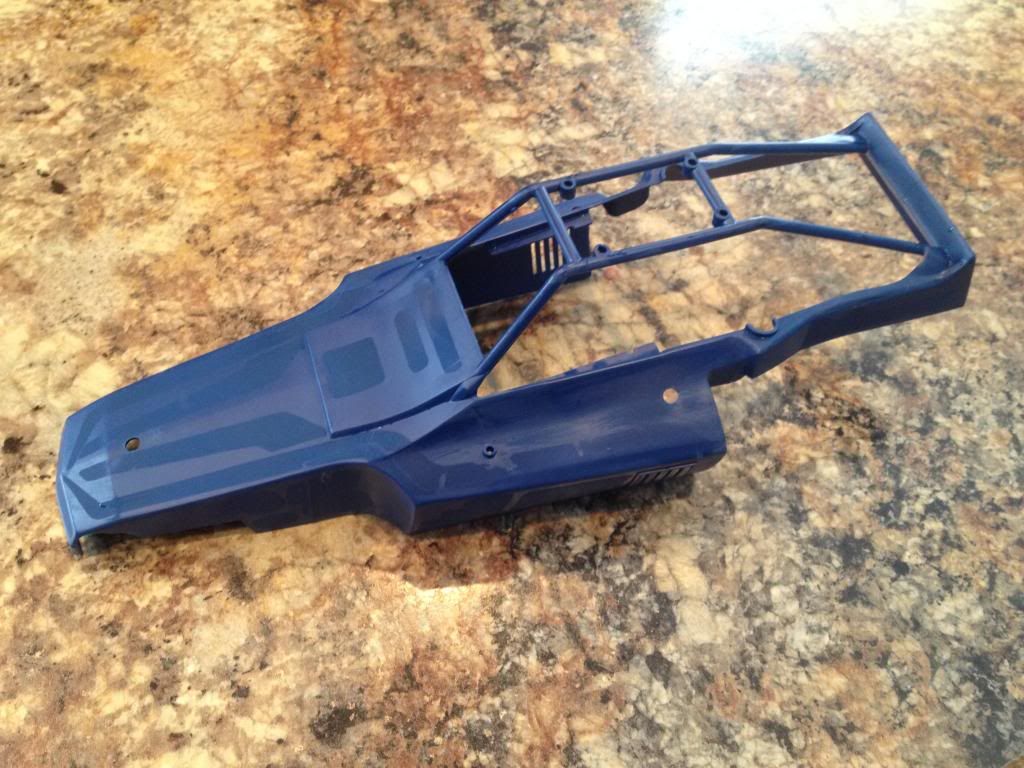

Thanks guys! Little update today...after about 6 weeks soaking in Purple power degreaser, it was time to pull the second SC body out and see if the paint was all gone. Turns out the body is almost perfect! Just a couple splits that will be easy to fix. Very happy!

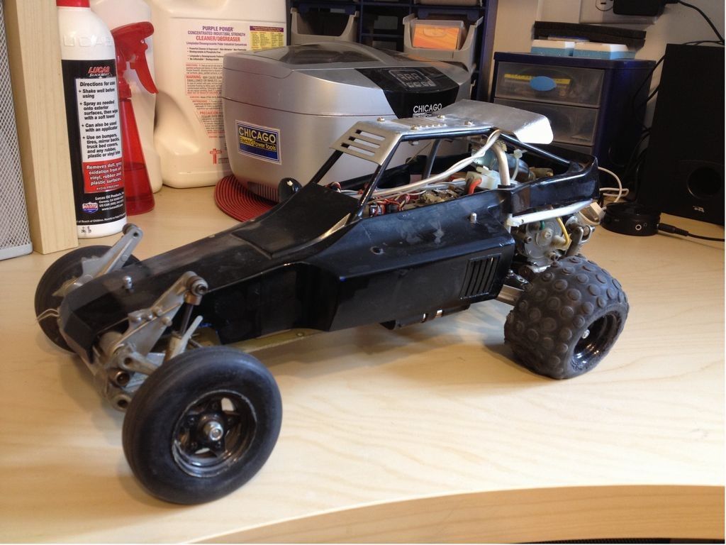

This is what I started with...paid $25!!

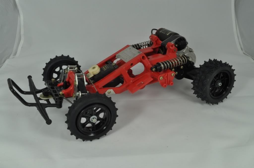

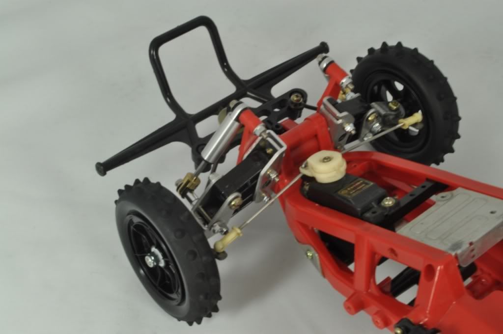

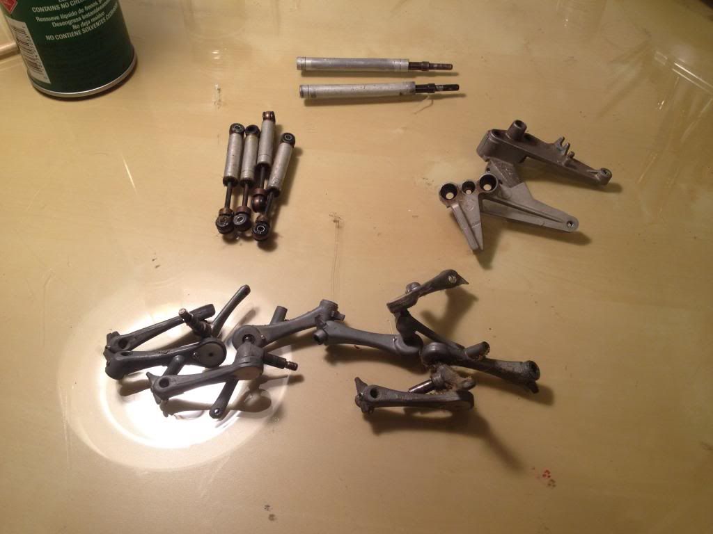

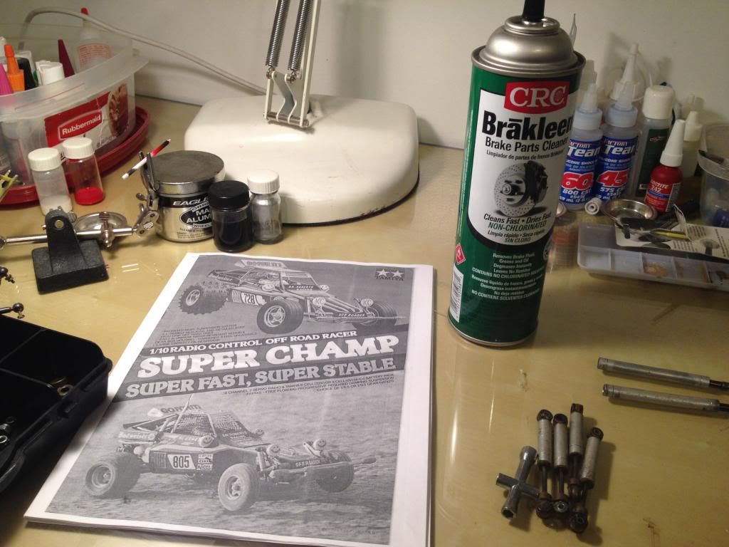

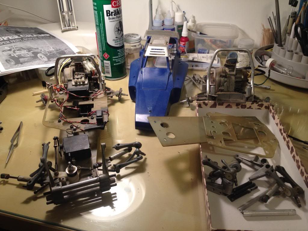

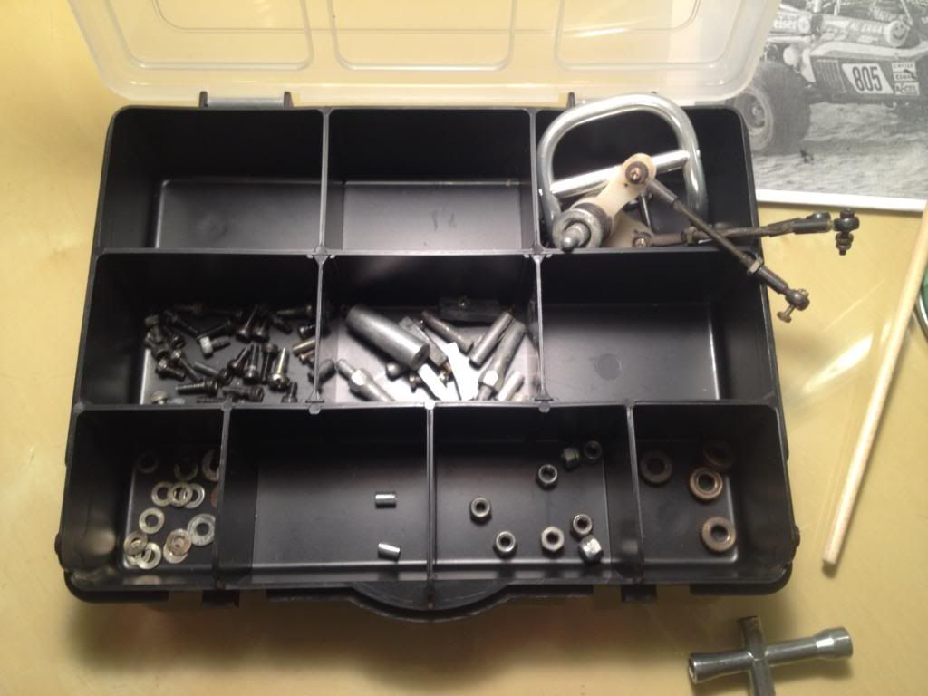

I am in between jobs and have a few days all to myself...what better way to pass the time than work on a restoration? Thought I might try and document the process. I have two mostly complete Super Champs that I will be taking apart and plan on building one with all the best parts for the shelf and the other I might put up for sale. We will see! Starting with the front suspension first. I like to use a multi-compartment plastic box to contain all the screws/nuts/washers/small bits as I take the model apart. I find that brake cleaner works great for cleaning metal parts. The second body is presently soaking in "Purple Power" degreaser to remove the old paint.

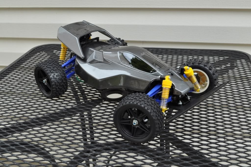

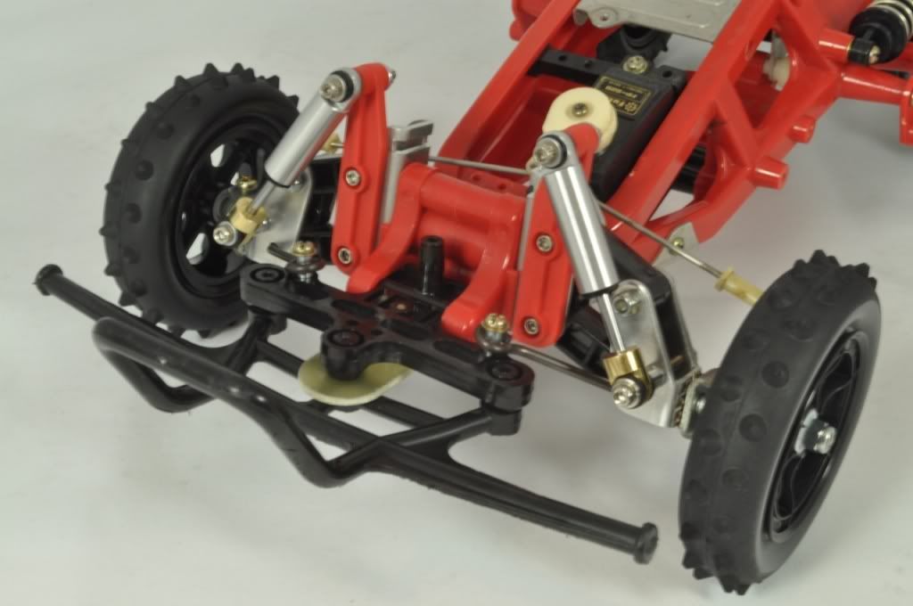

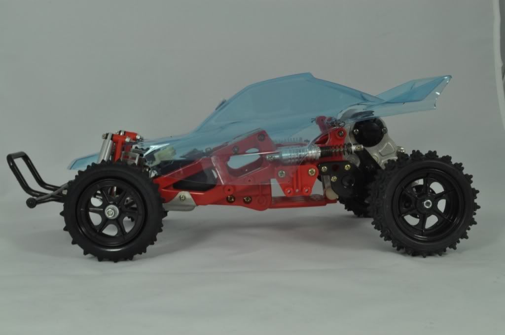

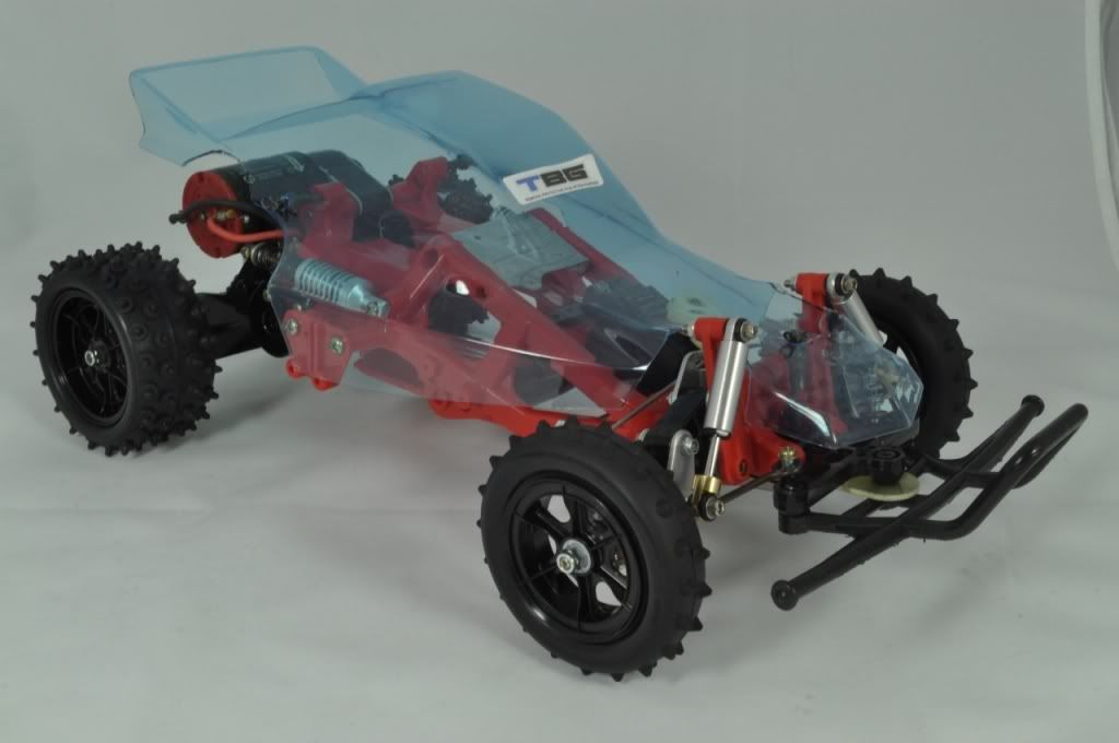

Thanks Grastens! Well, the project took another turn tonight. I fitted a ***** Panda Cyclone body instead of the Fire Dragon body. I am very happy with the results!!

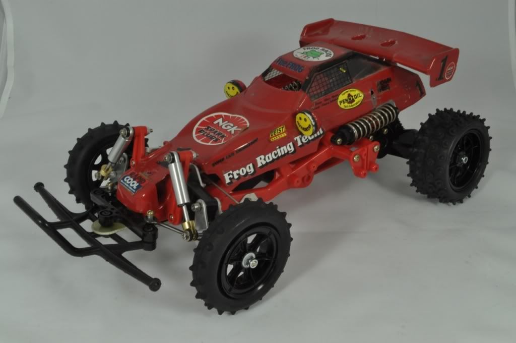

Here it is with a ratty old frog body...

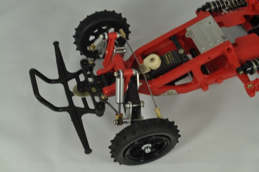

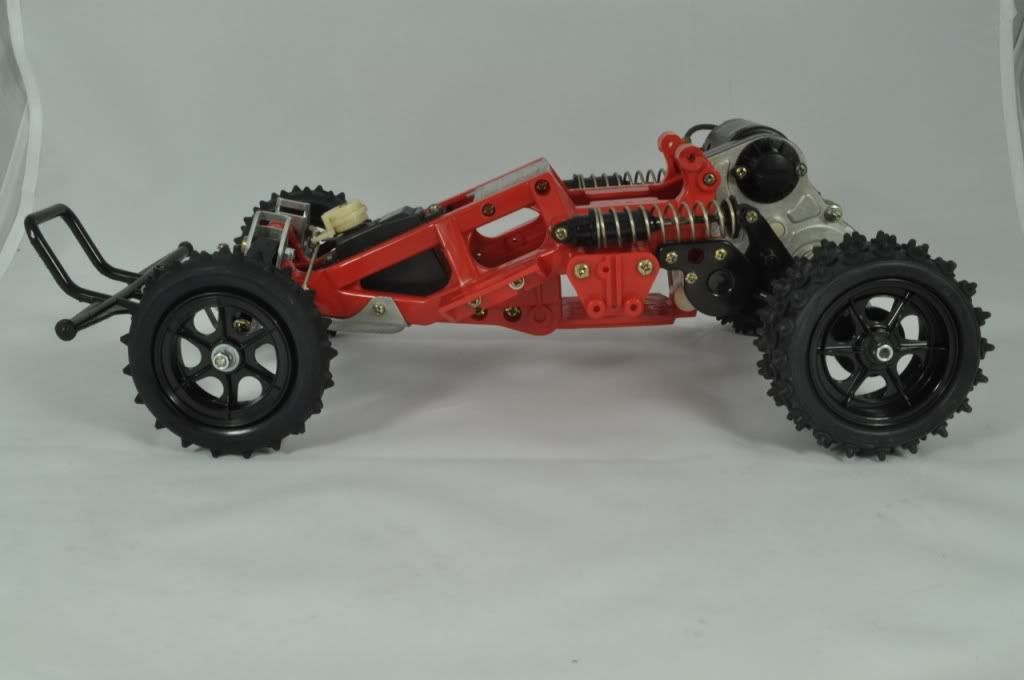

I am going to try and document a build using only parts I presently own. I started with an original Frog that I received with my Bigwig a while ago. Next, I swapped the chassis for a spare Blackfoot chassis, old Sprint motor, and Astute wheels w/NOS tires. Then I added re-re SRB front dampers installed on CRP mounts with misc. hardware. So far so good! I will clean/polish some old Frog dampers for the rear and most likely use a Fire Dragon body leftover from my FD to Terra Scorcher conversion.

I use automotive brake cleaner on metal parts. I use a plastic container and spray the parts then use an old paintbrush with shortened bristles (to make them stiffer) to scrub as needed. Remove parts and let air dry. Works great! For plastic parts I use an ultra-sonic cleaner (available at Harbor Freight) along with some Purple Power degreaser. Five minutes later they are sparkling clean!

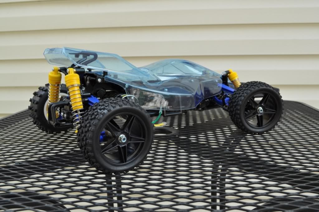

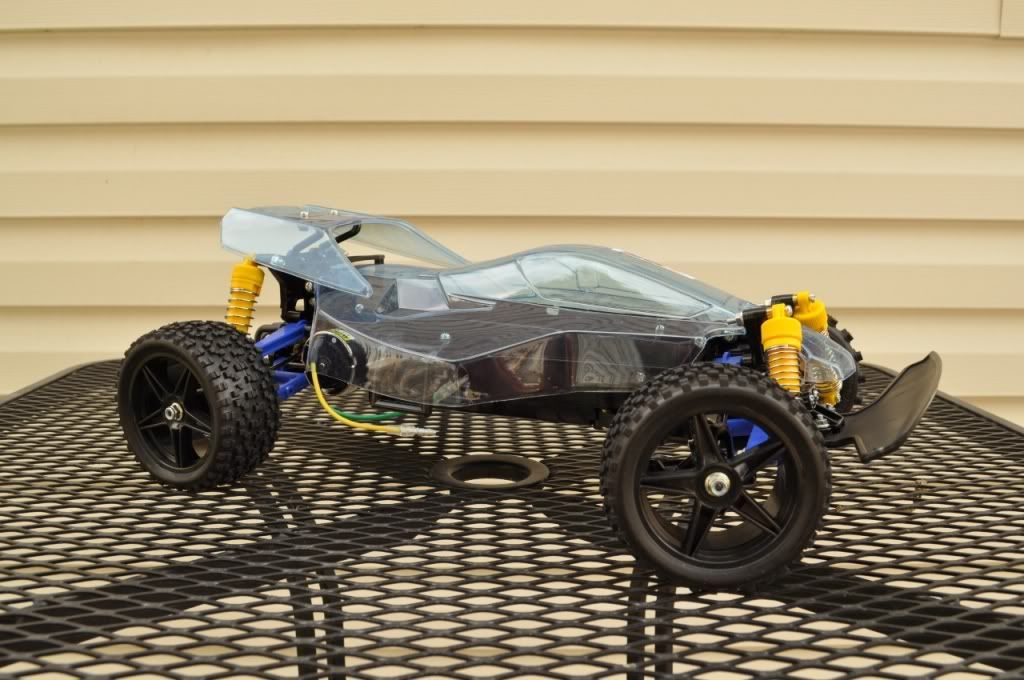

<p>I've been a member for a while but seemed to stick to the main site mostly. I have never posted a build but I figured better late than never! I picked up a NIB Fire Dragon with the intent to transform it into the sweet-looking Terra Scorcher. The chassis is done and I'm about to paint the body. I'm going with Tamiya Gunmetal and I think it will look nice with some original Terra Scorcher decals. I have a couple sets of wheels/tires that I'm deciding on now. One set is from You-G and the other I picked up off ebay from a supplier in Hong Kong. I'm leaning towards the black ones but the period hop-up You-gs have a certain appeal as well!
