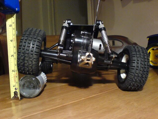

If you're interested these parts were left over from a Lunchbox restoration some years ago and I've been toying with putting a Pajero together since I found out about it . Quick mock up with some spare shocks to show you the chassis layout.
It wouldnt take a lot to get one running. The Lunchbox tub is slightly different from the original Pajero, mainly where the front shocks mount but it does allow you to fit modern dampers. You could also upgrade the rear end to use the Hornet style rear suspension, that should help with the handling a little.
Im still tempted with the short wheelbase + big wheels combo though, maybe topped with a Mini Cooper body shell?
I took my LB apart and hung the suspension arms there myself to see what it'd look like. I also had thoughts of using the lower CG to help the roll problem, but it looked like the tires would pretty frequently bind on the chassis. So I wasn't sure what to do about that, short of, well, making longer arms. (And then it's a real big project.
)I like those spiky LB tires.
What's the advantage of the hornet gearbox? Just the slight roll allowed by the funky wire spring arrangement?

Yeah, the Mitsubishi Pajero used the same chassis, with shorter dampers and without the 'riser' parts of the LB, that's why there's a 'hump pack' shaped tray behind the rear shock mounts too.
Ah hah! I hadn't even put the rear shock tower tray space together in my head yet, just saw the front control arm mounts. Excellent. Thanks!

Well, I'll be darned.
I haven't actually run mine yet, and hadn't realised what level of articulation one got out of that setup. Impressive. Ok, I stand (well, sit.) corrected.
Keep us informed how your low CG short wheelbase monster beetle goes.
