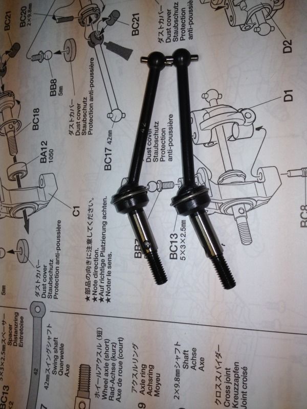

and now your drive shaft is barely in the diff output
I think you are right, better a street car than rally
Cool mods, Wouldn't it be easier to have just changed the ball studs on the steering knuckle to be at the top? Remember Rally should not be really high, its for gravel and packed dirt. 20mm is fine. My TB01 runs fine at 17mm for rallying.
Actually, the drive shafts are ok. They don't bind at full droop.

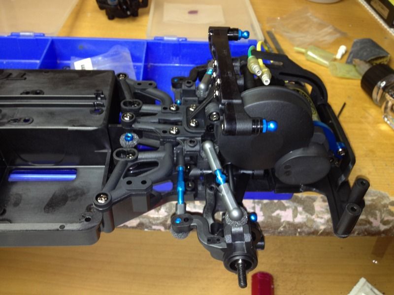

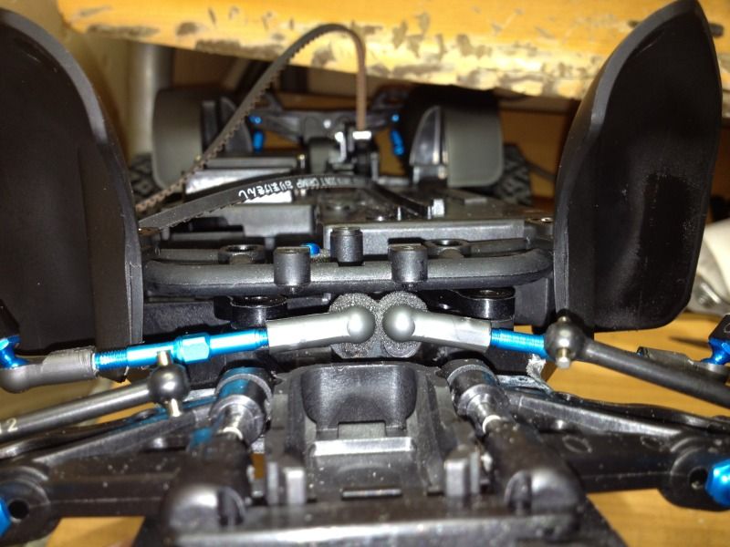

See where the rod end touches the suspension mount?
That needs to be filed down a lot, but you can't file it down enough because of
the screw. Cutting 5mm or so of the rod end helps too...(marked in green
That all give a bit more down travel, but as soon as you turn the wheels, the rod ends, hits that suspension mount...

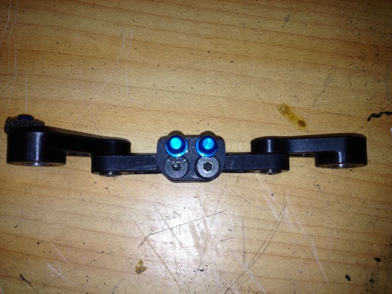

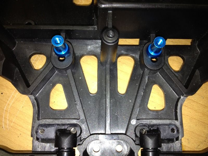

See the ackerman plate with the two blue balls?
They need to be raised 5mm or so in order to get a bit more clearance..
I made a plate out of some scrap plastic, drilled some holes and screwed the plate on.
The result is this:
Now, except for full steering lock, the rod ends clears the suspension mounts...barely.
Now because of the piece of plastic I put on, the rod ends now touches the front gearbox, so in order to correct that, I moved the blue steering posts to the rear position.

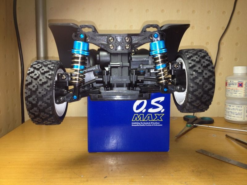

The result of all this is a ride height that is still around 20mm, but now with around 8mm of down travel
This is a before and after pic of the rear, but the front is nearly the same
The rear didn't require and modification except a longer shock rod end.

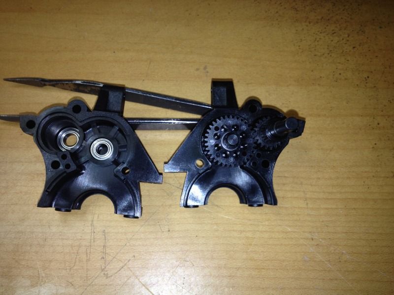

After the front gearbox assembly, I started on the rear one and again no problems were found, but just as the front gearbox, I did use some shims to eliminate some play.
The belt tension unit is composed of two bearings, sandwiched between 3 thin washers, ensuring that the bearings can rotate freely.
Very neat little detail
Removing the diff is basically a matter of removing four screws, making maintenance a breeze...for the front you have to remove eight screws.

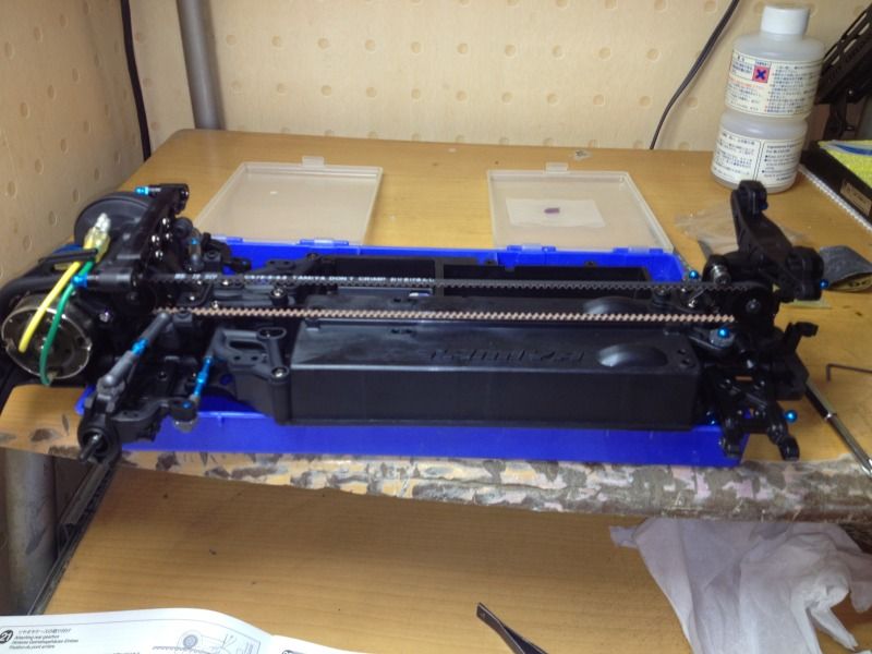

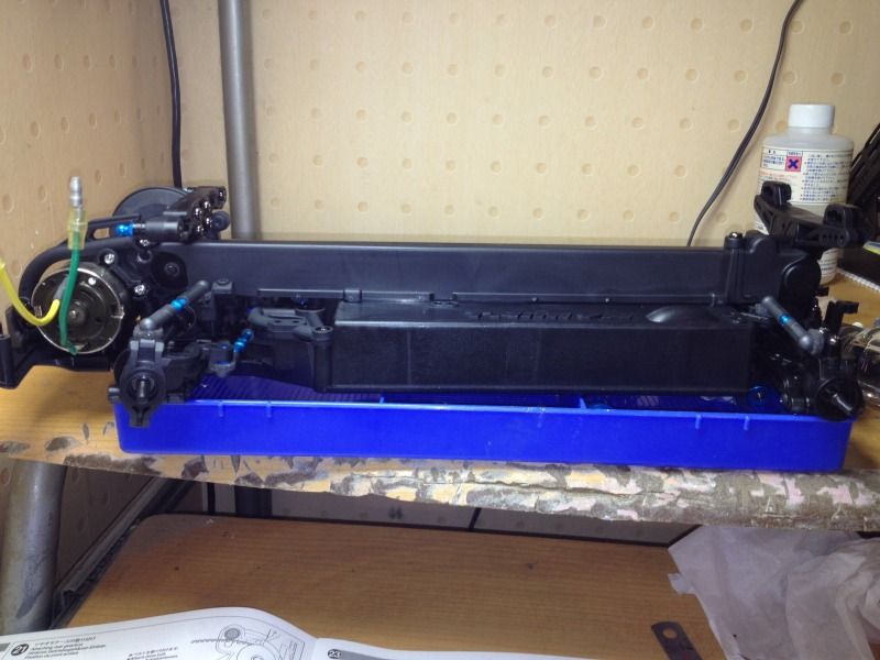

After installing the rear a-arms, the rear gearbox and the drive belt, we have a something that looks like a car
With the belt cover...
While it does a good job at covering the belt, the belt is not totally inclosed.
The front pulley is not covered 100 percent and the belt cover is open on the underside, from the front pulley to the beginning of the battery compartment.
Is it a problem?..hmm not sure...dust might find its way in, but pebbles and so on?..I don't think so.

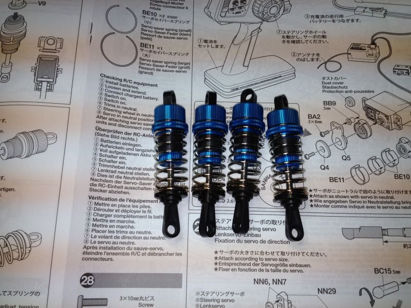

The chassis pretty much done, let's do the shocks!
The shocks are Tamiya's TRF units and when assembled they are butter smooth!
I filled the shocks with the incl. oil, Tamiya's #900.
The springs are softer than on-road springs, but still too hard in my opinion.
The oil/spring combo, doesn't quite work...too springy for my taste...
But, that is something I'll play around with.
The manual tells you to use the short rod end, but I thought I would be clever and use the longer one, so I could get more droop...turns out that might not have been the best of ideas...

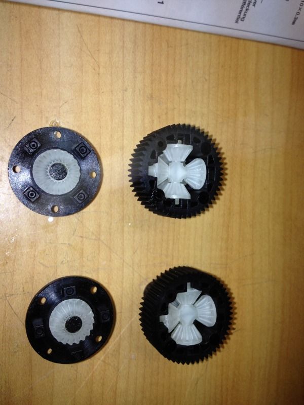

The diffs are the same as Tamiya's Ta-06 and they go together without any problems.
I lightly sanded the plastic gears to make sure they were flat.
I lubed the o-rings and gaskets with green slime and installed the gears.
I filled the diffs up with the supplied oil (Tamiya's clear hard type) and screwed them together.
When you do that, take care that you don't strip the screws...
Assembled diffs

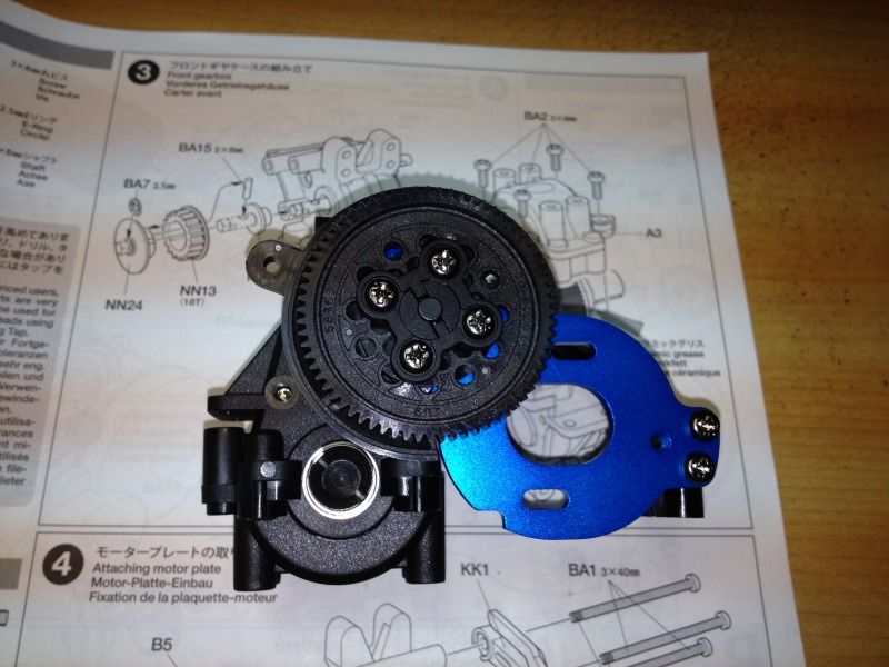

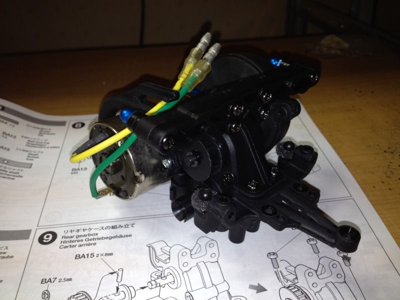

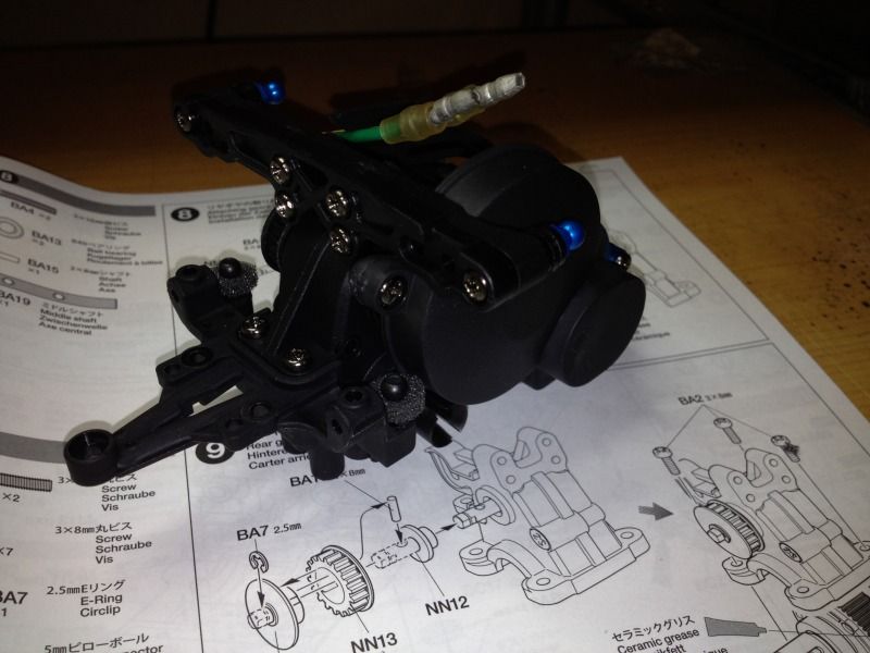

After the diffs, it's time for the front gearbox.
The gearbox itself is very compact and thankfully there are no alu. gears in sight!
No problems putting the gearbox together, but I chose to use some shims to tighten things up a bit.
There is one thing to be aware of...You have two different lengths of "drive pins" 2x8mm and 2x9mm.
Make sure you use the 2x8mm for the spur gear otherwise you are going to use some foul language..

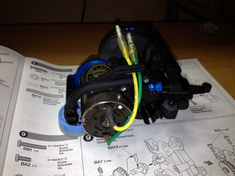

Here's the gearbox without the motor
And here with the motor installed and yes, I did go with a humble 540
Haven't really made up my mind as to what motor I should get...

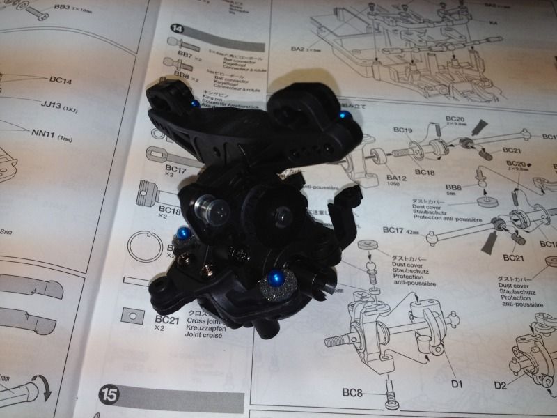

With the motor installed, It was time for the shock towers.
Again no problems were encountered, but the screws that hold the blue balls in place are 18mm long and to me they do seem a bit on the short side...if they were around 22mm they would hold the balls more securely...
A nice touch are the foam dust covers.
Here is the complete front gearbox.

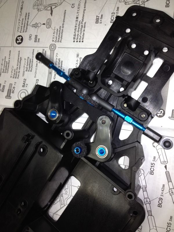

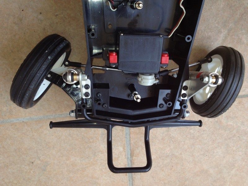

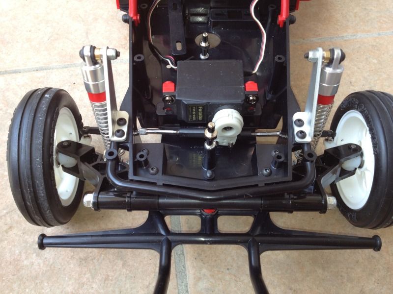

Here's some pictures of my front end...
As you can see, I did change the kits steering linkage for some lundsford titanium turnbuckles.
In order for the rod ends to clear the servo, I had to use the other included servo horn.
As for them "locking up" the shocks, I only get that problem if I dial too much steering in...
Can you show your front end ? Mine is al bound up on the right shock no matter what I do !
