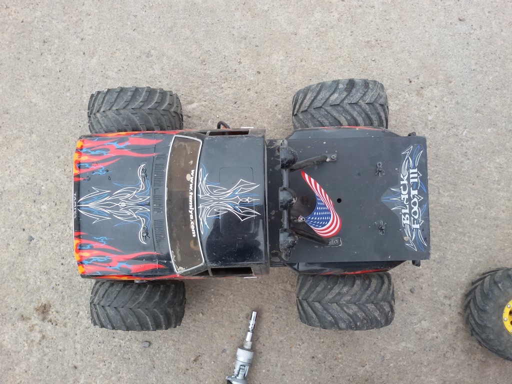

Second test run. I've changed the springs and the truck runs more stable. That's good.
But my Bigfoot fells on the roof and the flagpole gone broken. Also got some scratches.

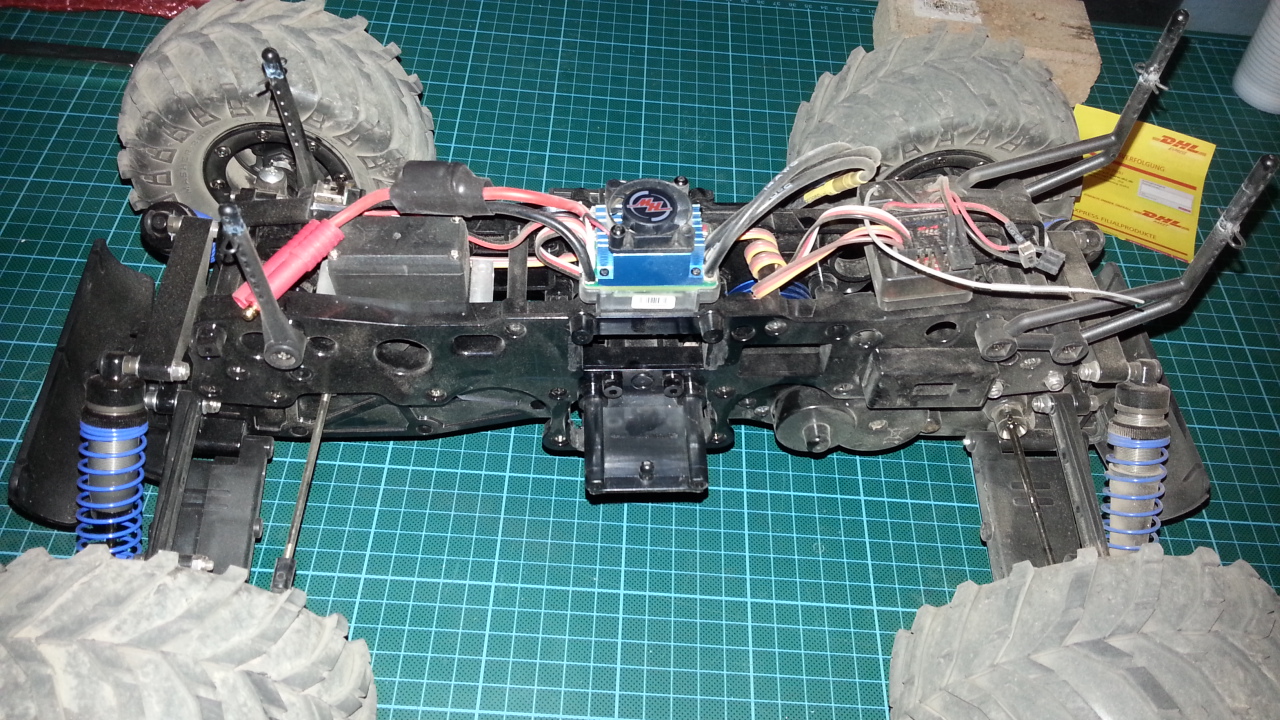

So let's look on the chassis.

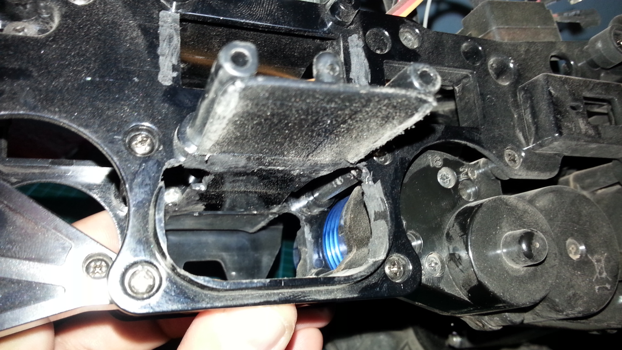

I only us the parts which I really need, so I cutted some parts. The truck lose a bit weight.
The EZrun 9T combo is a very good and fast machine! Evil, on flat (clean) asphalt it drives like a rocket.
1a acceleration!
The hole for nimh battery I've extended a lot. So the lipo fits perfect.
See you later!

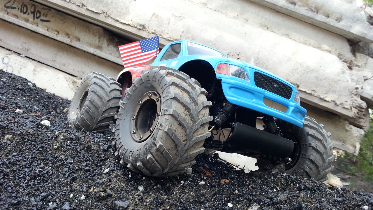

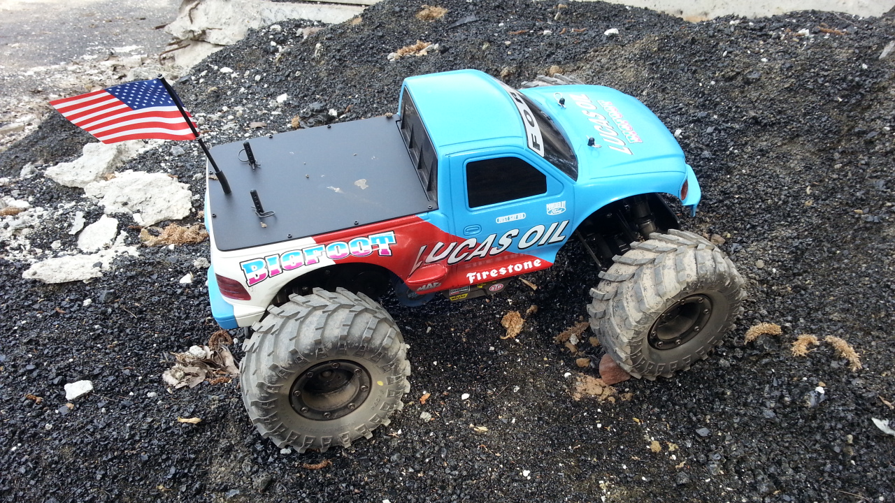

Good news! Some days before I've made the first test run. Yes, it drives! :>
The Ezrun is my first brushless kit and I must say it's not easy to steer this machine. It's fast but bit too fast! I can't drive at full speed, to big stones on my way and not enough place at my gravel pit.
I must improve some settings, it's not perfect. I test it next time again.
Here some pictures:
1

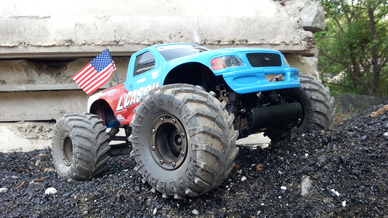

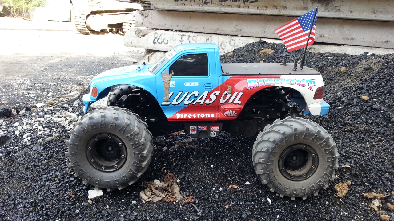

My WR-01 (Carbon) Bigfoot Monster Truck (formerly Wild Dagger) Update 2017 on Page 2
in The Builds
Sry guys for the long break. I've forgotten my thread and don't drive so much with the truck.... till this year.
Now I love the truck. I've changed a lot of details, so it drives much better than in "prototype" phase.
Changes:
- new Parma Bigfoot body shell, lower 10-15mm
- 20T steel pinion
- harded Tamiya diff
- locked diff
- rear harder springs
- HPI Mud Thraser tires
The 4300kv 9T motor works fast. Will be warm but not hot. Drives fast for this classic chassis, I think.

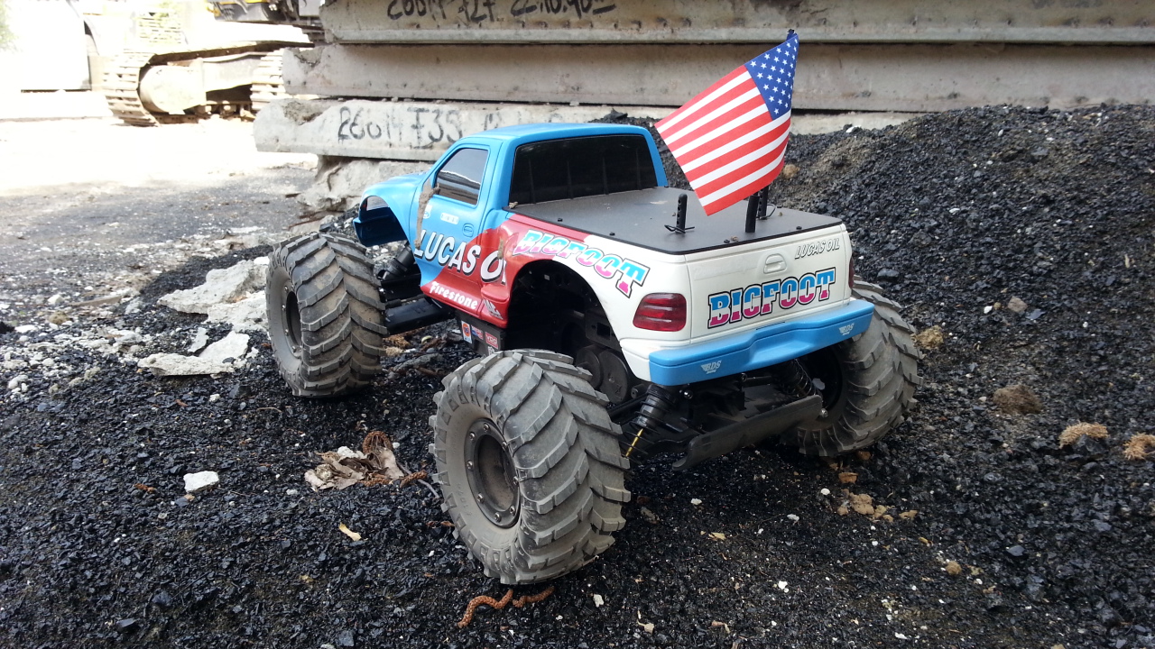

Feedback:
- I never buy Parma bodies and bodies with .3 thickness. After one crash it brokes on another point. I need duck tape on every site. It's not recommended for a monster truck. Too thin.
- the harded diffs are not much better than stock. Next time I want to use GPM steel diffs.
- all in all no fractions, chassis still stabil and no damages.
- HPI mud thrashers glue on blacktop/tarmac very good. But they don't like lose underground and littles. They made burnouts (on 2WD).
- locked diff is an improvement. the truck do not oversteer so much, less 50%. Without locked diff, the truck drives in a circle on start, especially on lose underground.
