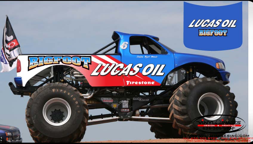

Last 2 weeks I painted the body. Thats the worst paint job I ever made. Terrible!
The truck should looks like a replicant of Bigfoot #17 from Monster Jam.
I get this nice F150 toy truck, which is highly detailed and change it to a real Bigfoot body.
So it starts with a wrong choice of color. I want a dark blue color, but I get a baby blue!
Who the 5&3&(%43 uses such stupid caps???
Next desaster: I bought cheap white paint but I don't know at this moment that is incompatible with my normal paint producer.
I have painted one layer and next day the second one. The result was nearly perfect! The paint gets wrinkles over and over. I must repair it with sandpaper.
The cool two white flash stripes also gone damaged.
In some days I need to repair the breakage by using a very small brush.
NEVER buy cheap paint, guys!

So guys, I am finally ready!
I finished the body, repaired the color and set up decals. I must say, I love the body! It looks very similar to the real Bigfoot #17:
And this is the final Look of the WT-01 truck:
I really like it, I think I have done a good job.
