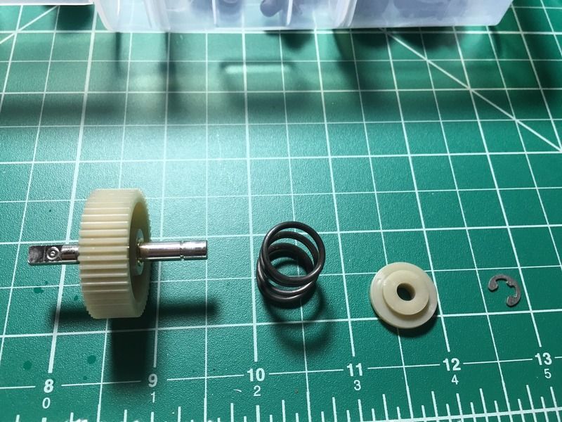

Thanks for the confirmation. I checked the clip and its tight. This one is probably not going to be run again. Just going to set on the shelf for now. So I just wanted to make sure before re-assembling.
Hello everyone, havent been on in a few years(several computers and lost logins ago). Anyways finally got back on and am in the process of restoring my old Wild Willy M38. Does anyone have any pics or can tell me if I have re-assembled the clutch gear properly? Its on page 8 step 17 in the manual and its a pre-assembled unit. But some how it looks to have been disassembled. The pic in the manual only shows a partial angle and I cant see if how its assembled completely.
These are the pieces I assume are it
And this is how I figure it should go back together. Can anyone confirm before I complete the gearbox?
Found this page- look at second post. Hope that fixes it.
As I remember reading that the instructions had a piece flipped the wrong way in the illustrations. I will try to find the info. Also check out rc10talk.com. That's where I remember reading it.
