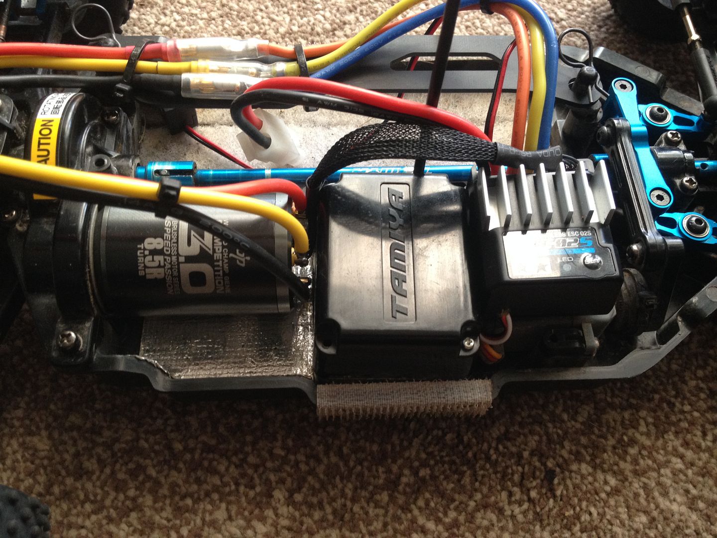

so after sorting fitting the brushless 8.5T and the TT02B going backwards fast and forwards slow (flipping the diffs but i'm sure there MUST be a way using the ESC and transmitter) i've spent 20mins running it and the tamiya ESC held up well (c50degC according to the laser thermometer) with the motor running at only about 35degC and the tamiya battery connector just being a little warm.
so all good (for now)

1
tweaked the brushless
tidied wiring
fitted yeah racing steering upgrade

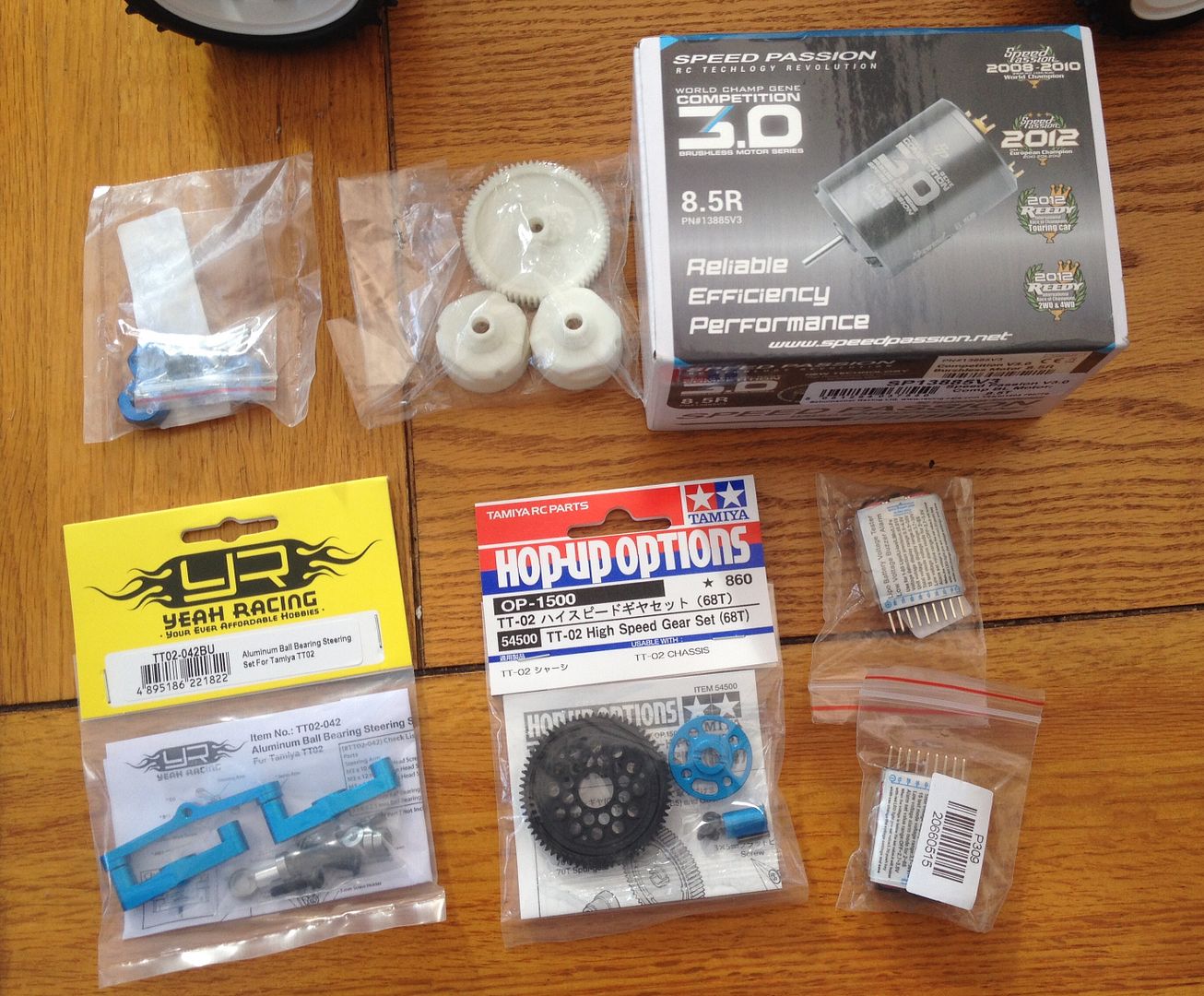

some bits for my brushless TT02B build
JJ
2
so, what we are doing with this mod is replacing the 4 plastic cog diff of the TT02 with the 3 steel cog diff of the DF02
Because the tougher diff is a 3 piece the diff casing is needed and this is the diff cup PLUS the large bevelled gear that screws onto the back of the cup from pack A (you WONT need the large white spur gear as yoou can keep your TT02 one
parts bag A (mine ordered this week from here awaiting stock) http://www.modelsport.co.uk/tamiya-parts-bag-a-df-02/rc-car-products/26642
with the diff casing make sure you get the set and not just the spur gear (i got mine off ebay this week http://www.ebay.co.uk/itm/Tamiya-0555104-DF02-Diff-Gear-Case-Gravel-Hound-Plasma-Edge-Aero-Avante-New-/182268919474?hash=item2a7012feb2:g:t-8AAOSwv0tVO5n1) <<<< i think sellers have cottoned onto this and are splitting the set and making double
