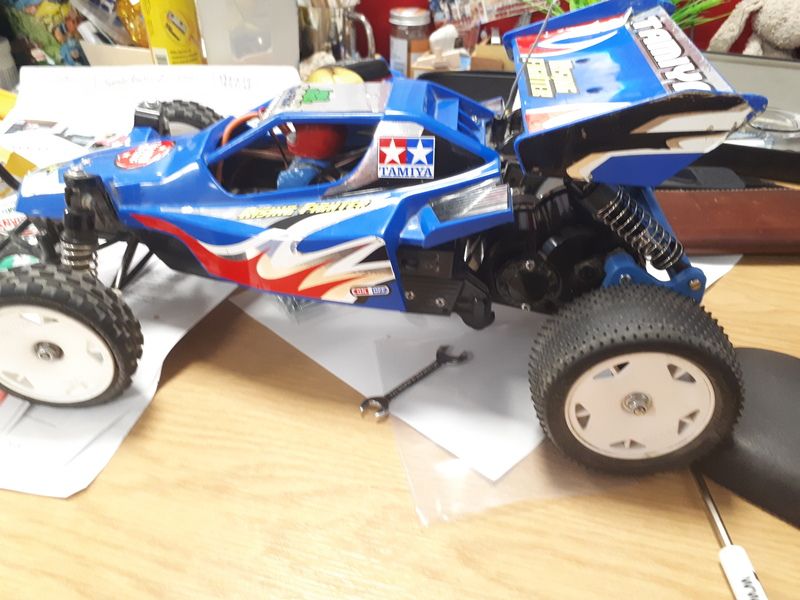

I have fitted a set to my son's Rising Fighter and have found it to be a bit, well, a bit of a hassle.
I wanted to cure the whole pogo thing, so thought a new set of shocks would be the cure. Now I'm not after perfection, as I fully understand the limitations of the chassis design but just wanted an improvement. After buying the shocks and fitting them it just made the situation worse, so I investigated further.
As a result I fitted the modifications shown in my other thread. In addition I refitted the springs from the original shock units as they are a lower rate. I've yet to run the new set up but I think this is as good as it is going to get.

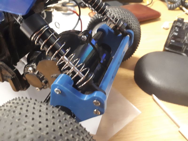

I have yet to run it so cannot comment fully. I have made it as strong as possible from a design point of view, and don't foresee any issues, and could always tweak them out in any future designs.
Because I make them at work, costing me nothing, I would not want to sell them. However I would be happy to make the odd set up and pass them on as a favour. As far as I'm concerned that's what it is all about.

It came up a little rough, but this was a prototype so I wasn't going to waste time if it wasn't any good.
Not tested it yet, but printing a thicker cross brace as we speak because I think this one will break around the suspension mounts. I split it putting the screw in, so tapped it out and put a mc screw in instead.
I'll swap it out on Monday, it's got another 3 hours printing and I'm off in a minute!

After ruining the suspension on my sons Rising Fighter I researched the modifications possible and copied what I saw as being the best.
It was a first for me as I drew up the parts in Inventor, a 3D modelling software programme we have at work and then 3D printed these parts off.
Technology is moving on and I needed to catch up. I can draw up anything by hand and machine it in the toolroom but was losing pace on the new technology available.
I did feel a bit guilty about stealing Ampro's design but at £25 a go I figured I'd try it myself.

Well we took my son's rising fighter out on Saturday.
I'd fitted the Sports motor and the new shocks and all it did was pogo to the point that it spent more time on its roof.
Not too happy, it means a whole lot more fiddling before it works well.
Thinking of changing the shock oil and drilling the piston holes out so the suspension works.
If that doesn't work I don't know what to do!
